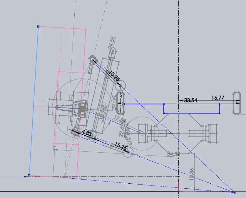

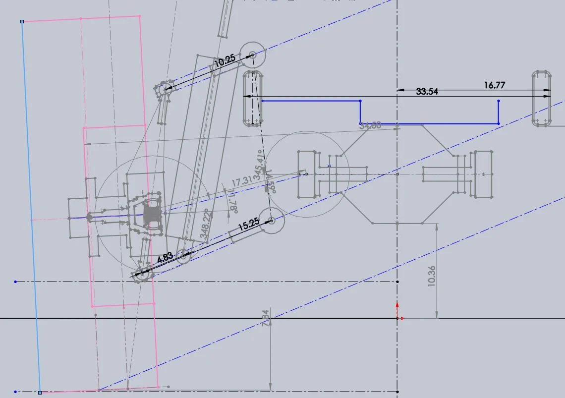

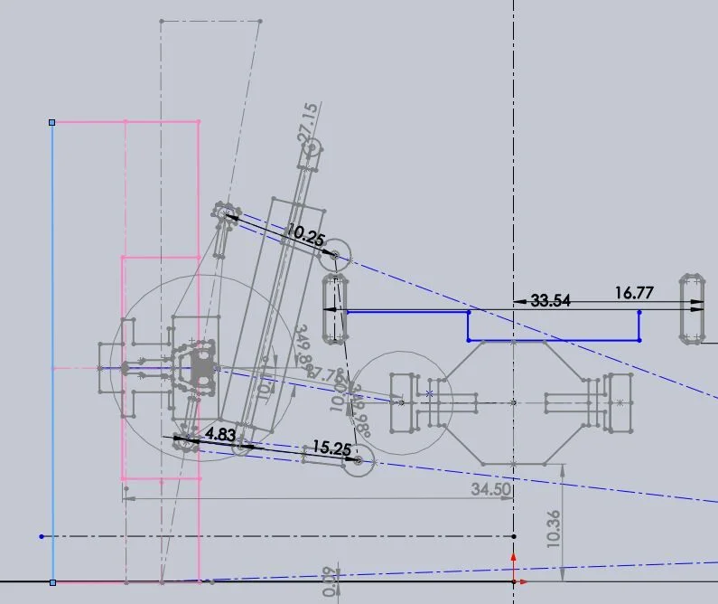

Then I needed to learn up on SolidWorks Blocks to model the motion of the IFS around some design constraints. Assuming my frame width and desired height, existing wheels and tires, and maximium up travel of 100mm, I selected some components.
RCV CV's come with their own constraints. 1.5" plunge (the amount the length of the half shaft can change throughout it's travel, and the maximum operating angles.
I went through 10 iterations of the design, and landed on one that fits all the constraints...

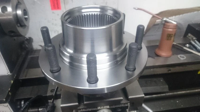

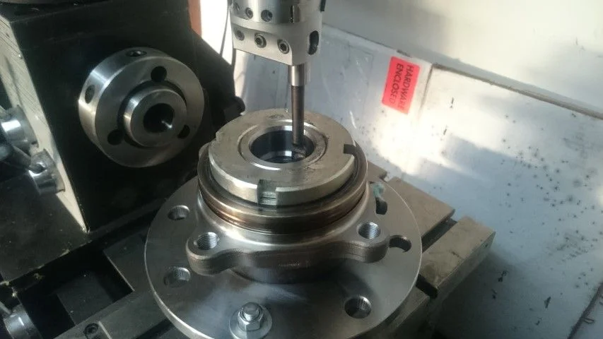

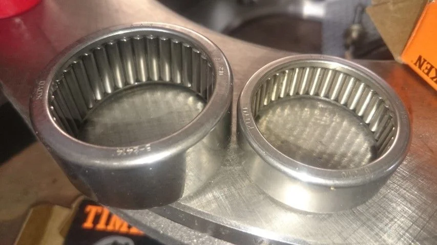

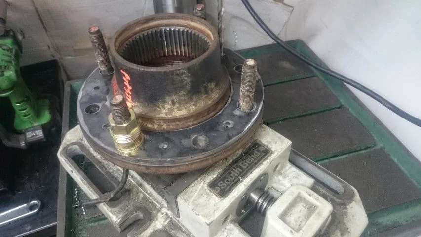

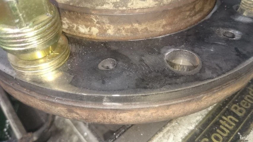

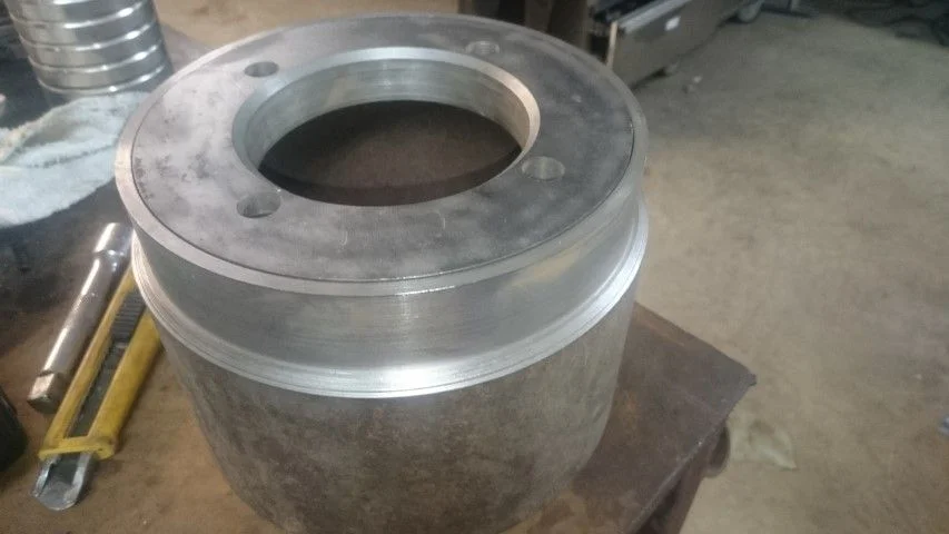

After looking at what's available on the market, and what the racers are doing, I decided on using 99-04' Ford Unit bearings, modified or the bigger 35 spline axle shafts, and re-drilled for my 8 on 6.5 wheels. For rotors, I would use 2010+ RAM 3500 front rotors, and 2003 F450 front calipers.
center of the unit bearing needs to be bored to fit the larger shaft, and the bearing needs to be bored for the larger Timkin 2414 bearing for the larger shaft. I tested the operations on a junk-yard unit bearing, before machining my for-realizes brand new Timkin unit bearings.
Yes, I know that you can just buy these professionally modified by Branik Motorosports, or even buy full race prepped one from Spidertrax, but doing this myself with my new Mill actually paid for about half the mill in this one operation.

The ID of the Dodge Rotor is too small to fit over the center hub of the unit bearing. Use the mill to make bigger the center of the Dodge Rotor.
I had a jig lasered out to re-drill the unit bearings to the 8 on 6.5 patter to match my wheels. (I thought about buying new Metric wheels and using the Ford pattern, unmodified unit bearings and rotors, but the CAD$ has dropped 20% since last year, and new wheels are substantially more expensive now. :( )

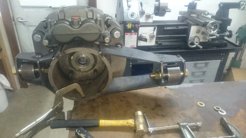

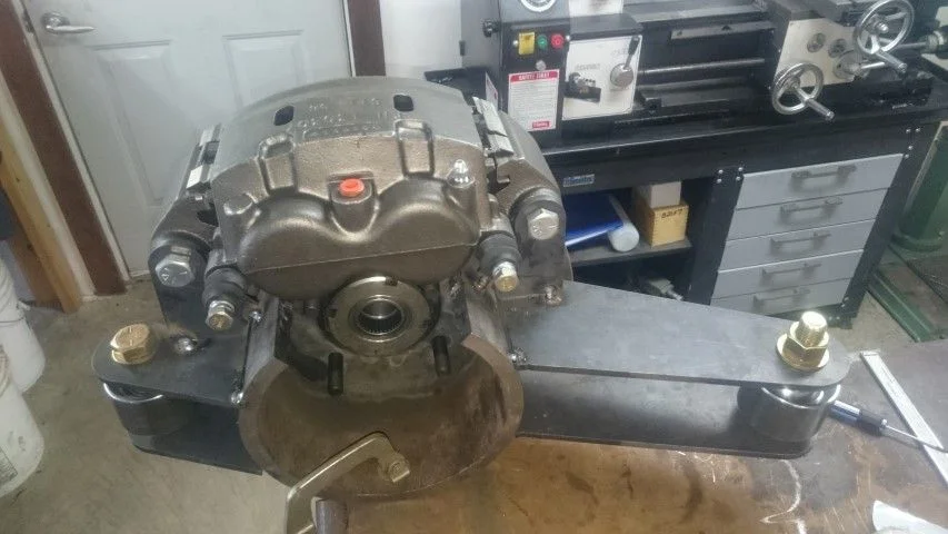

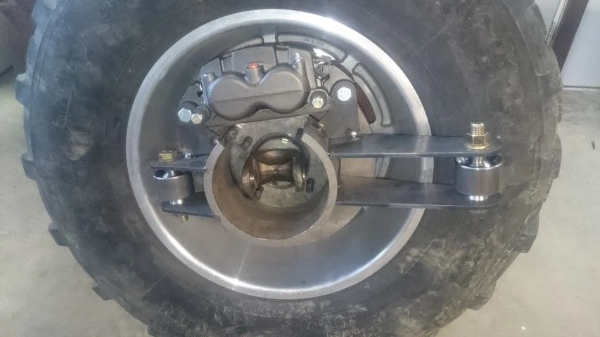

Then it was on to the knuckle. I decided on using a piece of 6" long Schedfule 80 Pipe as the central part of the knuckle. I had a piece of 1" thick steel water jet cut (the laser only goes to 7/8" I am told) to bolt the unit bearing to, machined the center to perfectly match the unit bearing.

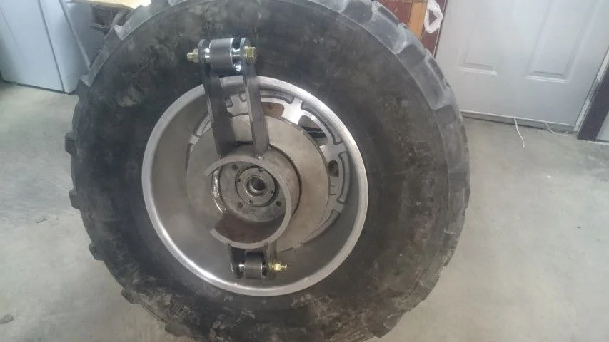

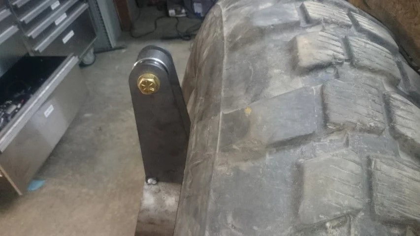

Decided on using TMR uniballs for the upper and lower mounts. In Prototype #1, I decided to go with the mounts in a Horizontal configuration. They only have 31 degrees for misalignment. This seems like enough steering, as every Land Cruiser I measured has only about 28 degrees maximum. Although, with my wide stance and narrow frame, I think I can steer about 35 degrees... maybe....
With those parts in hand, I did some more Solid Works designs, and got parts for a Knuckle Prototype #1 created. Tacked it together, and did a test fit-up with Rotor, Calliper and Wheel.

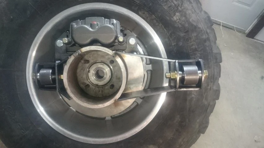

Found lots of room for improvement in Prototype 1. Decided on a Prototype 2...
Go to Vertical uniballs to maximize steering angles.
Replace most of the caliper cut-out.
Re-align upper a lower mounts to improve steering pivot point.
Refined designs with some bends...
Prototype 2....

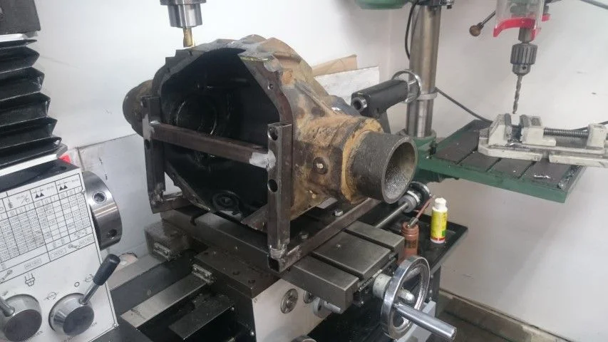

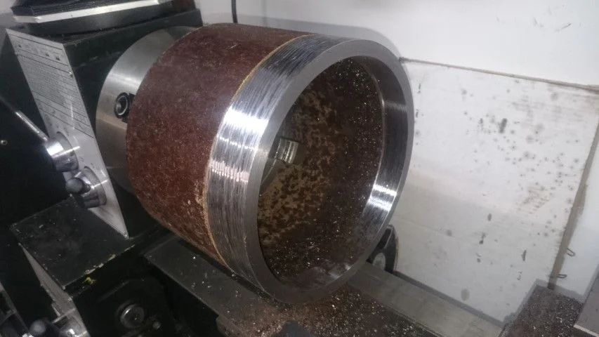

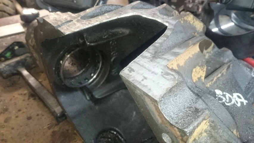

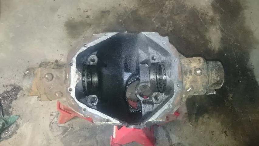

I have also started working on the IFS differential.

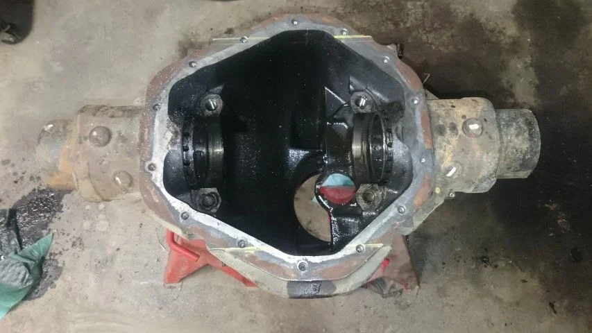

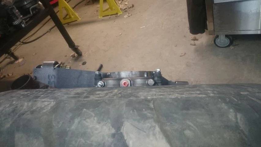

I considered numerous options... everything from the many factory IFS diffs, to some of the Ford 9" based aftermarket items, like the Currie F9 that the KOH racers seem to like. I also found some inspiration on home-made IFS diffs. But I've never seen a IFS diff made from a 14 Bolt center section. I know from the shave I've completed on the previous housing, that the ring gear can be turned down to ~10" and the diff can be very slim... I bet if I double shaved a 14 bolt center section... both top AND bottom, I could get it very close to the bottom of the engine, and still have pretty decent ground clearance... so I tried it... Ground clearance appears to be at about ~255mm. About what a Cruiser axle would have on ~35" tires. Not a bad compromise, considering that this truck will sit at about the same height, but have 40.5" tires!
A Cruiser axle clearance won't change much with suspension loading though. Your independent design will get lower on downhill sections and on landings. How much clearance will you have when on the bump stops? Will it be enough?
For what it is worth, I have dropped in and looked over this project in-person, regularly since it began and I think it is just crazy enough to work. Every component looks to be stronger than stock or even upgraded stock designs and if this thing is able to go faster, stop better, ride better, be more economical, haul more, turn sharper and break less than a stocker while on 41" tires it is going to be all kinds of fun. All it needs is a mad scientist with a hitch mounted mill to keep it going anywhere in the world.
Variable ground clearance is certainly one of the compromises of an independant suspension. On paper, I should still have 155mm of diff to ground clearance when fully bottomed out. Is that enough? Yes.
