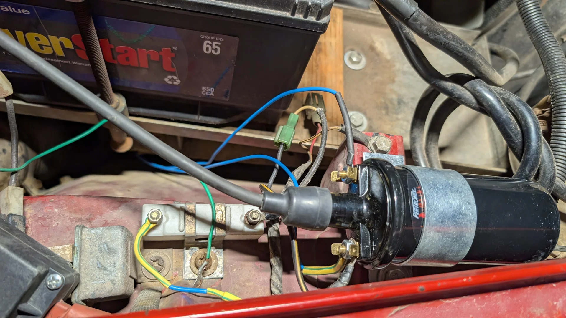

I am hoping to see if someone can point me in the right direction and help me troubleshoot some problems I am having with my 77 daily driver. I changed over to Pertronix electronic ignition about 4 months ago and ditched the points in the distributor I also installed a flamethrower coil 1.5 ohms. Last Weekend while driving to a trail head and taking a rather good bump the coil died. It was completely dead and I had to use the original coil to get me back home.
When using the original coil the cruiser was running bad I had to keep it at lower RPM otherwise very rough and seemingly missing but I got home.
I since read up on the Pertronix coils and bought a Pertronix 3ohms epoxy filled coil being recommended on another thread and I believe the pertronix coil I was using is oiled filled which could be why it failed.
The problem I am having is after installing the new 3ohms flamethrower coil the Cruiser is running the same with the original coil. I also am wondering if I have the coil wired properly or if I did something wrong and caused the premature failure
See the underlined info.

Just bypass the resistor by steeling the power from the one side of it. 12v end. Where is the igniter wired to usually to the coil I’ve had band luck with the flamethrower epoxy coils. It should run fine with your old coil also. Have you checked the timing. Maybe dizzy moved.

I will check timing, It is very odd how poorly it is running when it was running perfectly. I hit a pot holes and instantly died. I narrowed it down to the the coil but now it is basically not drivable. I haven't had a chance due to weather to try and troubleshoot. I have heard that the ground strap in the dizzy can break causing problems.

Ditch the ballast resistor. I run a Pertronix kit with the stock Toyota internally resisted coil. Works great.

I concur. Running the same, basically.
I discovered that my voltage regulator is not functioning properly I am getting between 11v and 14v at the coil. What is the current recommendation should I replace the voltage regulator or should I get a new alternator?

Your alternator might have an internal regulator - so replace it and learn how to fix/adjust the one you have.
Clean the pivot bolt and locking bolt. Same for the bracket mount - to make sure you have a good ground. Make sure your engine has a good ground too. Then clean the terminals and wires on the alternator itself. See if that fixes it.
I think I mis-spoke, I have a OEM alternator and the voltage regulator is external here is a picture. The problem I am facing is even with the new coil it is continuing to run poorly and seems to be loading up (like it is not getting proper spark with higher RPM). I tested the input to the coil and it is reacting to the RPM of the motor so I was thinking the external regulator is not functioning properly. I also noticed that as I changed out the coil from original my dash lights do not work?
That cover will come off so you can inspect/adjust the unit. The manual has the procedure/specs. Pull the plug apart, clean the contacts in both sides. Qtip a little dielectric grease on the surfaces.

I think I mis-spoke, I have a OEM alternator and the voltage regulator is external here is a picture. The problem I am facing is even with the new coil it is continuing to run poorly and seems to be loading up (like it is not getting proper spark with higher RPM). I tested the input to the coil and it is reacting to the RPM of the motor so I was thinking the external regulator is not functioning properly. I also noticed that as I changed out the coil from original my dash lights do not work? View attachment 4208914
I was able to find a compatible VR at a chain auto store that got me by until I found an OE one. Got that one from Matt at vintageTEQ parts but I’m sure they are out there as ordering stuff from Matt can be a bit of an… adventure?
A (very) fast Google shows that Cruiser Teq and City Racer both offer them.
Really appreciate the pointer I didn't consider trying to track one down. I was thinking the recommendations would be to switch over to a more modern alternator. I ordered one from City Racer.
