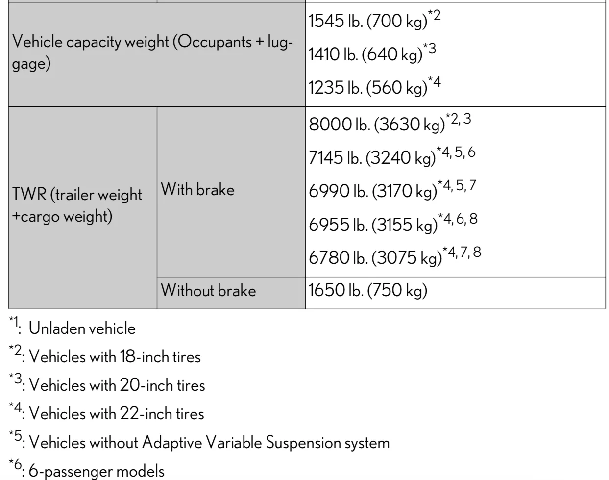

OGBENO posted the GX550 US/Canada Owners Manual (thank you). Page 552 has GX Payload. 1,545lb on Overtrail (18” wheels) and is significantly reduced to 1,235lb for Luxury/22” wheels. TWILLY guess was in the right range for the Overtrail.
1,545lb is useful in a light duty (towing) SUV. I was scouring the Manual for hitch weight limit. It specified range of 9% - 11% of trailer weight so is aligned with the normal 10% of trailer weight guidance.

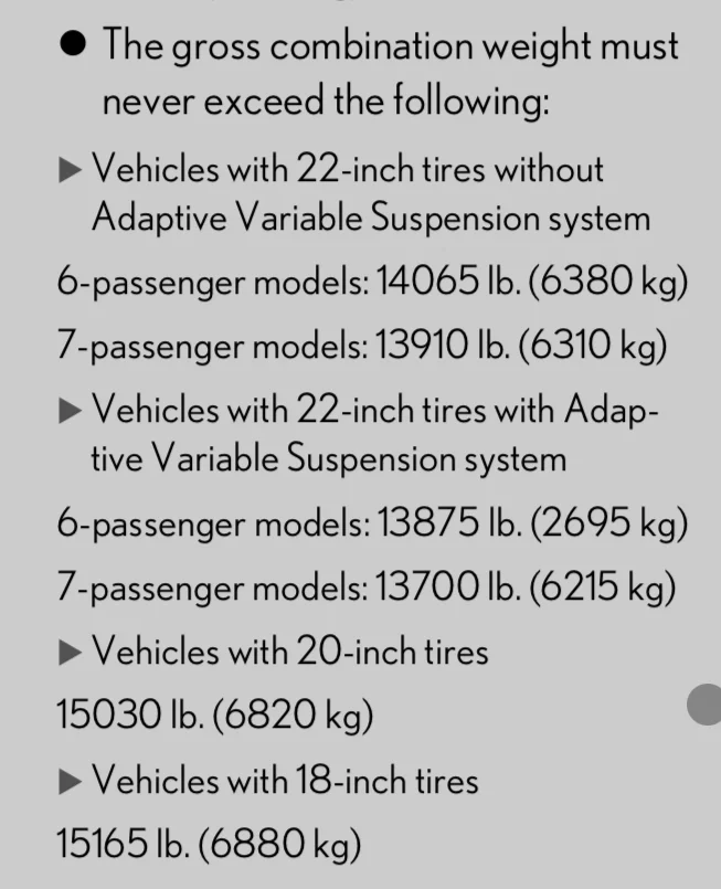

Page 186 has the GCWR which ranges from 13,700lb to 15,165lb for the Overtrail. Images of payload and GCWR below.
Looking at payload with a 6,000lb Travel Trailer and an Overtrail @ a proper 600lb to hitch weight (10%) leaves ~945lb of load for pax/bags. Not great, probably OK with being deliberate and taking only what is needed. The short GX wheelbase and soft springs will be definitely limiting and require care and being deliberate when towing.
Working backwards from 15,165lb (Overtrail GCWR) less 8,000lb Trailer less 1,545lb max payload leads to a vehicle curb weight of at least 5,620lb. Once we see real door jam stickers will have the actual vehicle weight capacity.
For comparison, I used to pull a 31 foot ~8,000lb Travel Trailer with a K2500 Suburban (with custom tuned 8.1L V8). 4 children, our stuff, bicycles etc. Went full out to get lot’s of seats, motor, bunks and payload. That Suburban was a fantastic towing setup with 130” wheelbase and ~2,900lb of payload and a 17,000lb GCWR to work with. It also got 10 - 11 mpg unloaded, surprisingly it got 7-8 mpg towing. Another surprise is it was ~5,900lb curb weight, not that much higher than the GX. When properly setup with my WDH it was a very comfortable tow and handled the trailer, my family and our gear well. Obviously here I’m not looking to buy another 3/4 ton Chevy and want to go with smaller (and much nicer) truck, lighter TT, shorter TT and way less stuff (children are mostly out on their own now).
I know most people won’t bother to do the math on payload/hitch load or axle loading. The 18” and 20” wheels have a little room to work with. With the 22” wheels the GX will be @ payload limit very quickly (like my Tacoma).
I am glad Toyota did not every GX offering with the unsolvable combination of ‘can tow 6,500lb, but payload is a whopping 1,200lb’ like my 2006 Tacoma. It was a lousy way to pull anything over 3,000lb in all cases. I’m very interested in the payload of the LC250 to see where it lands on the First Edition and Land Cruiser trims.
This is actually quite impressive if accurate. It is in the range and comparable to a 2019 F-150 Platinum(~2500 payload) and Limited(~1250 payload). I have a 2019 Limited and swap to 20" tire/ wheel combo to pull a 26' toy hauler (not loaded fully with toys) @ about 8000lbs and find it hard to believe the GX would hang with the F-150 towing this trailer.
If leaving the GX completely empty with just me and the wife with all cargo completely in the trailer, it would be pretty cool to know I could haul it to local spots in Colorado knowing I could leave the F-150 at home or even know I can go to a 3/4 ton for long hauls and use the GX for all local Colorado camping and even enjoy the trips that much more in the GX as the tow vehicle.
Something that has severely limited me with a nicer larger camper and the 80 for 20+ years and absolutely refusing to camp without the 80.
I need to look through the docs Beno posted and see if it lists the hitch weigh limit. To pull off this payload on any large trailer, it will need to be rated @ 1000lbs if not even closer to 1200lbs. IMO 10% hitch weight is a bit low and needs to be closer to 12%.
While the GX rating is 8,000lb towing it will still run out of payload pretty quickly (800lb of tongue weight is counted against the 1,545lb payload) so at that tow it only has 745lb of payload left. I also don’t think it would perform like an F150 at that weight due to the short wheelbase and (likely) softly sprung rear end.
I’m still happy to see 1,545lb as payload. I could work with that and a midsize (5K lb +/-) trailer. For me, I wouldn’t want to push a GX above 6,000lb trailer.
