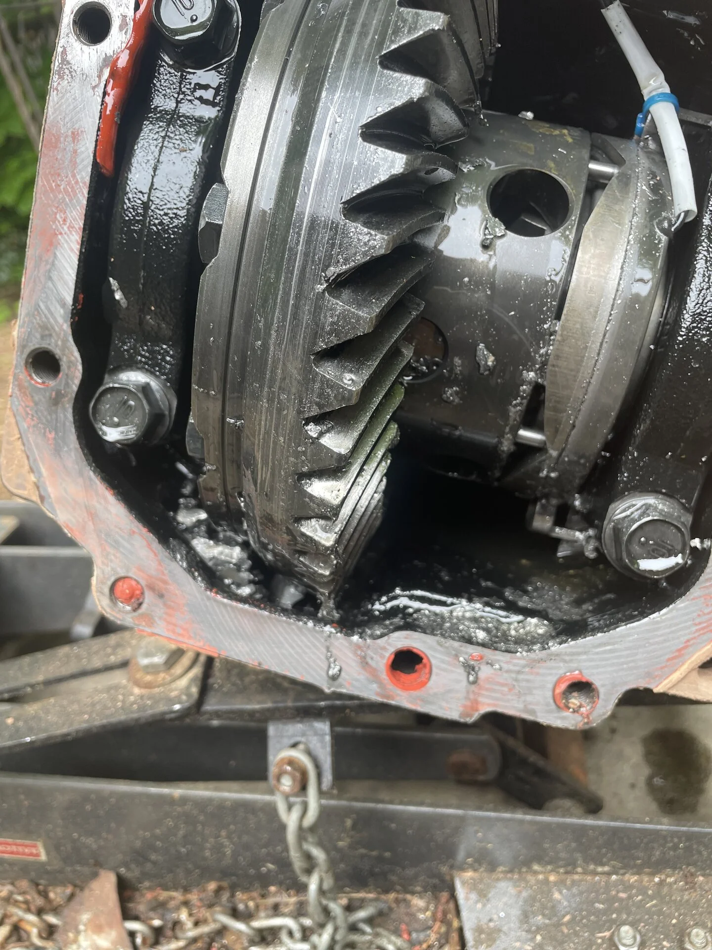

Posting a catastrophic picture with no detail is , well , unfun for us virtually riding along-
Details please >>
*posts more catastrophic photos*
EDIT:
While in Moab, we attempted Poison Spider. Lee (@ga12r1 ) broke a CV axle 10 minutes into the trail and I foolishly continued on...nothing good has ever happened any time I left Lee alone to fix his truck.
Anyway, further up the trail Sargy and I got caught between a group of SxS's, some J**ps, and a bunch of dirt bikers. It was a cluster truck from the start. Sargy got up a little obstacle but I wanted to try a more aggressive line. I engaged the rear locker but it never actually locked. I proceeded anyway because I've found that with the OEM rear locker, if the wheels slip a bit, it will engage and kick me over. This time, the front wheels slipped, then caught traction and *BOOM*
Ring and pinion shredded. Front locker was NOT engaged at the time. If it had been, I probably would've been fine or at worst, had a broken CV...
Sh*t happens...learn and move forward.
