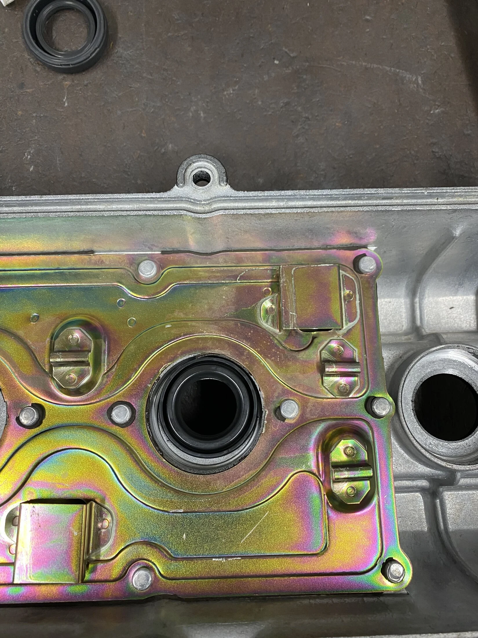

Quick note confirming this in several respects. Got my 04111-66061 from Amayama, ~$200 cheaper than the LX 450 set. Wound up not using the HG anyway b/c I went with Cometic (I’ll be selling the 105 one). But a few points here. Kit includes valve stem seals (shoulda double-checked @SNLC's post!), so do not order separately ($$) like I did (be selling those too probably). DO order the valve cover/spark plug tube seals separately, b/c the ones in the kit are waaay too small. Gonna set me back a week just to get those seals here…
@jaymar: is the valve cover above the newer version for a coil pack 1FZFE (part number?)?
It appears to be one of the more recent versions with modified covers over the baffle box drain/vent slits/holes.
Nah that's from the 96 LX donor motor. Apparently the coil pack tubes are a lot skinnier...?
OK, AFAIK there were/are a few different versions/supercessions of the valve cover. For example, the valve covers from both a 95 FZJ80 and 97 FZJ80 were identical but both were slightly different (baffle box design) than the valve cover above.
I seem to remember reading something about that on Mud, yeah. I can't even tell you that this v/c is original to the donor engine. No reason to think it's not, but who knows. I can say it didn't look like this when I got it. :)
