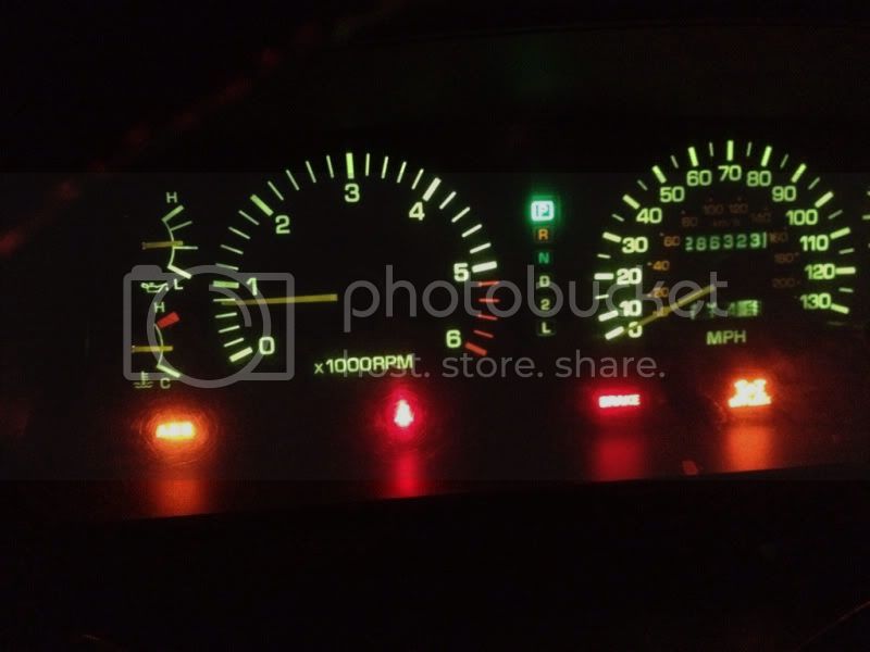

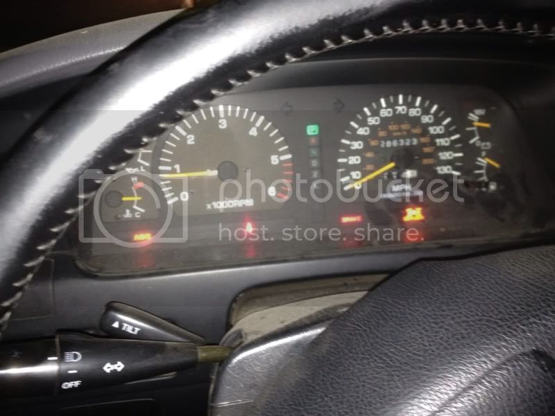

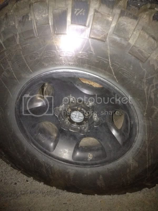

Got my poor mans part time kit installed. Aisin manual hubs from an 85 , hit the cdl switch, and put em in free. And there's your poor mans part time kit.

True. TBH Ive never driven it more than a mile or two with 2wd. The reason I put the Aisin hubs up front is because I had the set and my drive flanges were about stripped out. So I just keep the hubs locked for driving around town. Just tried out the poor Mans kit last night after seeing this thread for the hell of it
