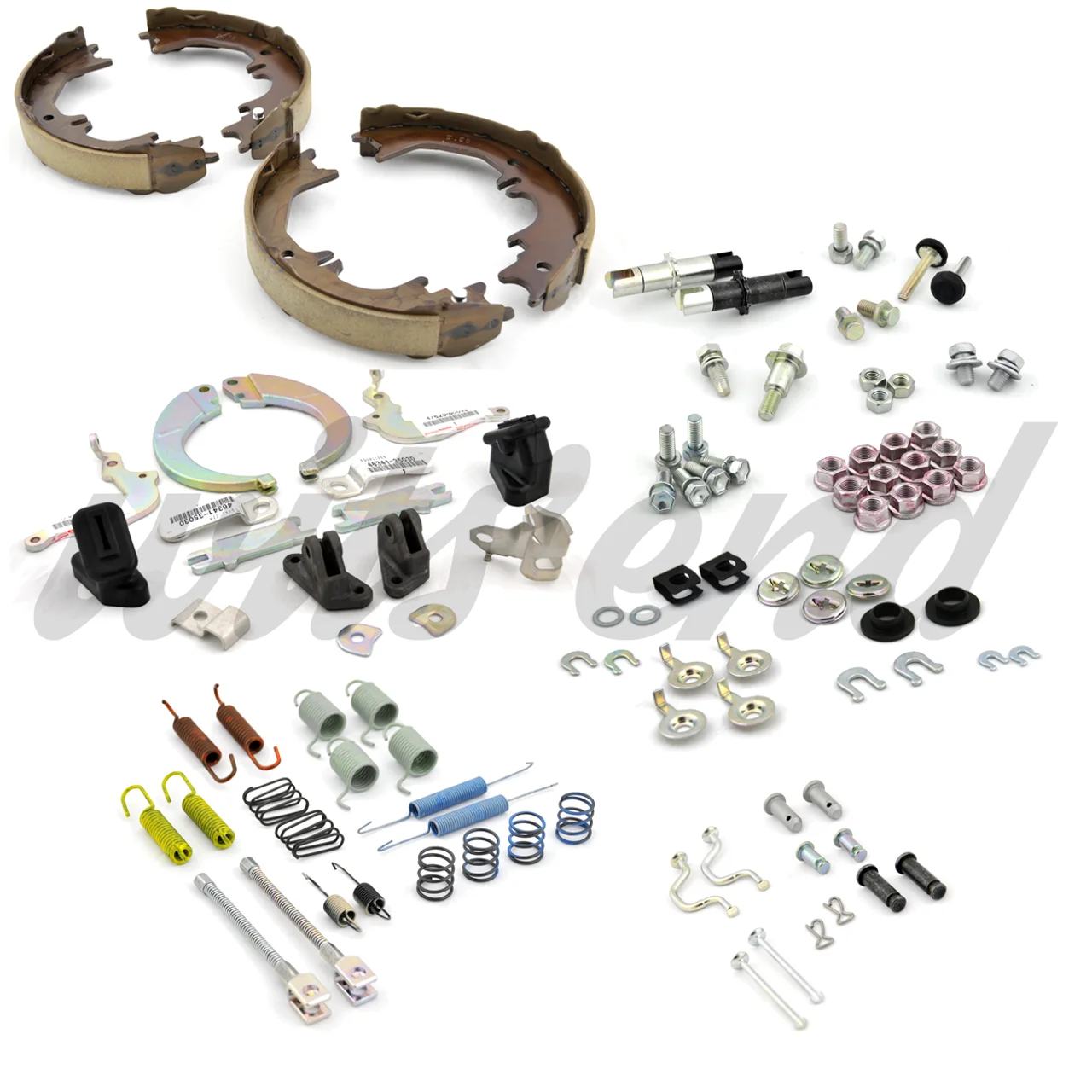

So I did something I rarely do, took apart both parking brakes. I did take a ton of pictures, but for the life of me I can’t seem to find where this spring goes
Did you source your hardware from an aftermarket supplier like Napa? If so i suspect it is just a random spring that they include so their kit works for multiple models. I don't see that spring on any the photos i took of my handbrake.
Yup, aftermarket. I believe you are correct, I just had a look in my debris pile from when parts were falling out as I removed the rotor, I don’t see that spring anywhere. Problem solved, cheers
Looks like the ones that go on the inward facing side of the ebrake assembly. Should be 2 of those for each side that give tension to the lever/arm sticking thru the brake rotor dust plate thing.

Here's a photo of a complete E-brake Toyota parts kit grabbed from Wits Ends website:
Check out post 13 in the thread below. I think that is where your spring goes.
It’s the return spring on the back side of the drum on outside. Aftermarket kit only comes with one for each side instead of the two you took off. Ask me how I know.
Correct. The green circle in post 4 of this thread is where the springs go, on the Bell Crank.

Got it, I haven't taken a look but I'm guessing these springs attach to the bell crank on the axle side (not inside the rotor) same as a 60 series drum brake. I thought that spring looked familiar, I probably have a few kicking around in my 60 series brake parts bin. Good thing I still have 60 series part totes, even though I haven't had a 60 for over 5 years, just another parts hoarder.
