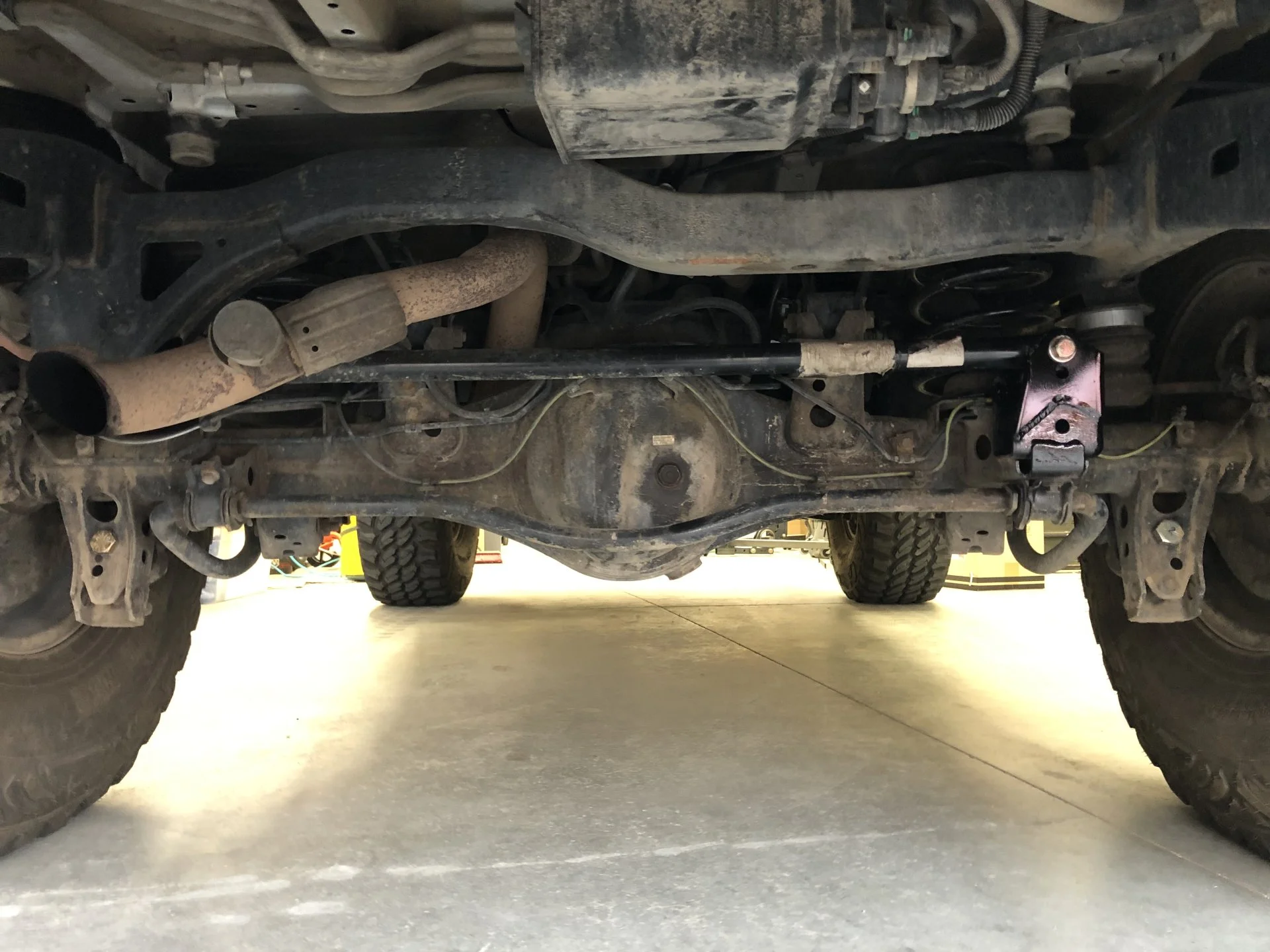

Another happy member here, looking forward to getting it installed. Dry run looks like this will do the trick. Super fast shipping @jkeithw ! Thanks for taking the time to fab this bracket, much appreciated.

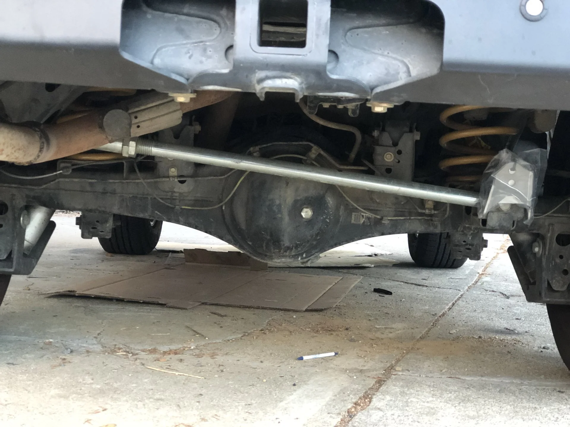

Which adjustable panhard bar are you using?
It’s the tough dog adjustable bar. It’s super beefy, seems about twice as heavy as the OEM. The chrome color is a little obnoxious. It was pictured as black but shipped from Australia so Im not covering the return to sender lol.

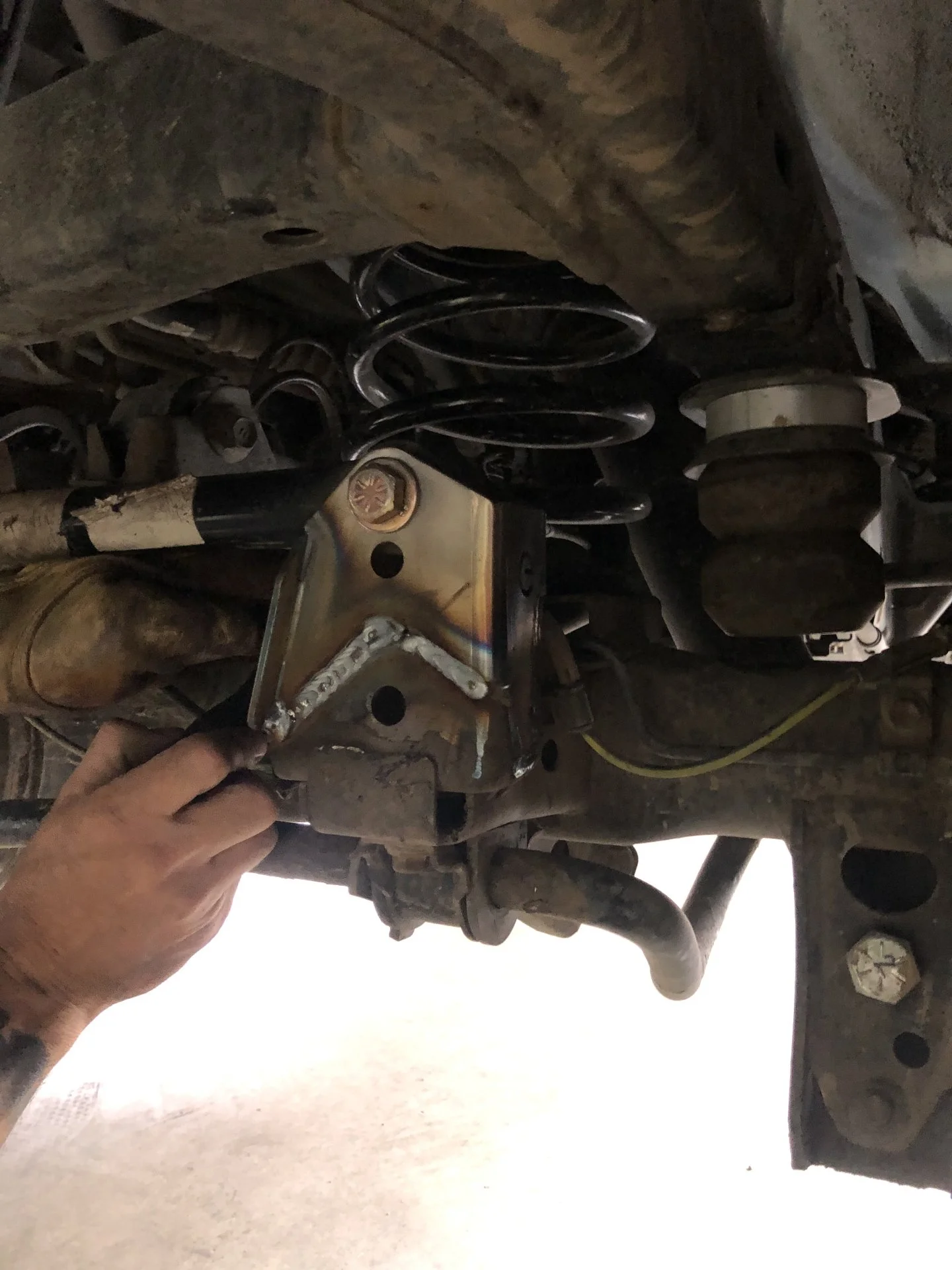

With a dry fit, we found the bolt wasn’t happy at the angle of the two holes in the bracket. It was super close but we just couldn’t get it to cooperate. So a little grinding on the tab that hangs down on the passenger side of the bracket and sliding it ever so slightly to the passenger side and it seemed happy…
Also my factory bolt had a few of the threads smashed flat, so I got a longer grade 8 bolt that allows the bracket to sit only on the shaft of the bolt rather than the threads and cut the excess threads off.
And the new nut on the back clears the coil fine even with a zinc washer.

With a dry fit, we found the bolt wasn’t happy at the angle of the two holes in the bracket. It was super close but we just couldn’t get it to cooperate. So a little grinding on the tab that hangs down on the passenger side of the bracket and sliding it ever so slightly to the passenger side and it seemed happy…View attachment 3114266

Also my factory bolt had a few of the threads smashed flat, so I got a longer grade 8 bolt that allows the bracket to sit only on the shaft of the bolt rather than the threads and cut the excess threads off. View attachment 3114268
And the new nut on the back clears the coil fine even with a zinc spacer.
Thinking out loud and wondering if the lower hole might suit your setup better? Can't tell from the pics exactly but looks like it may be just level or upwards at the axle mount?
The stock setup has a slight downward panhard angle at about 1.5" height difference This can help on-road as that tends to be mostly compression travel.

A flat bar position equals the furthest passenger side for the axle. Either compression or droop where the bar is not flat will equate to the axle moving to the driver side of vehicle. The axle side-to-side movement is in an arc with the radius being the length of the panhard bar and the center of the arc as the frame-mounted pivot point of the panhard bar. If I am thinking about it right. The idea is the panhard bar should be as flat as possible (at static ride height) and as long as possible to minimize the amount of side-to-side movement of the axle through the entirety of its vertical travel. This also assumes ride height is roughly neutral for compression and droop travel for higher speed driving.
How much pressure is placed on that bracket? Any chance of the weld failing at some point?
High speed cornering and large lateral impacts will create high loads on the panhard bar and mounts. The new bracket will create higher moment forces on the OEM bracket where welded to the axle housing. Take a look at the photos for the new desert racing Lexus 600 and you can see they added additional reinforcing to the frame mount and an extra tube to the frame mount to make it survive. Now desert racing will have many situations where high-lateral loads will be present, likely much more so than a typically road or off-road vehicle.
My fabricator didn’t think so at all. We discussed it since safety is something I bring up a lot (surprisingly).

Just ordered metal cloak duroflex joints and when they arrive, we’ll take a measurement with them in place to order the Wide Open Designs aluminum bar. It’s kind of a test run to familiarize myself with the process before ordering some lower links in the same manor. Rear uppers, I may do driver’s in aluminum and passenger in steel, since it will be bent to clear the fuel tank. Everything is uncertain until complete though, and I’m always open to input.
Edit: metal cloak order canceled. They didn’t recommend that much flex and movement in a trackbar/panhard bar. So, we’ll see if I kick myself for using heims.
I was under the impression that for something with a fair amount of travel you’d actually want the bar slightly below level so that normal compression during driving still keeps it close to level, vs all compression movement being in the direction of the arc.. and more importantly, the further from horizontal we get the rate of lateral displacement increases dramatically.
Also this allows for things to be loaded into the vehicle and not pull us above vertical. I get that level is “ideal” but there are always compromises in the real world.
Now if we are talking a track car with stiff suspension, yeah, level. But Toyota’s decision to have it angled at stock ride height wasn’t on accident, this bracket simply allows us to easily reset some geometry back closer to stock in spite of additional ride height.
