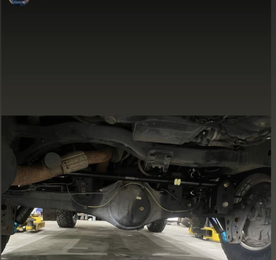

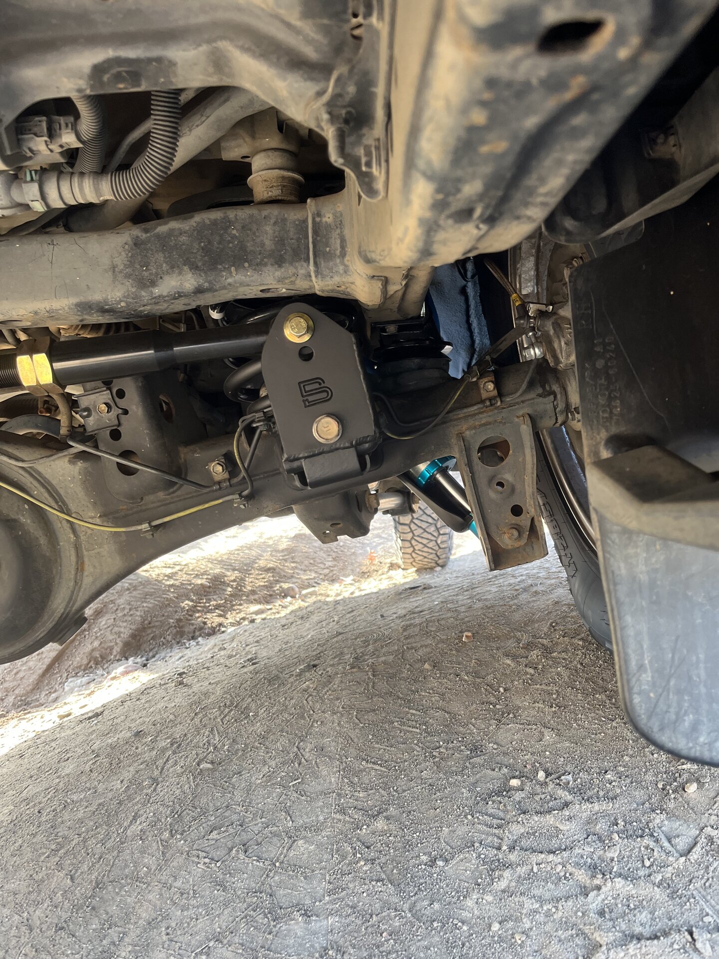

Finally found the time to get the bracket installed. Happy to report it fit well and made a dramatic improvement in how the the rear suspension cycles and handles over bumps. The angle is much improved.

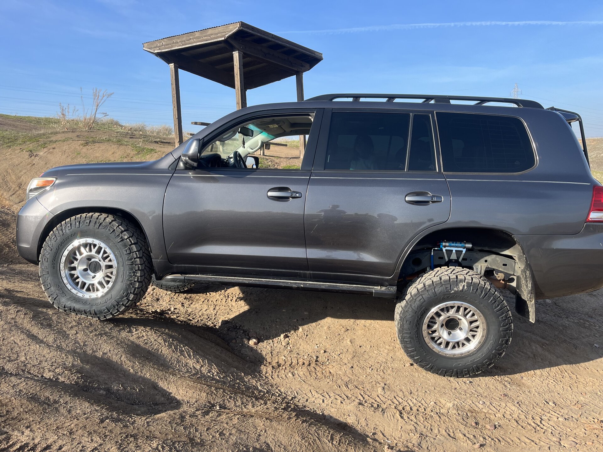

Flexed the rear end to its limits on the trails with @100kiwi and the bracket performed well
Before and after images.

Have a pck from stellar built on mine. I have it for almost a month now, so far I like how it ride.

Apologies for the late response. It's bolted and welded.
@eimkeith quick question: Do I tighten the panhard bolt on your PCK for the 200 back to the 111 ft/lb factory torque spec? I think the answer is probably 'yes,' but just confirming. Thank you, and love the product. Speed hump wiggle is nary gone.
