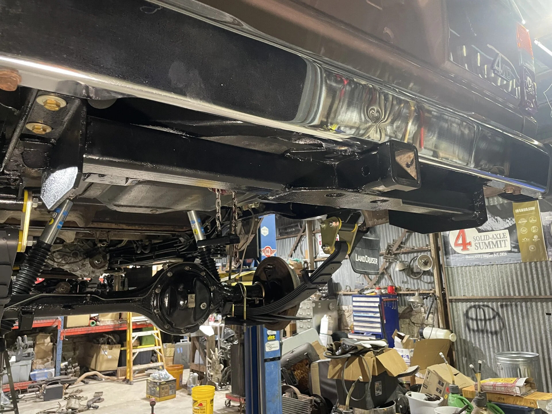

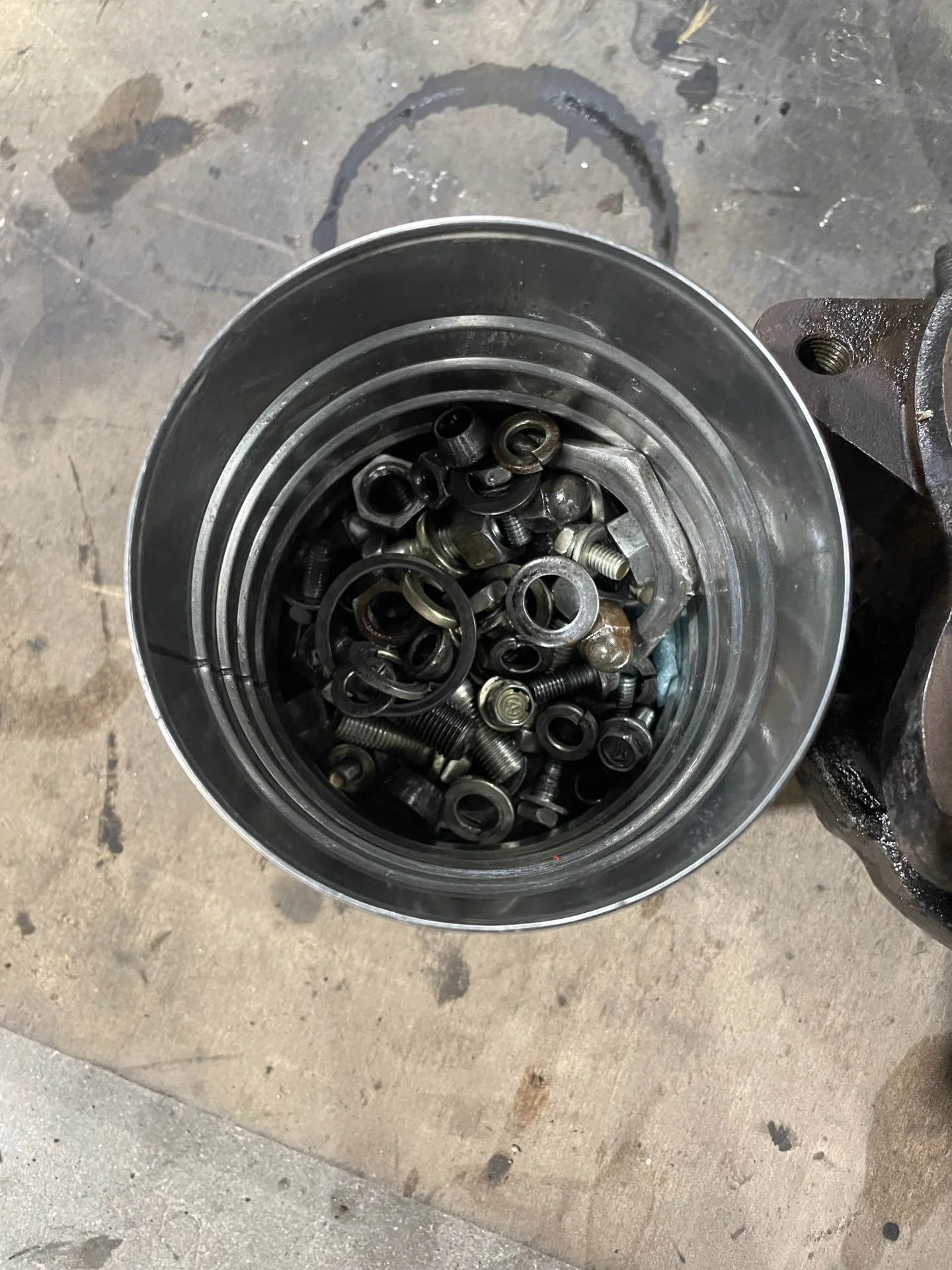

Finished parts washer detail earlier tonight. The fun part begins tomorrow. Only have to wear gloves when applying the grease :).

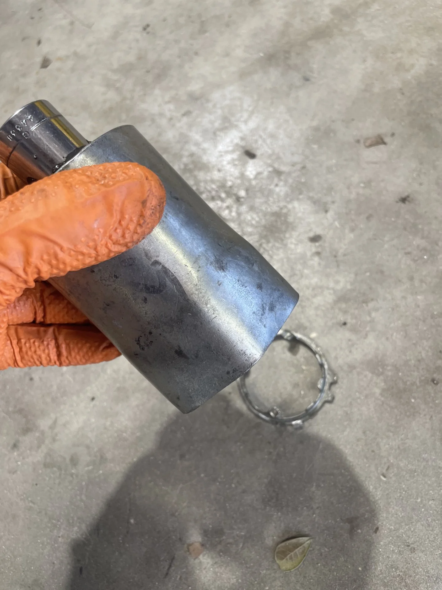

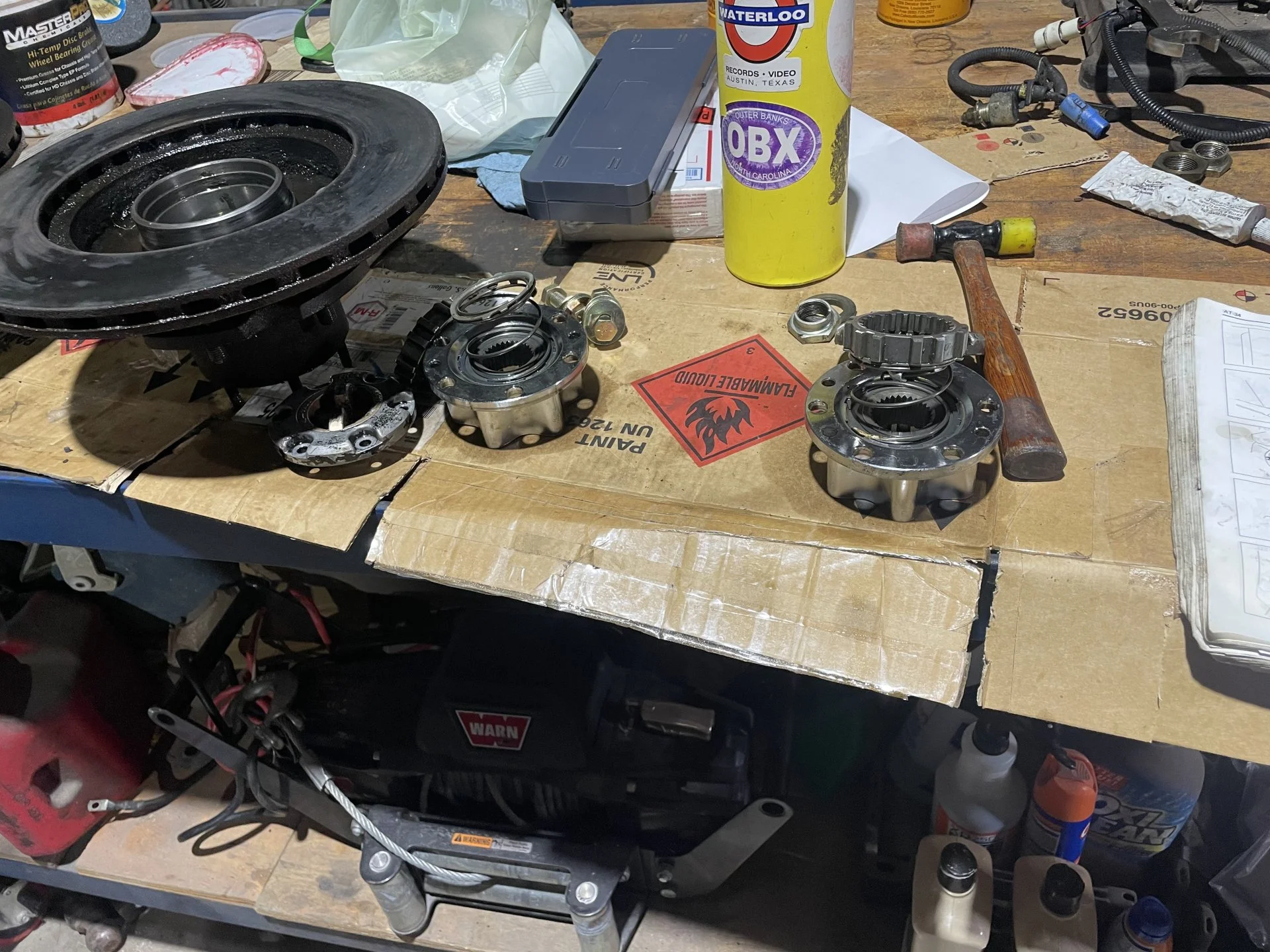

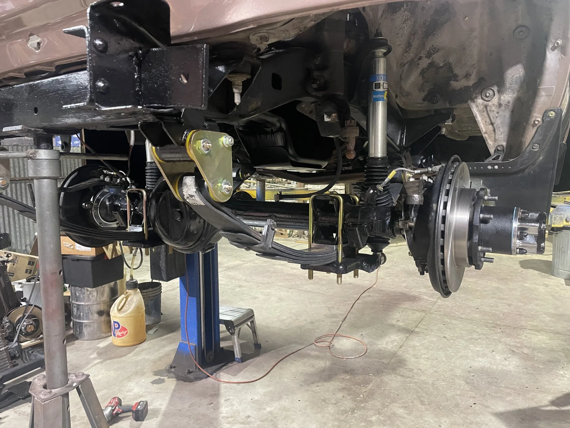

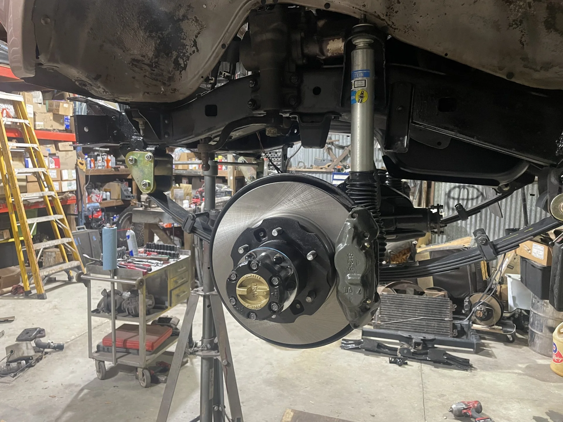

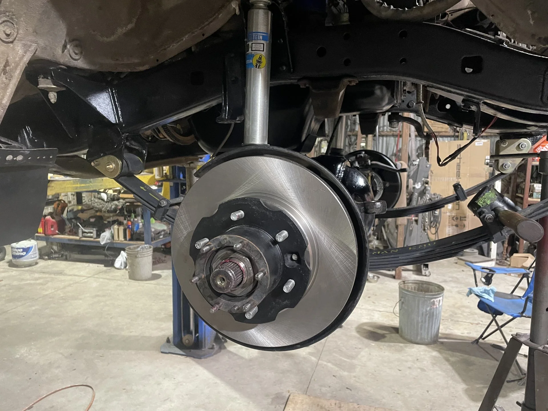

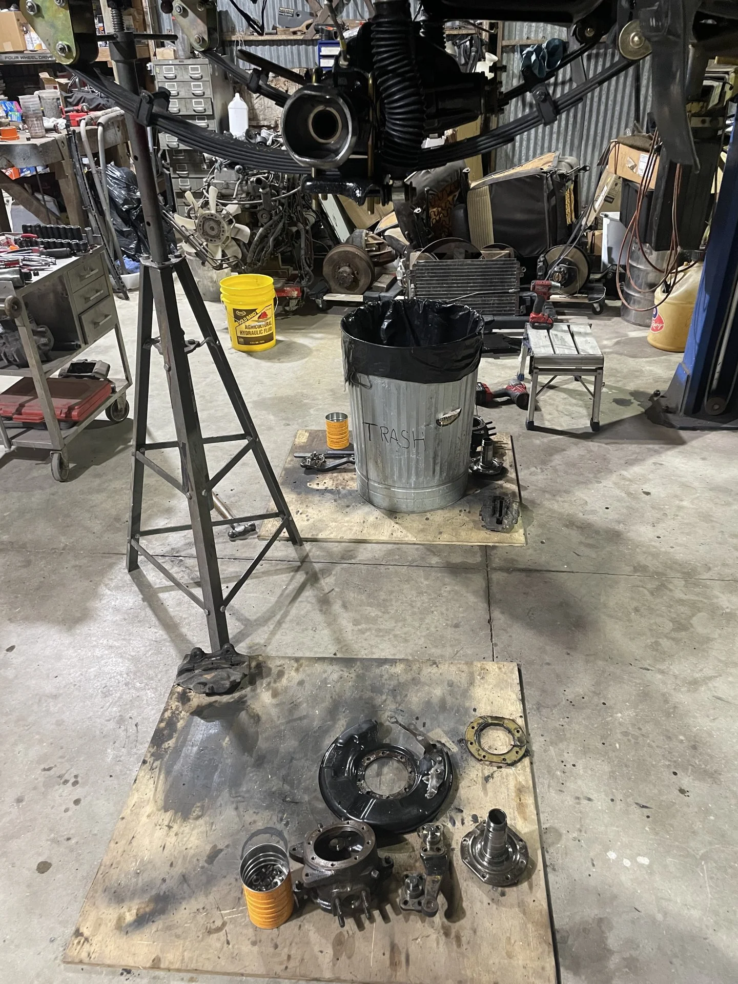

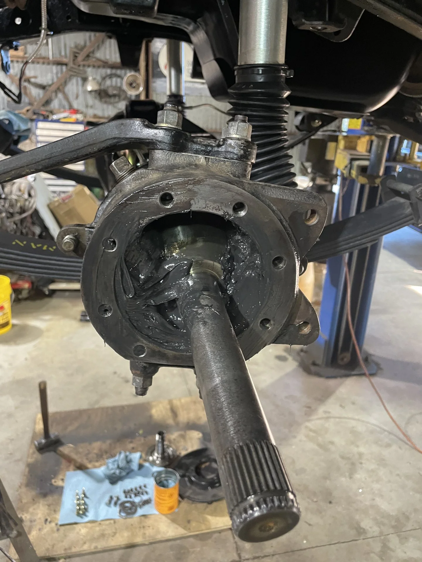

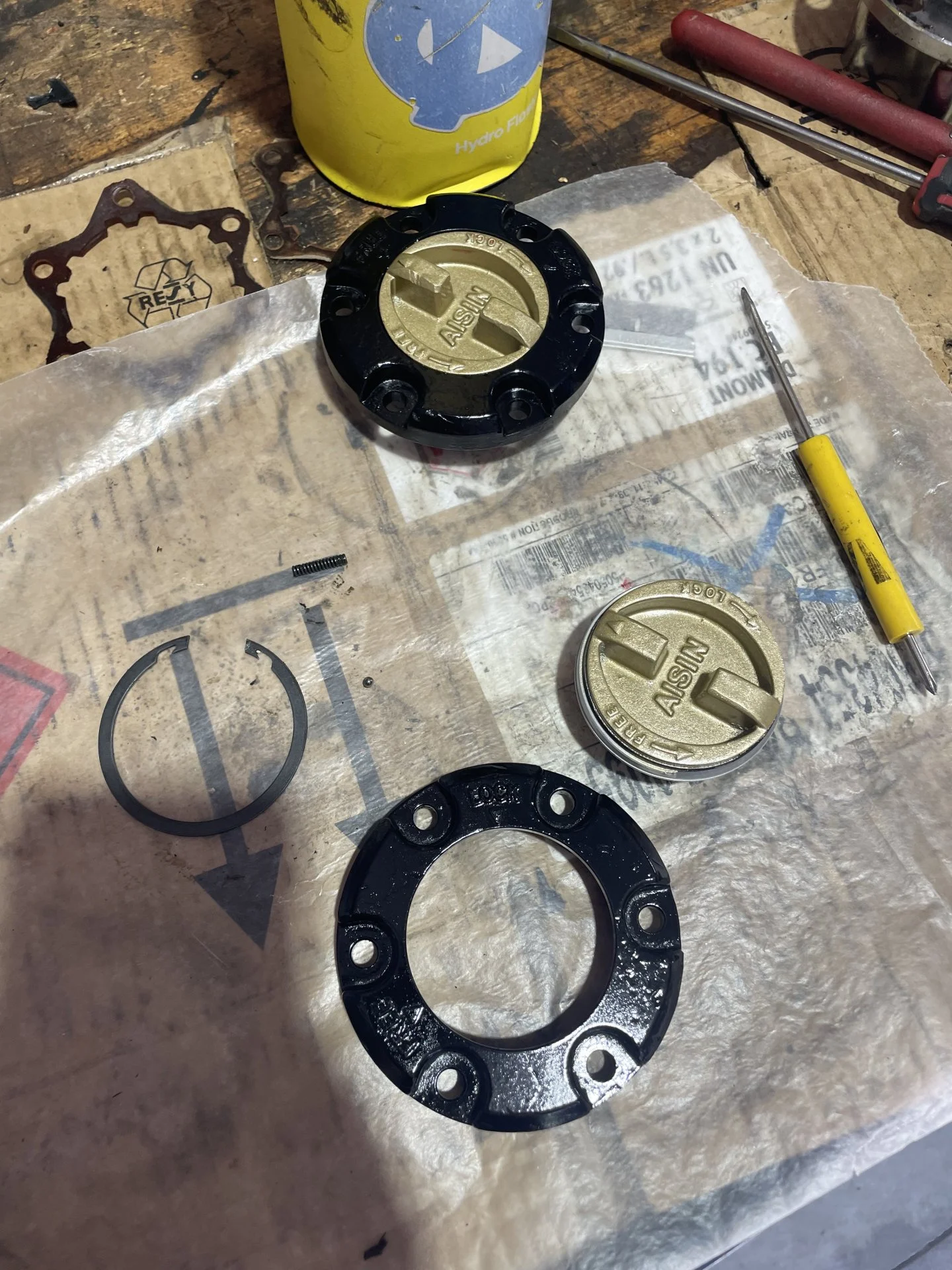

Probably spent way too much time trying to rehab these hubs yesterday. Just too curious and wanted to see if I could figure them out. Both came apart when removed the other day. One had the metal collar (holding the springs) bent up pretty bad. Straightened it but it would not work properly. After several attempts I swapped the innards from another one that was damaged on the dial side. All good now. TRE’s and rear brakes today.

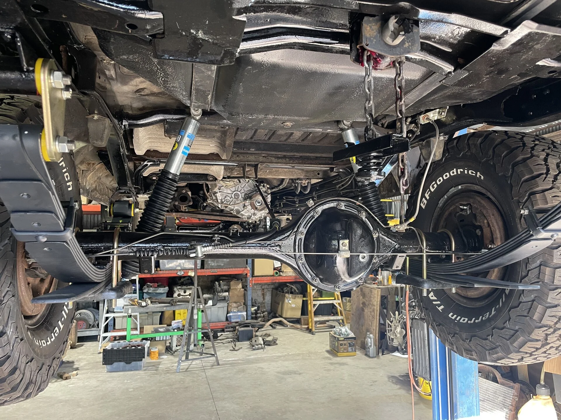

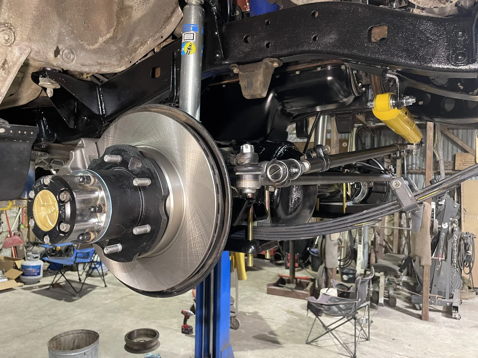

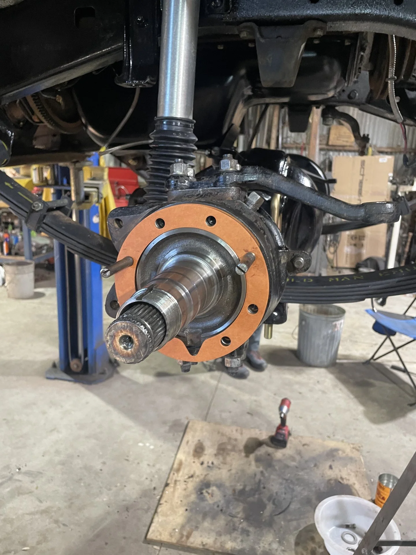

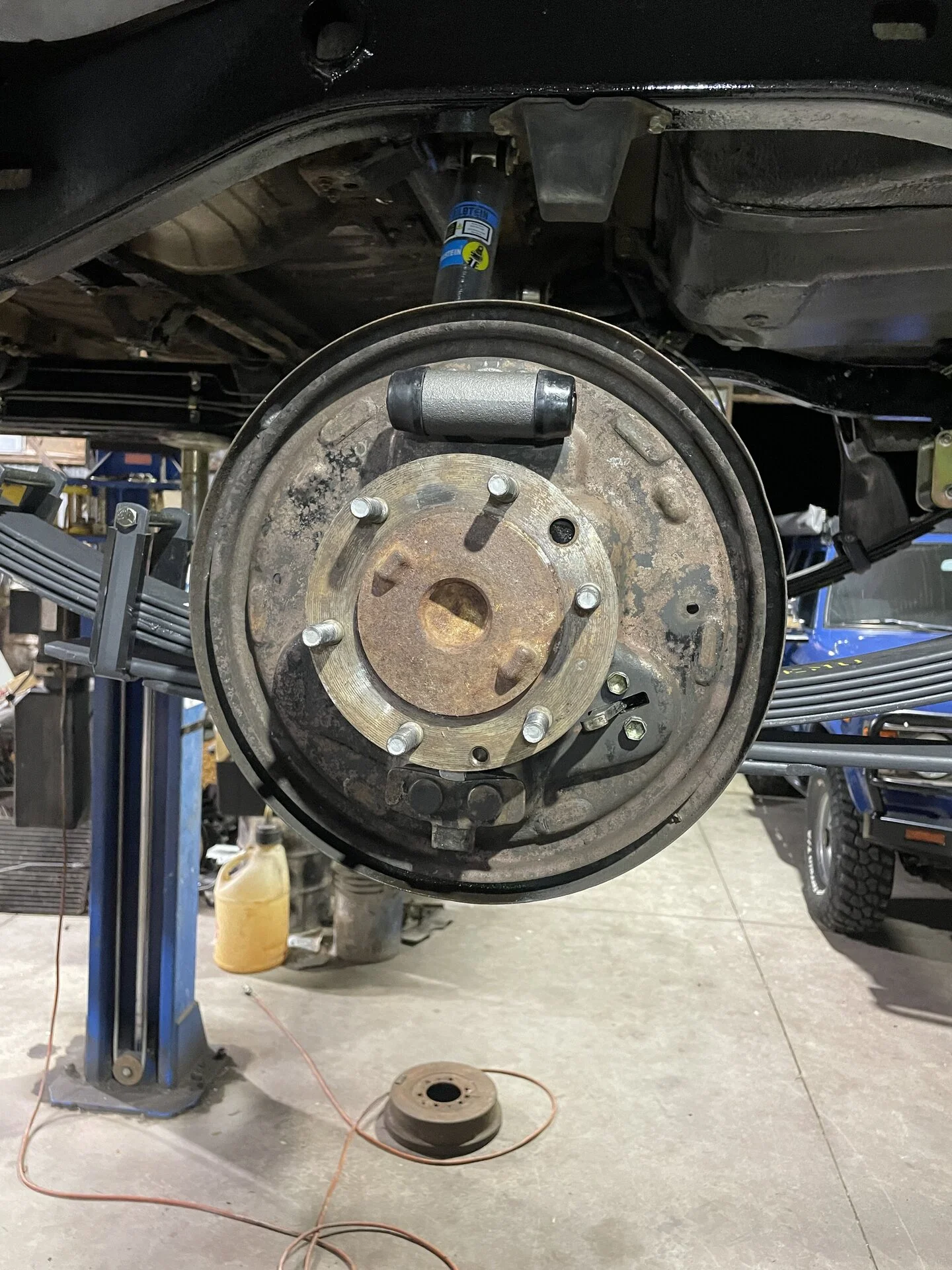

TRE’a and drivers rear brake done. The rear brakes were almost new but due to so many years of non use I broke everything down including the bell-crank. Cleaned and installed new pads and cylinder. And I mounted the trailer hitch (need to drill a hole in the frame for the third bolt) which came off our original 60 my father in law gave me in 2006. And I mounted the spare tire carrier.

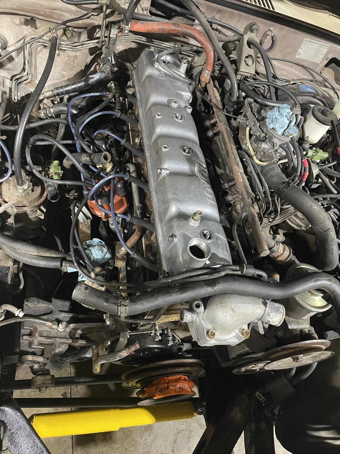

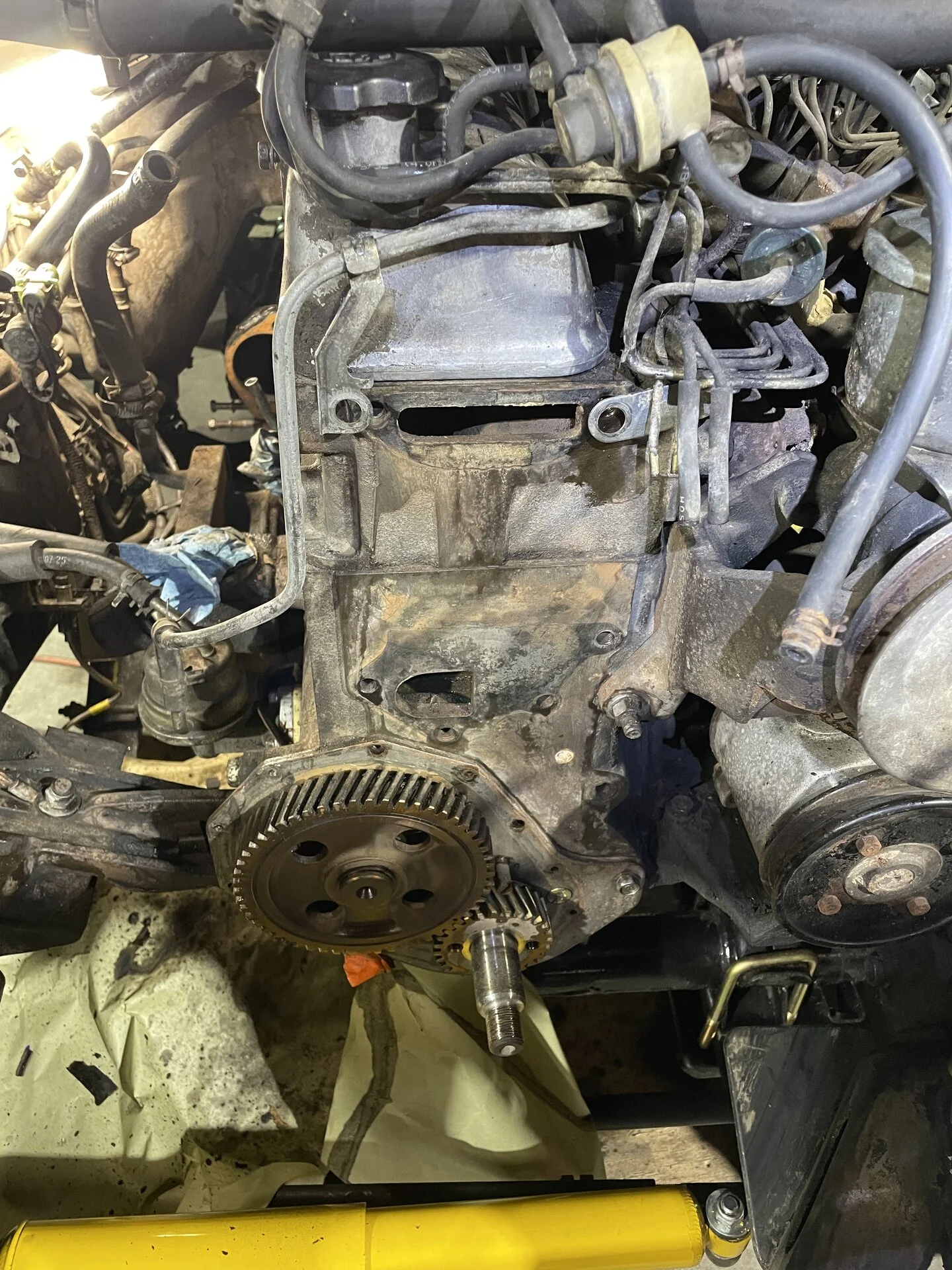

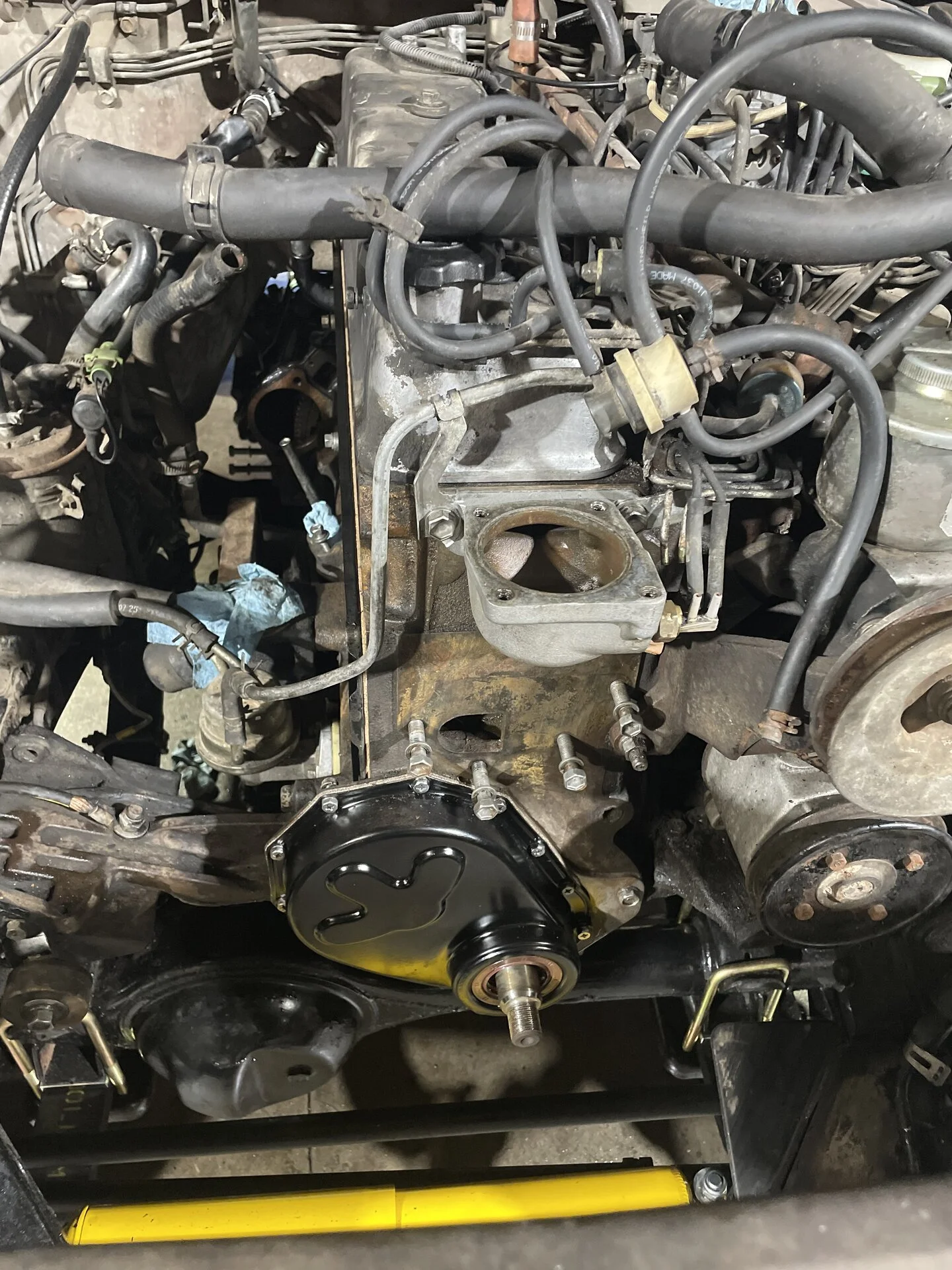

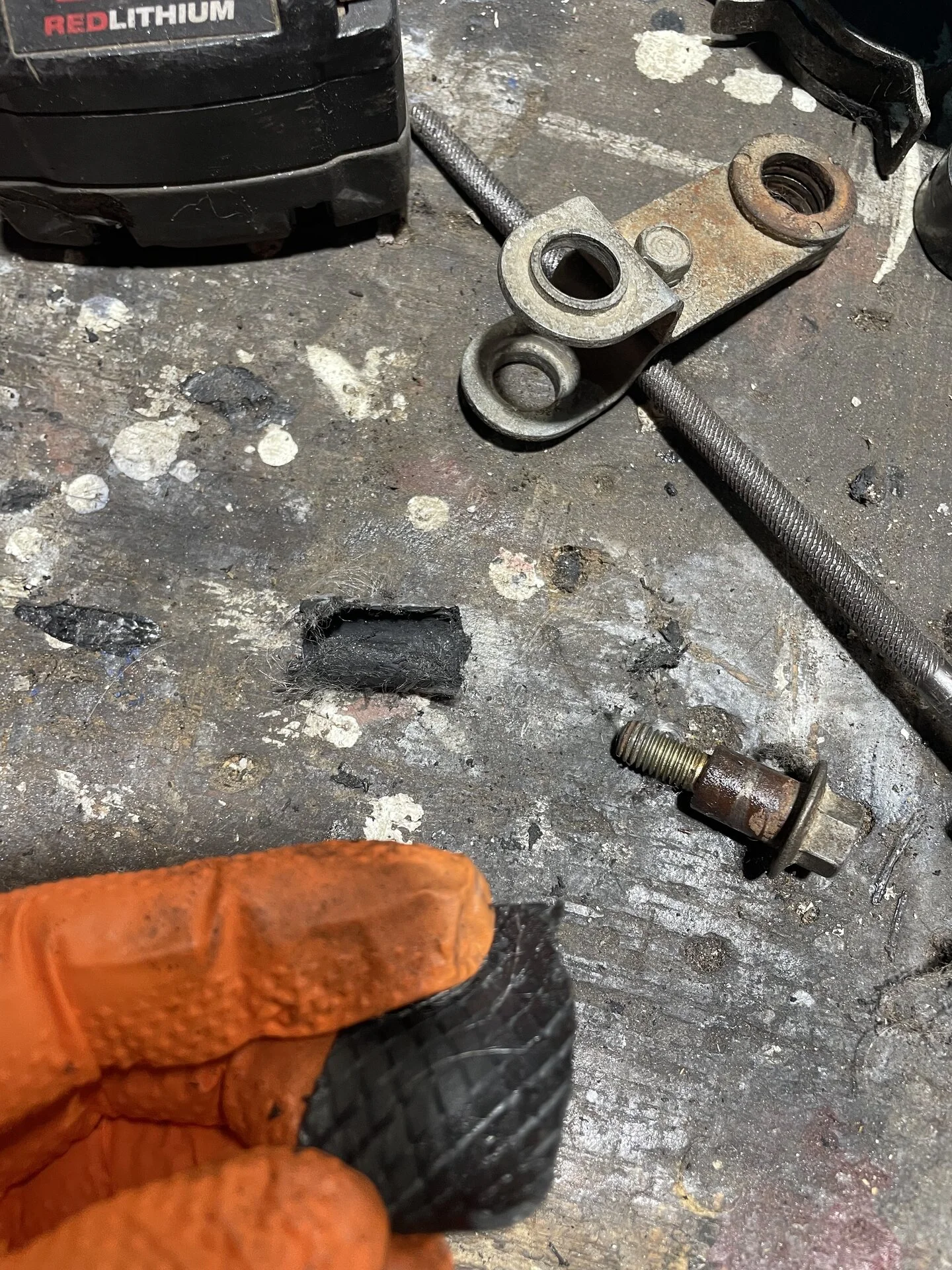

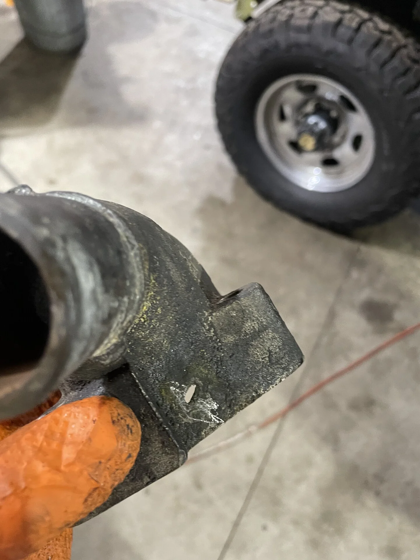

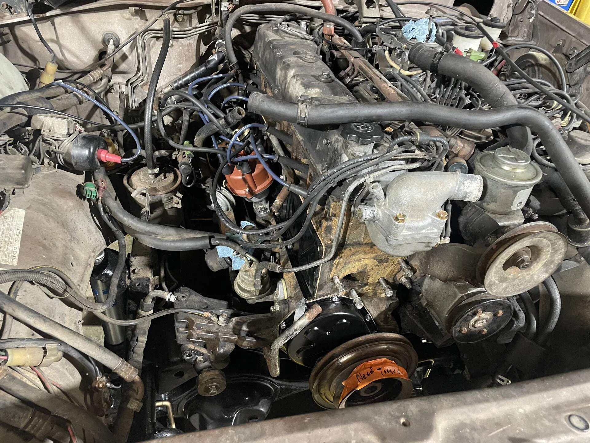

I’ve worked on it a bit this week. Buttoned up the underside except for putting the front sway bar on and driveshafts. The rear needs a new u-joint. Ordered some and will take it in to a place I use in SA. Would do it myself it was for my cruiser. Minimizing any potential shimmy’s or vibration since this truck is going to the mother of my boys. Want them to balance it as well. Also ordered a new clutch master and slave. Did the front crank seal and the lifter cover gasket. New thermostat etc. cleaning out the corrosion in the top of thermostat I punched right through the metal. Grabbed a good one from the tote and moved on. Was a bear getting the crank bolt off. Soaked it with Kroil (great stuff) and used an extra long pipe and she came off. Ordered a new water pump and a few more hoses. Should be here soon. Valve cover is next. Thanks for watching along :). Oh…and new thermostat bolts courtesy of ma man Matt @ToyotaMatt
