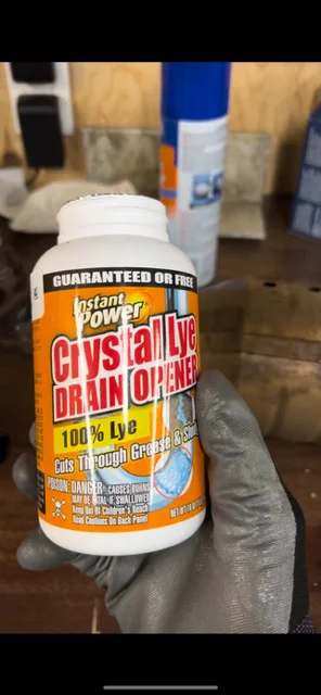

Here is what i used and my process.
1. removed the cat
2. rinsed it out for about 5 minutes with the hose
3. mixed this 16 oz 100% lye drain cleaner (apparently lye is sodium hydroxide) with 1 gallon of warm water. (carful it can bubble up and dont put it in a sealed container and definitely dont shake it in a sealed container)
4. plugged one end of the cat tube, filled up the cat with about 3 quarts of the lye solution then plugged the other end.
5. placed the cat on this long bucket and about every 15-20 minutes for about 4 hours I would come role it around and agitated it.

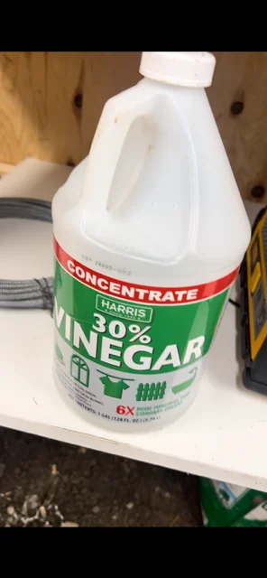

7. dilute this 30% vinegar (bought at home depot) to a 10% vinegar solution
7. same process as the lye solution. plug one end, pour in vinegar, plug other end, agitate every 15 minutes for 4 hours.
8. rinse with hose for 5 minutes
