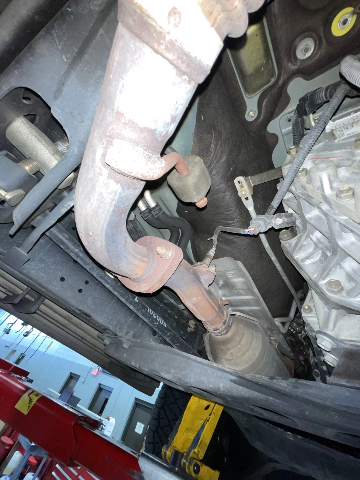

Here are some photos, of mine. I was told by my mechanic that the existing flange plate seems rusted and he was afraid of breaking it if removed by force. Not sure if I need to replace a section of this pipe as I'm trying to avoid having to replace the entire run including the
cat.

Something like this @GXO ?
It doesn’t seem like the best website to source from but this is the best example I have found for what I think you are talking about.

You might have a problem in the wiring harness for the O2 sensor, if it is throwing the P0156. It could be corrosion in the connector or something else with the sensor that is not right.
However I do have the 90-degree O2 spacers in my GX with the front two cats totally removed (due to headers), and I get no CEL's! But, if you are getting the P0156, it might not go away even with the spacer if there is some other sensor/wiring problem. The spacer just tricks an otherwise properly-functioning sensor into thinking there is less unburnt fuel in the exhaust.
So are you suggesting the wiring harness be replaced? Is there anyway to remove the corrosion in the connectors?
You should inspect the wiring harness and connector for signs of damage or corrosion. If the connector is corroded you should be able to either just bypass it with some heat shrink connectors or buy a replacement connector online and splice it in.
