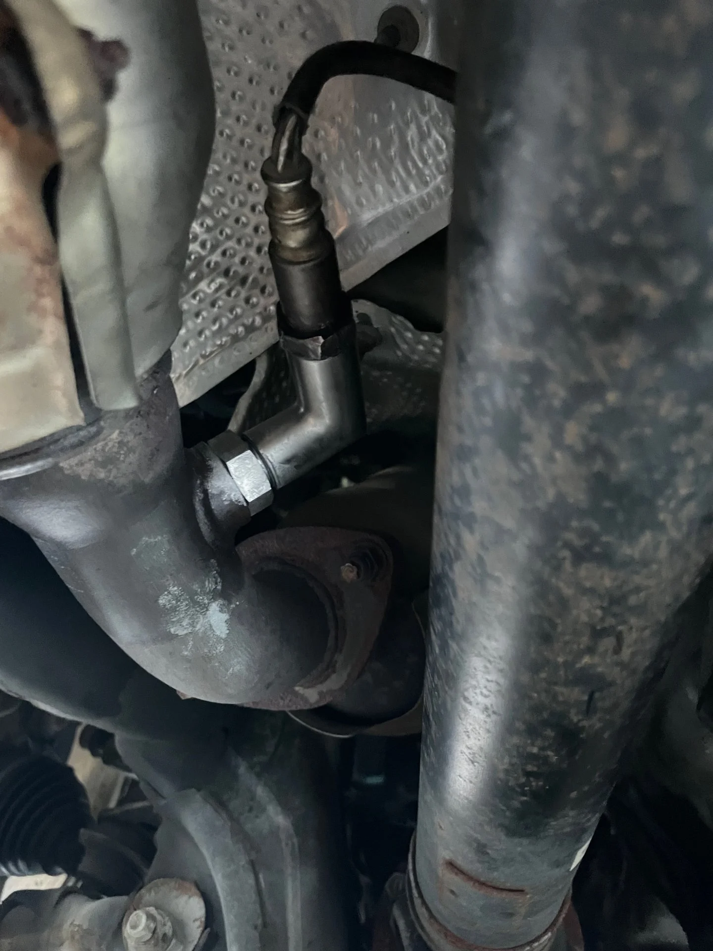

Yup, I was using one of those slotted O2 sensor sockets. As to strong arm power, I did have my coffee and Wheaties before I crawled under the GX 😭 lol. What I saw in some YouTube videos since was some suggestions to put a hose clamp around the socket to prevent the slot from expanding during torquing and thus slipping. Will also try using a hammer on the breaker bar as most have suggested instead of the tugging' method.
the hose clamp idea is an interesting one and probably does help. I got mad and cut it off and slid an impact up in there and it buzzed right off haha
We did it! Got the driver side O2 sensor off today: hammer, warmed up, and a hose clamp around the slotted wrench, and 2 bowls of Wheaties before starting work. Got the spacer on. Crossing my fingers and hoping that the codes don't come back... Thank you everyone with the help and suggestions!!
