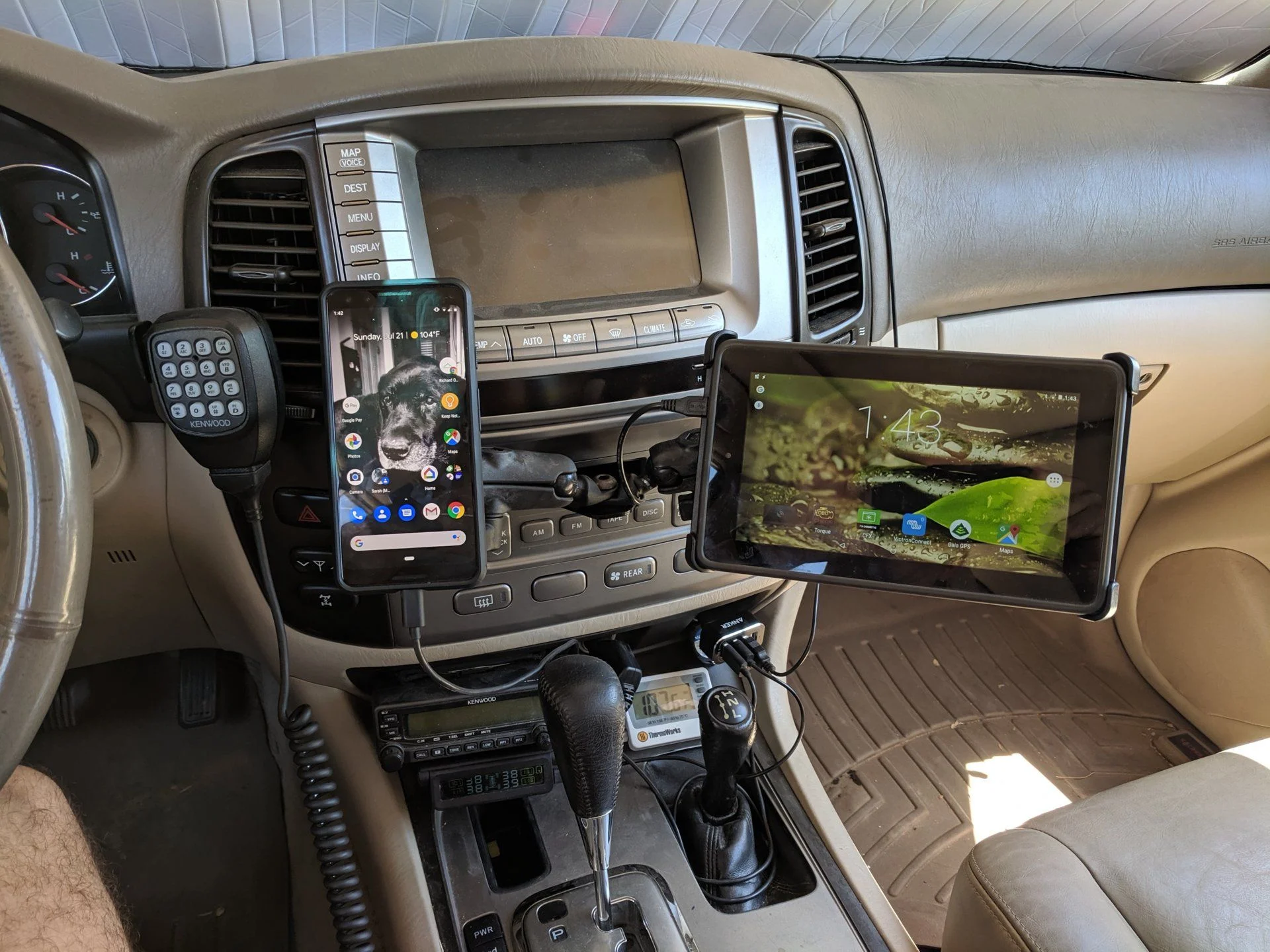

Finally got this installed. Mounted my Fire tablet and magnet mount for my phone. Tried the Ram X mount for my phone, but hated it since I couldn't do it one handed. Used the Ram magnet base as a phone holder. Works great.
Can you tell us more about the magnetic mount? I hate the X mount too.
It's just a Ram magnet mount for sticking something to the side of your vehicle. It's a round mount that has 3 rare earth magnets inside of a rubber coating. I have a metal plate stuck in the phone case from another magnet mount I used to have.

Mr. Young. Your layout was genius. I copied your exact set up... why mess with perfection! I'm super pumped with the layout and the quality of the Owl Mount. You better believe I installed the Owl sticker on the dash for everyone to see! If you haven't done this accessory you are missing out. Get yourself the owl mount now! Fyi... all OEM buttons and dials are accessible with this set up! No affiliation with Owl, I'm just a satisfied customer.

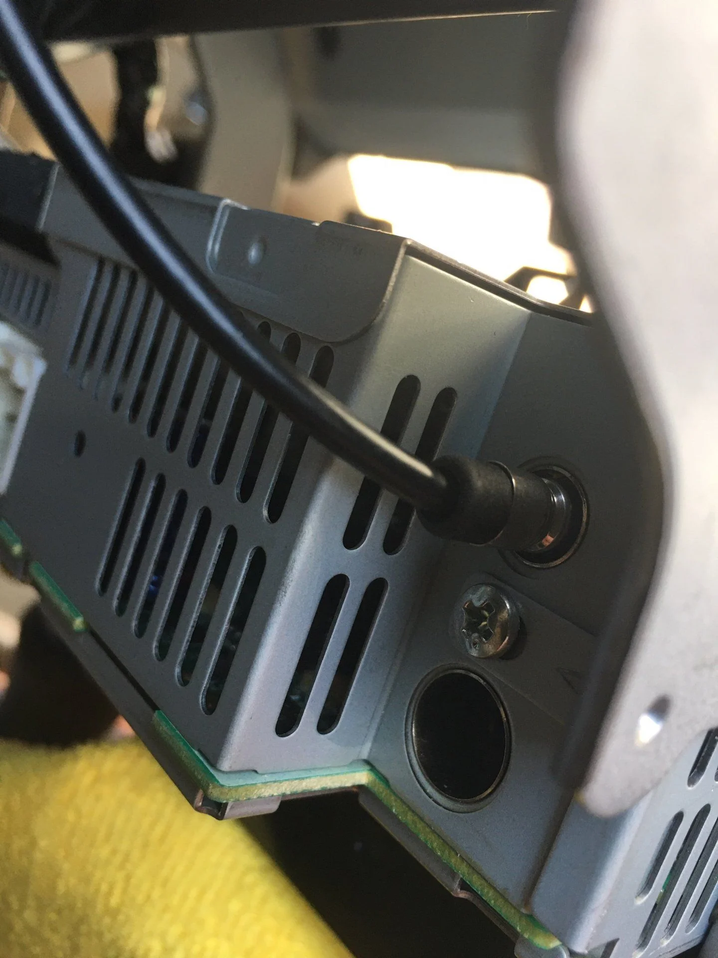

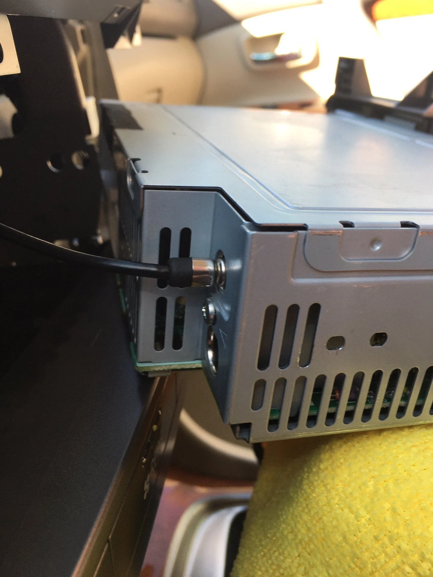

Working on pulling the tape deck out of my 2007 LX. Anyone know what this last cable is for? This doesn't seem to exist in older models (like in the instructions for the media mount). I haven't wanted to pull too hard on it. It doesn't easily pull out like the one below it. I think I can finish this mod with this cable attached but it leaves little room and it's not ideal. I wonder if it's related to satellite? Any ideas?
There are two antennas. The small one is for the one in the rear passenger side glass.

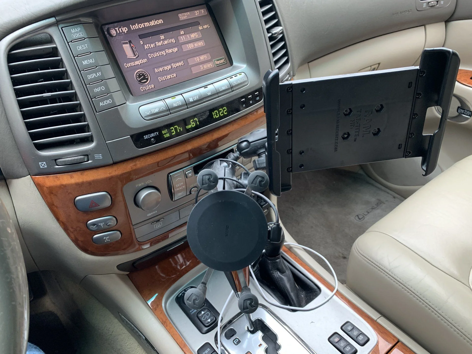

Here is my setup. I have a Galaxy Tab A 10.1 GPS, with Torque Pro and Gaia installed. The holder for the Tab A is the Ram 8", and it fits perfect. It looks like it overhangs the passenger seat, it does not. I also installed a wireless charger for my phone.
Overall, great product, @Ramathorn15, and I highly recommend!
@Lonegrasshopper Great setup. Which double ball did you go with for the mount itself? Love mine and have been eyeing a dual setup like yours.
