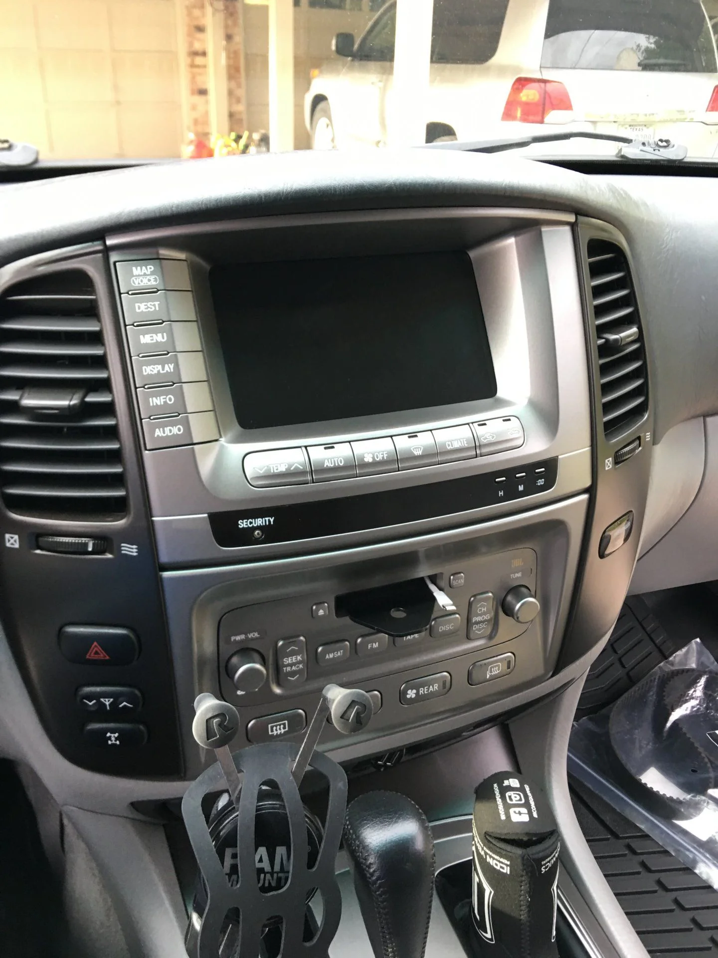

If you’re using an iPad or iPhone or other equivalent device for navigation and have not done this mod yet, you are missing out. I held out doing this install for almost 2 years. I even had the mount and didn’t do the install as I also purchased a RAM floor mount for the passenger side (which I’ll say left it pretty much useless for having a passenger) and waited about 2 years to do this install. Having it done, I wish now I would’ve just went ahead and installed it when I originally bought it. Ram floor mount is coming out tonight!

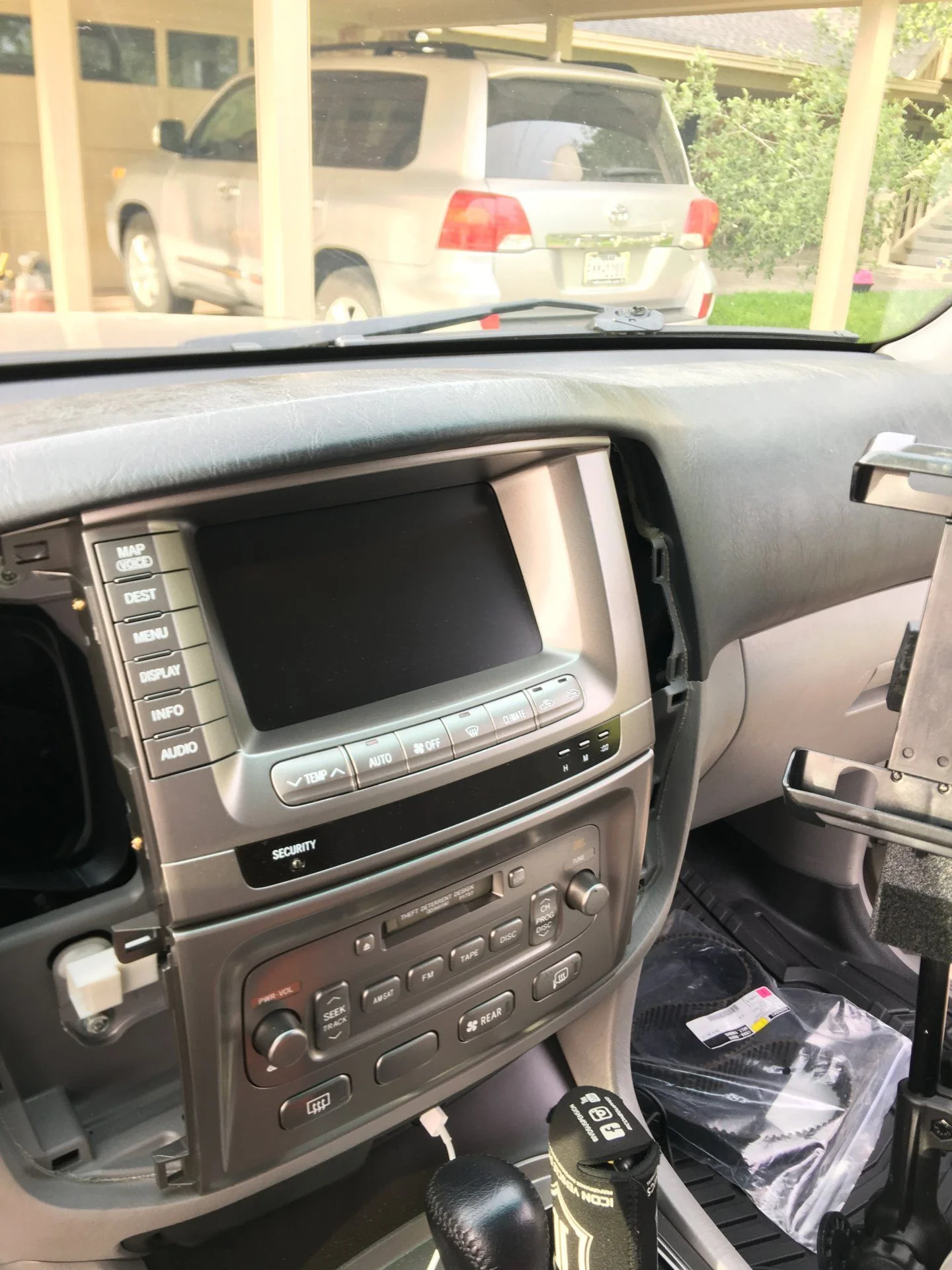

Went to do the install today, and failed. Got all the way to the end, where you remove the 4 screws and the things would not budge. I had prepared for it, knowing that I should use JIS, so I bought a JIS precision set, and the largest one (size 0) would not do anything. I tried to put vise grips on the handle to get some more leverage, but nothing.
Not expecting much, I tried similar sized phillips precision set and nothing. Pretty sure they are at least partially stripped from my attempts, but I started with the JIS and they would not turn. I had seen in an earlier post that a JIS #1 was what was used, but I would be heistant to think there would be so much of a difference between the 0 and 1 that it would allow the screws to turn.
Similarly, when I went to detach the black screws I needed to lock the s**t out of the vise grips around the nut-type edge to get the initial turns going, since the screwdriver did nothing. Once that inital turn was done, it was an easy hand twist. Unfortunately, there was no way I could do a similar thing on the tiny screws in the tape deck. Overall, it was a relatively simple process, but I must have gotten the tightest screw fastenings ever, and am a bit sad I wasn't able to complete it. I may try again with a JIS 1, but not entirely sure if it would even be doable with that.

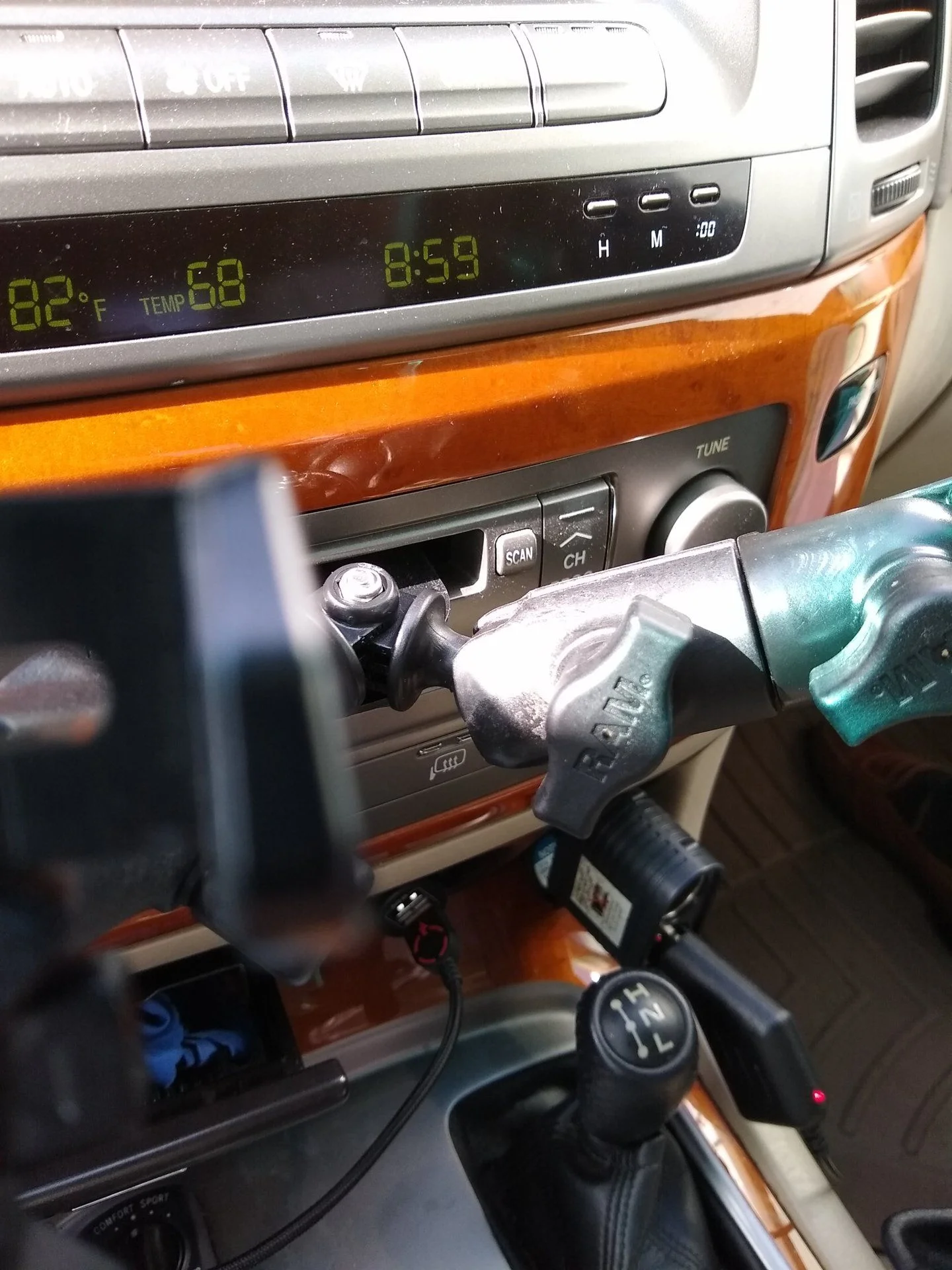

Was this just two of the angled ball mounts you recommend? Did it require a longer mounting bolt?
Yes and yes. The bolt is 3/8-18 @ 5/8 if i recall. I think you'd need an inch or more for two mounts. I believe he got that bolt at lowes
I'm using a similar setup but with the double ball mount instead of two angled balls
edit: i wouldn't recommend this and have taken it out. It isn't stable enough.
Can you post a pic? How does that mount to the media mount and let you mount something to each ball? I can't tell from the Amazon pic.
edit: i wouldn't recommend this mount though as it is not sturdy enough for a tablet and phone.
