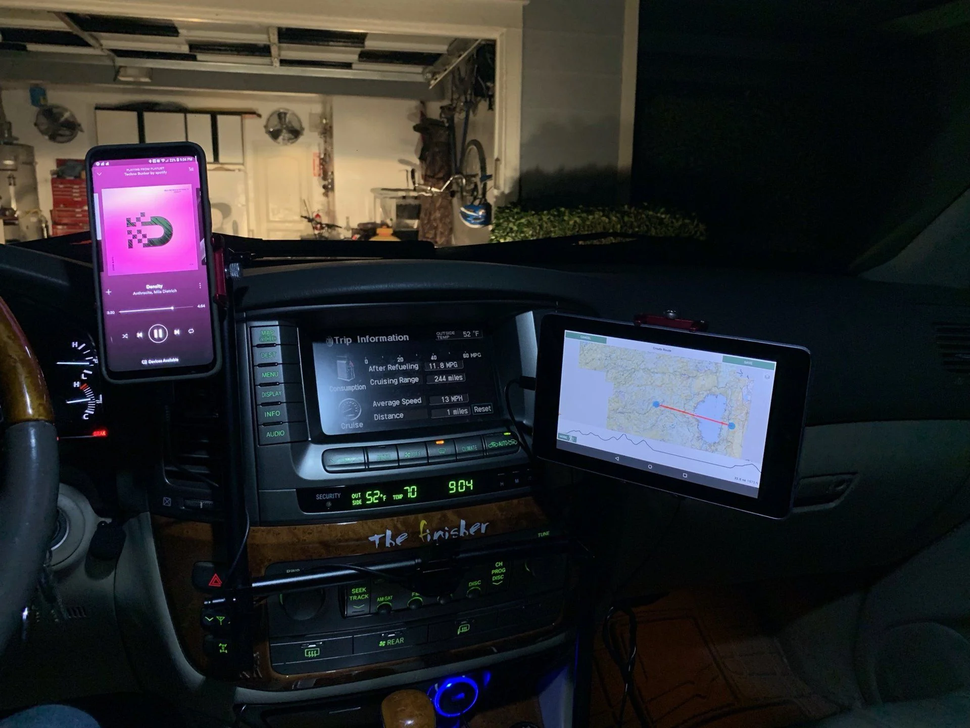

I've tentatively settled on this layout:
Mr. Young. Your layout was genius. I copied your exact set up... why mess with perfection! I'm super pumped with the layout and the quality of the Owl Mount. You better believe I installed the Owl sticker on the dash for everyone to see! If you haven't done this accessory you are missing out. Get yourself the owl mount now! Fyi... all OEM buttons and dials are accessible with this set up! No affiliation with Owl, I'm just a satisfied customer.
