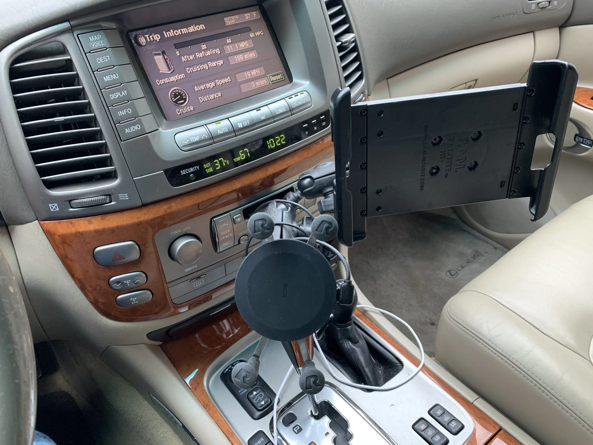

Here is my setup. I have a Galaxy Tab A 10.1 GPS, with Torque Pro and Gaia installed. The holder for the Tab A is the Ram 8", and it fits perfect. It looks like it overhangs the passenger seat, it does not. I also installed a wireless charger for my phone.
Overall, great product, @Ramathorn15, and I highly recommend!View attachment 2500174
Love it!
@Lonegrasshopper Great setup. Which double ball did you go with for the mount itself? Love mine and have been eyeing a dual setup like yours.
It's two of the balls I recommend in the product description just stacked. You'll need a longer 3/8-18 bolt to fit both but that can be easily had at any hardware store. The bolt that comes with the mount is 3/4 so something like 1" would likely work.
I used the one you supplied. It was supposed to be temporary, but It's been holding for 4 months now with no thread movement. I meant to go grab a longer bolt because I was initially concerned, but now not so much.
Oh nice! Good to hear. I never tried to double up so I just assumed you'd need a longer bolt.
The wireless charger setup for my phone is a Ram X-Grip, removed the rubber piece in the middle that says Ram Mount, applied this double stick tape, and followed up with this charger. I like this setup because I don't have to waste time plugging in my phone when I'm making my big getaway.

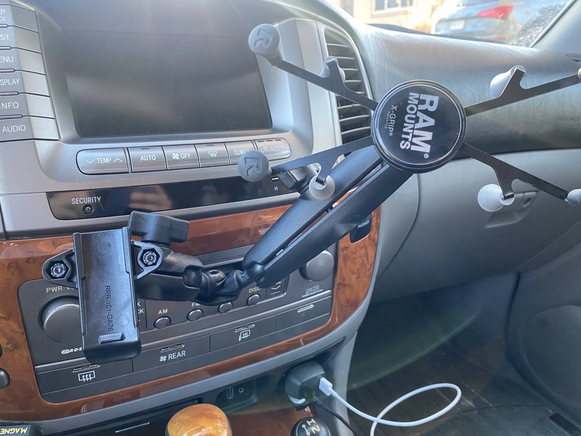

HI all.
I just ordered a tape deck mount. Trying to figure out options and I don't see my 2 questions answered on this thread so hopefully someone can help.
I'd like to add 2 Ram balls, 1 size b for my iphone attachment - and 1 size c for a tablet mount. Is it possible to use a size c ball attached directly over the provided owl mount hole with the recommended size b 9mm angled bolt head stacked below the size c ball (using the bolt on the size C ball to secure both balls onto the Owl mount)?
Also, has anyone use a Ram flex rod off the owl mount for an iphone attachment? this would allow a lot of versatility in positioning but perhaps it would move too much when driving off road?
HI all.
Not sure about the ball mount question, I used 2 size b. But I would't use any sort of flexible arm. There's a lot of leverage going on with an extended arm and a tablet/phone. Considering going to a shorter arm for my ipad mini for this reason (no fault of the owl mount).
Roger that on the flex arm - I figured as much.
For the ball mounts, Ram suggests size C (1.5 inch) for tablets and I think estimate 4 pounds for off road use with a size C, vs 2 pounds with size B, thus was hoping to try the larger size C. Looking at your set up I expect there is not enough space for a mount to go straight up.
If anyone has the measurement from the face of the stereo to the middle of Owl mount hole for one of the current versions of the mount, that might help answer whether my idea is doable.
I'll be sure to post if I do try my preferred approach...

Just following up after finally getting everything installed. I ended up doing 2 size b mounts - 1 for ipad and 1 for iphone, as in the photo from pili's post above. It would be nice to have a little more weight capacity for the ipad, but the 1 inch size b worked pretty well - only slight movement for the ipad. I could only find one option that might allow use of the size c mounts - a Ram 3 ball triple adapter. You would have to cut one of the balls off to fit the Owl Expedition media mount. Even then not sure whether it would fit, thus I went with the 2 size b/1" mounts.
Having the ipad linked to an Inreach mini to provide GPS location for the Gaia map app was a life saver when exploring new areas. I ordered direct from Ram Mounts, and they couldn't deliver in time so I cancelled the order. OC mounts had everything in stock and was about 10% cheaper, even including 2nd day air to get it in time for my trip.
Also, shout out to Rami at Owl Expedition...appreciate the quick reply to my questions. Excellent service!
