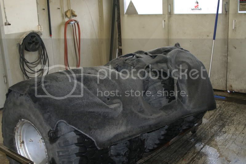

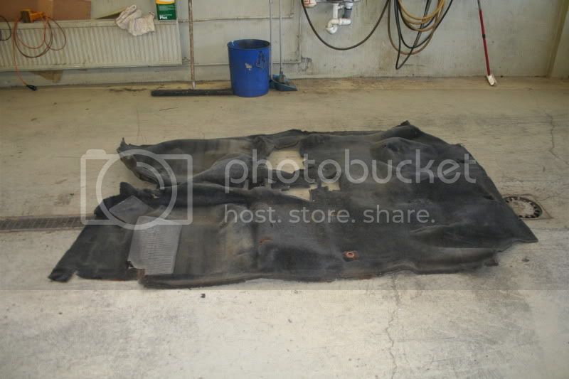

Cleaned the carpet. Soaked it in soap water and pressure washed it. I´m hoping for a bit cleaner carpets according to all the brown water I washed away.

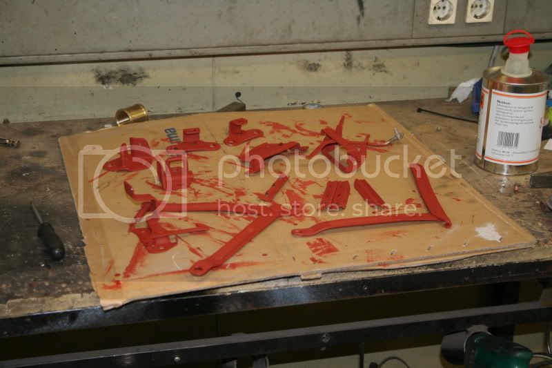

Primed some small parts, I had already sandblasted these parts.

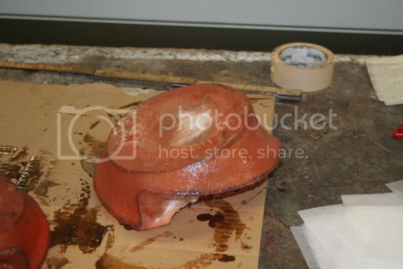

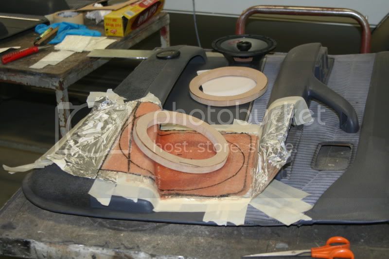

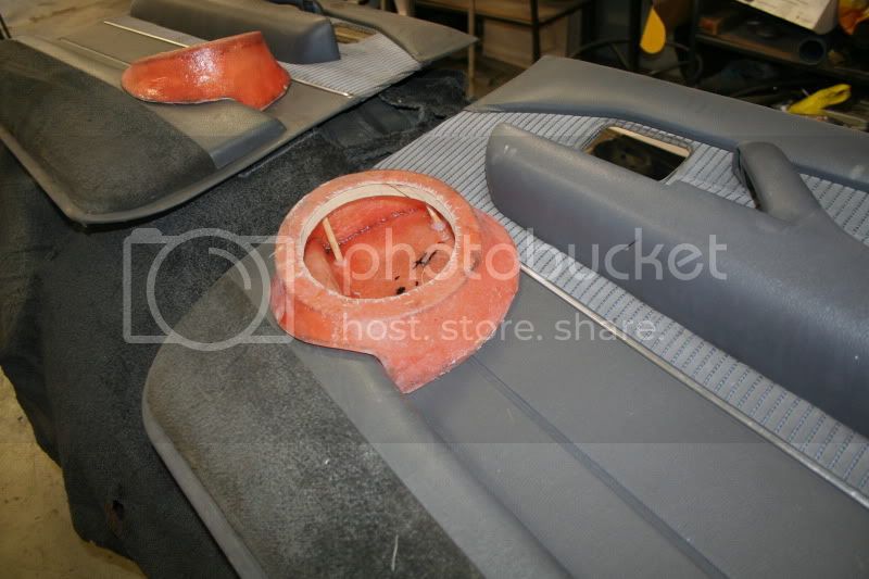

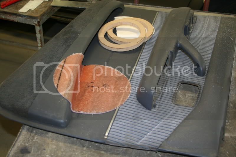

I also started working on the front door speaker pods.

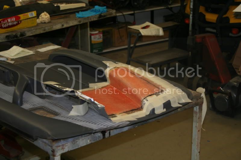

Started by making molds off the front door panels where I want my speakers.
Also made two MDF rings that fit my new speakers and figured out where and how I want the speakers installed.
Then I cut the molds to fit my design.

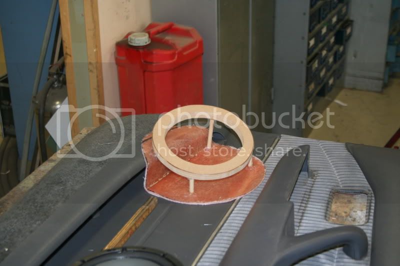

Glued the MDF rings, made the speakers tilt a bit up and towards the rear.

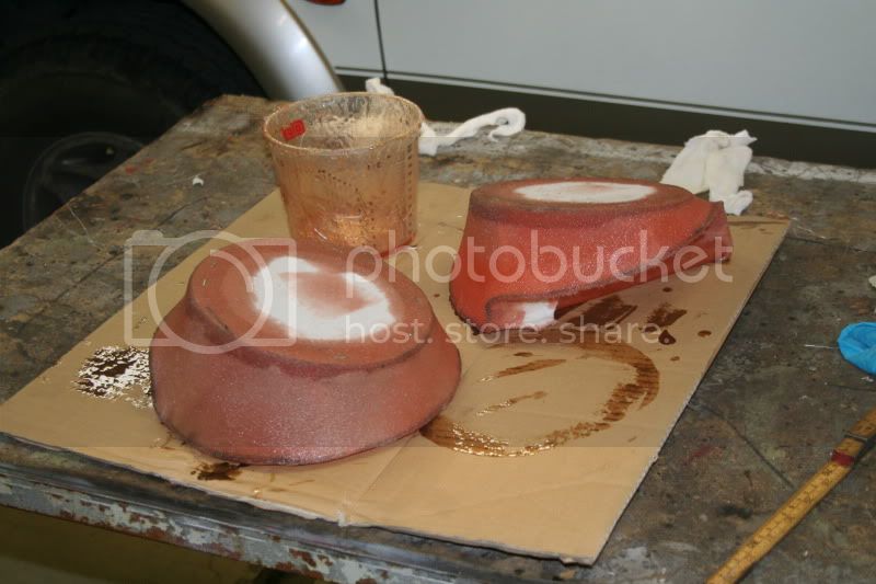

Coverd the pods with fabric and wet it all with fiberglass resin.
Added one layer of fiberglass mat and now they will dry till tomorrow.

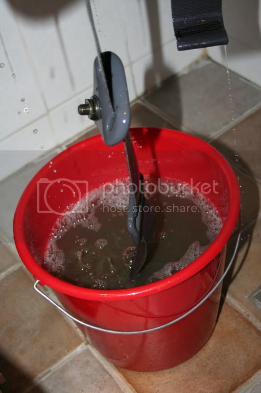

Yesterday evening I removed the front seat belts from the rolls to clean them and added a few rings of tension to the rolls.
When I came home today the water looked like this. 20 years of dirt from the front seat belts. I guess I will do the same to the rear belts.
Did a little more work on the speaker pods to day. Now I have to decide if I will cover them with vinyl or carpet. Then I will see how much sanding and filling I have to do.

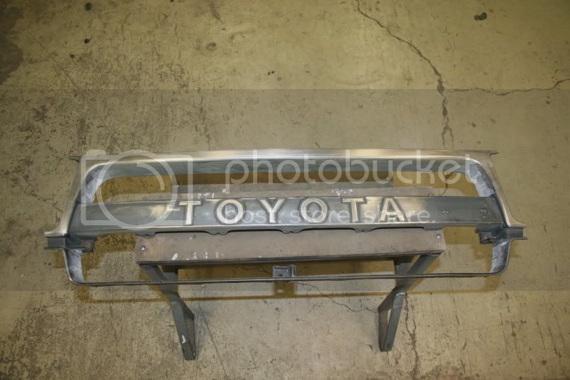

I also did some sanding work on the grill and the chrome frames around the headlamps and side markers. All chrome pieces will be painted.
I´m going to do some kind of mods to the grill, i´m just not sure how it will end. I was thinking of stealing this mod but i just might make my own version of it. I think I want to keep the Toyota logo and the Turbo emblem in the middle of the grill.

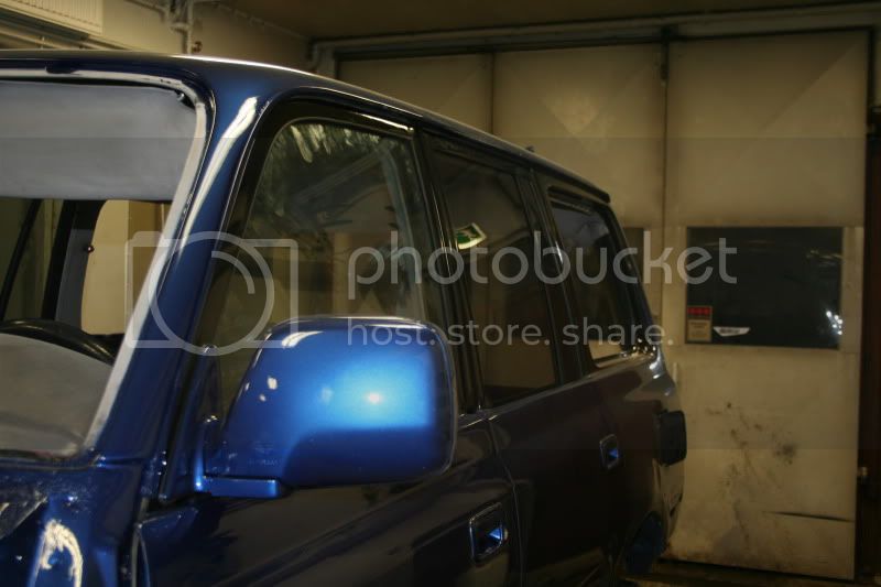

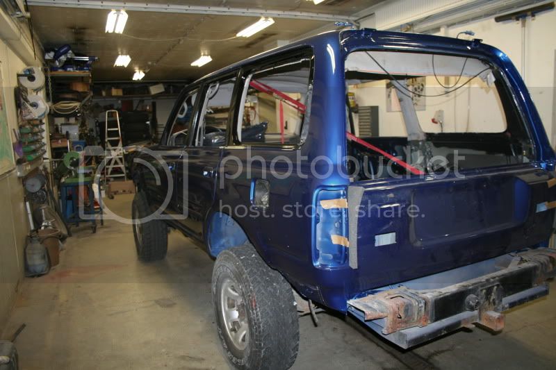

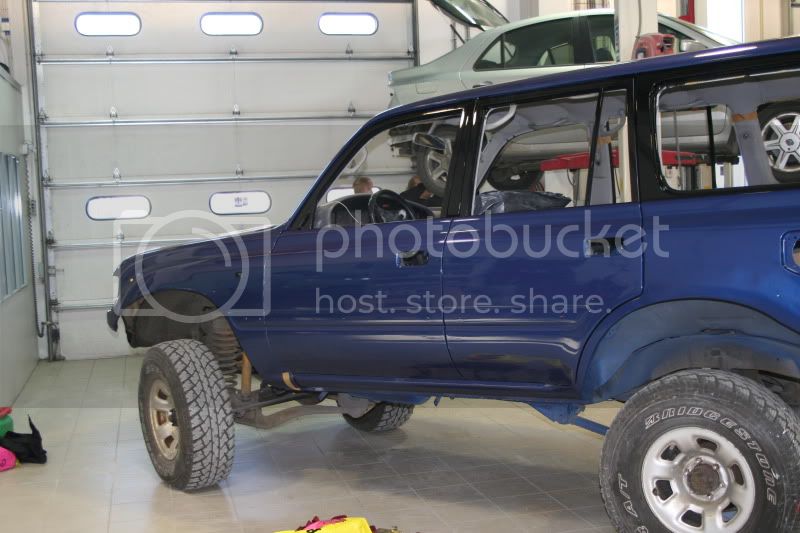

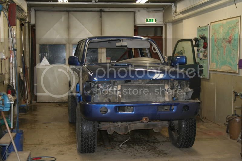

Had a little progress this evening. I glued sound proofing material inside all four doors and then installed the electric window mechanism, the wire looms, the mirror covers and all glass into the doors.
I also got the front bumper and all the fender flares from the paint shop.

Man, that's a really cool blue. Awesome choice. Love the fiberglass work and enclosures. Cool to see stuff that is out of the norm. Really interested in keeping up with your build.
