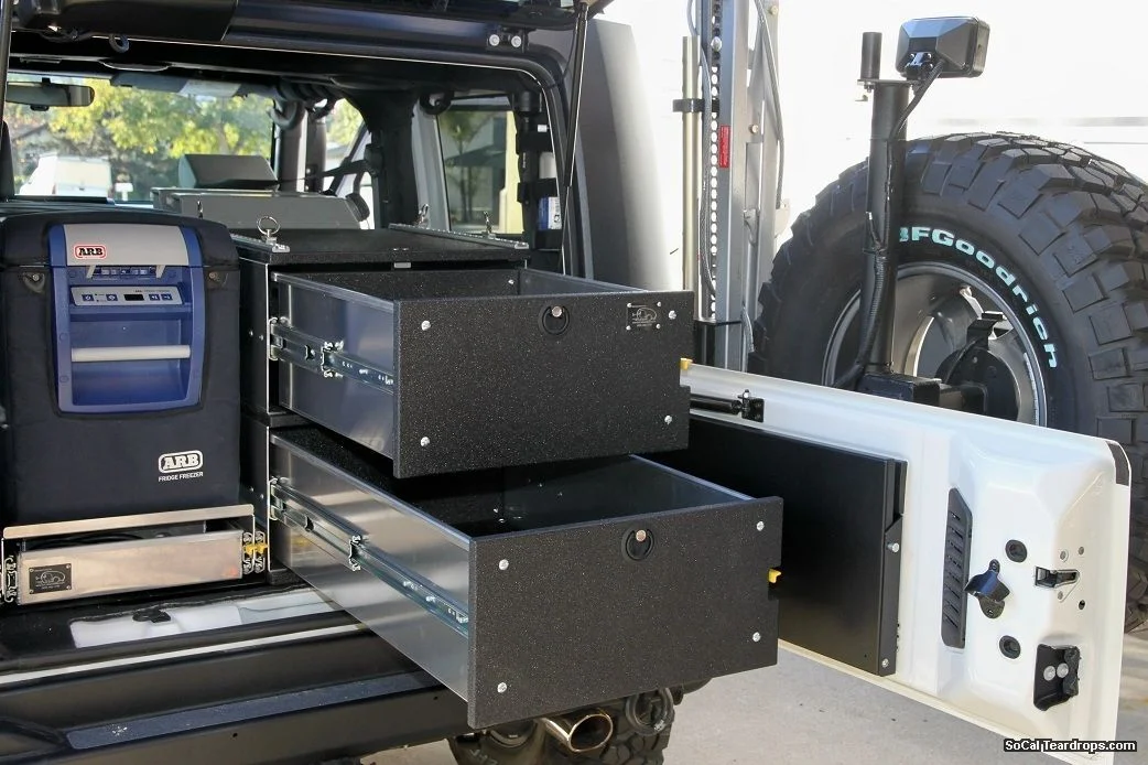

To install different slides, I would just remove the existing "skateboard wheel" bearings. Accuride 9307 slides are 0.75" wide by 3" tall slides... and it looks like there is enough room to install on the upper half of the fixed top drawers. There may not be enough room on the roller top ARB drawer though.
The lower half has the existing horizontal bar/slide that I'd leave in place. Would need to trim a little plastic and metal on the drawer face. Basically would look like the SoCal TearDrop drawers in the 2nd pic.

Those look sharp ("visually appealing" sharp not "capable of slicing off your finger" sharp, although there is some of that also).

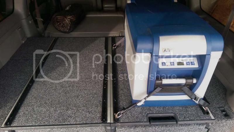

Does the roller floor drawer come with some form of fridge tie-down? I will most likely go with a set of L-track like in the SoCal Teardrop picture above, but need something short term. I am planning on using the drawer top nutserts with longer bolts to secure the track as I don't want to drill any new holes yet. Are these a strong enough mounting point?

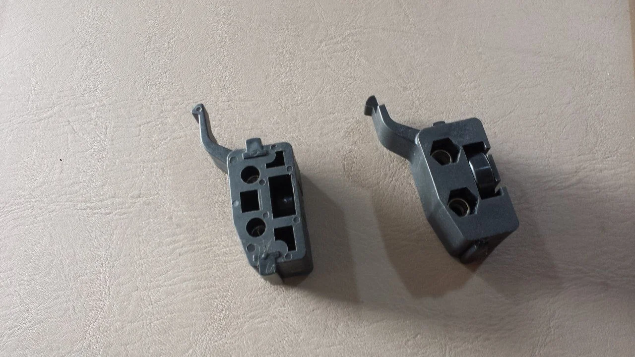

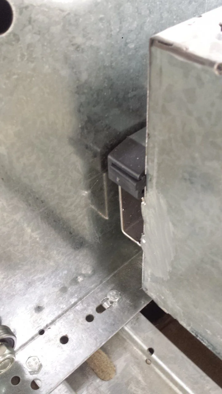

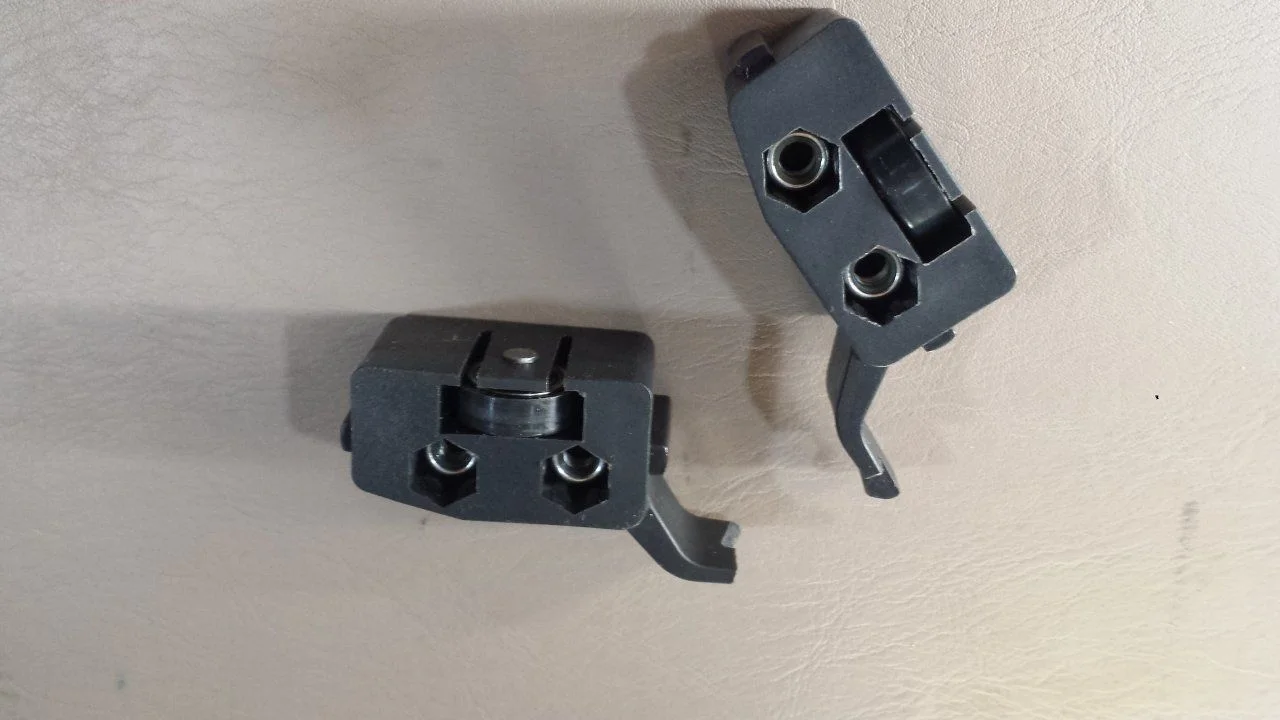

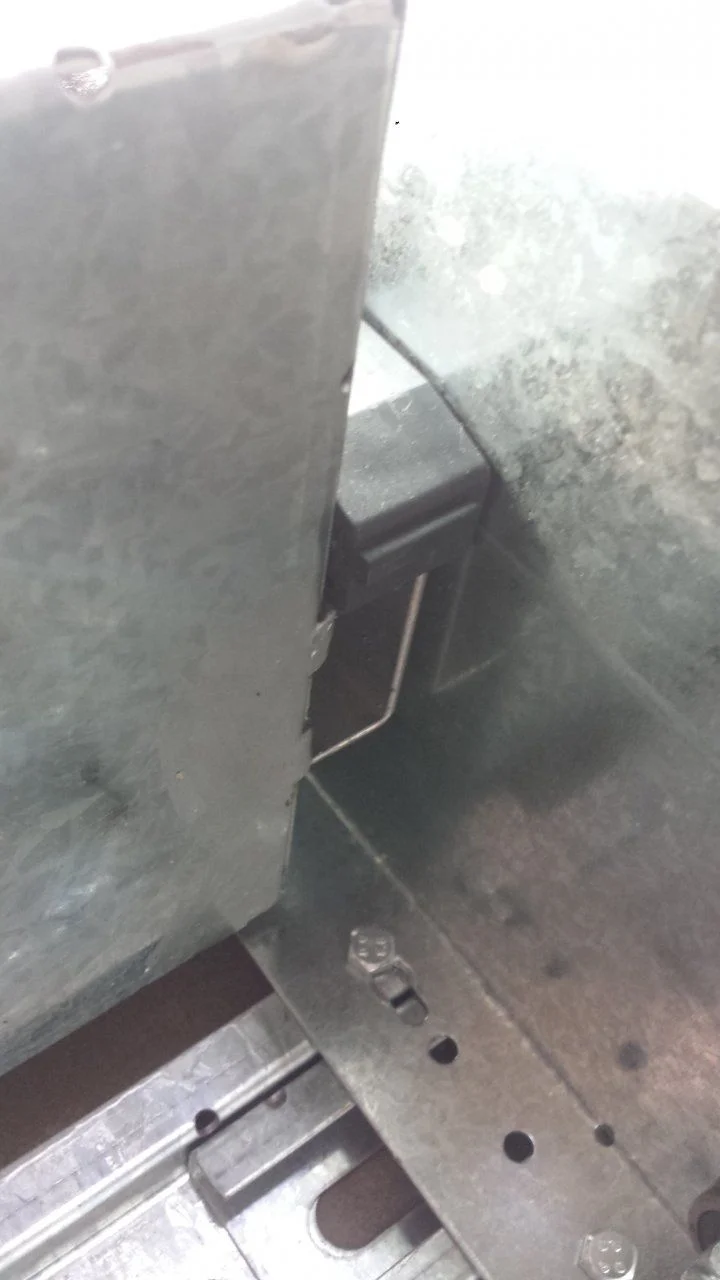

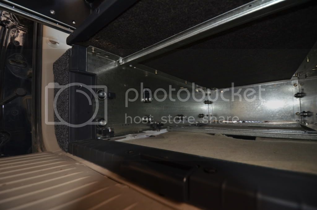

I received my slide locks from ARB and installed them so I thought that I would post a couple pictures here in case it help anyone in the future.
These are the locks that hold the slide in the open position.
These first ones are the new units.
In order to replace them, you will need to remove the panel from the top of the drawer, commonly referred to as the floor.

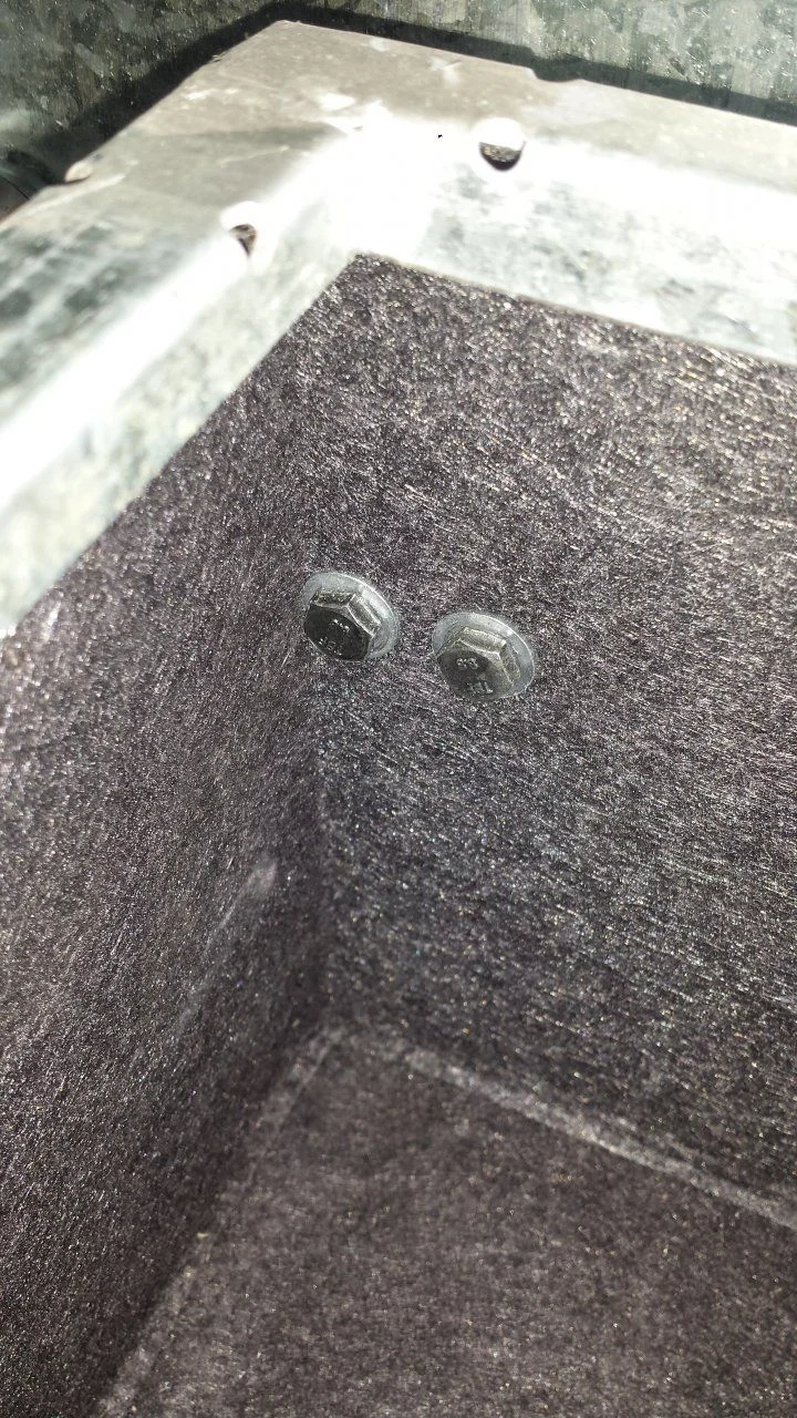

You will also need access to 2 10mm bolts in the back of the inside of the drawer. Here is where they sit on the outside of the drawer.
Here are the bolts.
And finally the old broken stop lock compared to a new one.
I ordered a couple extra of those as I know they are prone to breaking.
I also use the ARB tie-downs, but i have aircraft track down the length of the drawer on both sides of the fridge and also on the far drawer
How did you attach the aircraft track to the drawer top? I bought a few strips but the holes aren't even close to lining up with the nutserts. I can drill new holes in the rails but the countersink drill bit won't fit in the narrow sections so my drill locations are limited. I could use button head screws but that means I wouldn't be able to use an anchor in that position, no biggie I guess..
Would love to see how others mounted tie down track as I am in a bit of a dilemma.
I just used a drill bit and a counter sink bit to line up with the holes in the floor. I did use a die grinder to cut off the tabs where my bits wouldn't fit. I only had to cut a few tabs. I still have plenty of anchor positions. You can see pictures in my build thread.
I got it figured out. I ended up drilling new holes so that I could countersink the two outer ones. The middle ones happened to be in a narrow section so the countersink bit wouldn't fit. I used a regular button head screw for those positions. Just means I can't use an anchor in two positions per rail. Not a problem as there are plenty of others.
