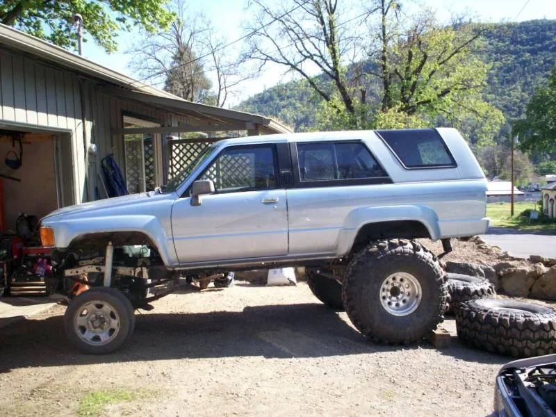

alrighty then, got the diff measured as promised looks like 14.5" at street psi and no drivetrain.
got my tcases back together, 23 spline front input crawl box, to a marlin total spline 21 spline 4.7 gearset. marlin ran a special on the triple drilled flanges last week and i picked them up for 10$ a piece :smokin:
i also left the interlock pill out of the rear case so i can get 2wd low low.
should be about 118:1 total reduction from the crank to the wheel.
the cases show where my OCD kicks in...... damn near clean enough to eat off. okay totally clean enough to eat off of.

i think its also deceivingly high still.
i hope to have the drivetrain installed this week to get a better idea of real height.
in theory, it should be the same as the pick-up was.
the suspension is under a 5" lift, the BL is 1.5".
my sidewall adds another 6-8" :rolleyes:

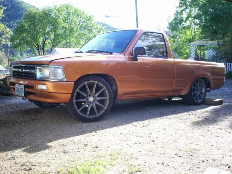

Looking Good, your a busy man! I like the Mini, reminds me of my old one. Gotta love the look of a clean shave... Why the 2x behind L rear tire? you missing a Motor in that thing?
