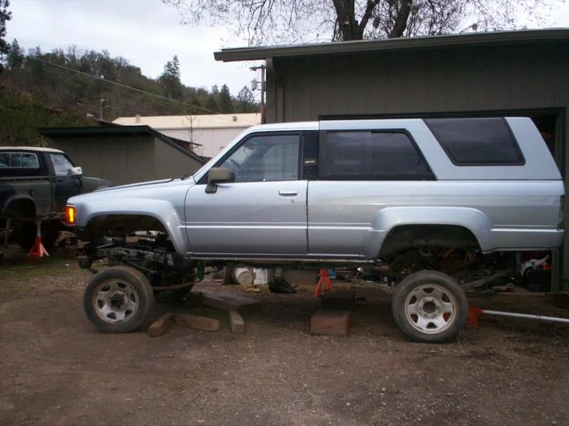

some progress, its been slow with the weather and my attitude.
made the rear hangers out of 3.5" by 3/16 wall box. welded washers to the inside for strength and to close the gap some. holes are drilled with 3/4" holesaw.
the front eyehole is about 6.5" forward of the stock hole. the distance from the front hanger eye to the shackle hanger eye is 54 1/4" (using Marlins 56" spring with a 4" eye to eye shackle)
measure from the axle center to the front spring eye is 26 3/8 at ride height
need to go ahead and weld these out, i wanted to make sure the axle was centered alright before burning it in. looks okay to me.
after i weld it out tomorrow i will put in the front axle and bolt on the 42s for a better idea of actual height. this is with the 1.5" BL installed but not bolted down.
