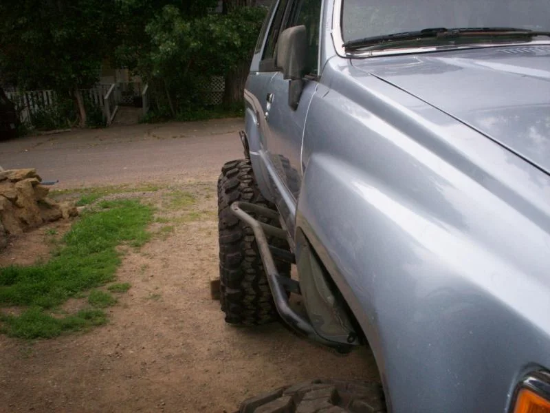

truck is going to my pals to get some welding done, i dont have time right now.
hes welding the sliders, rear bumper, box mount, the crossmember and seat mounts.
i am really going to make the pre run with it.
this weekend.
truck is coming home tonite.
sliders, rear bumper, crossmember and steering box mount all finished.
i will have more pics later, just a lot of little BS stuff so nothing interesting.
