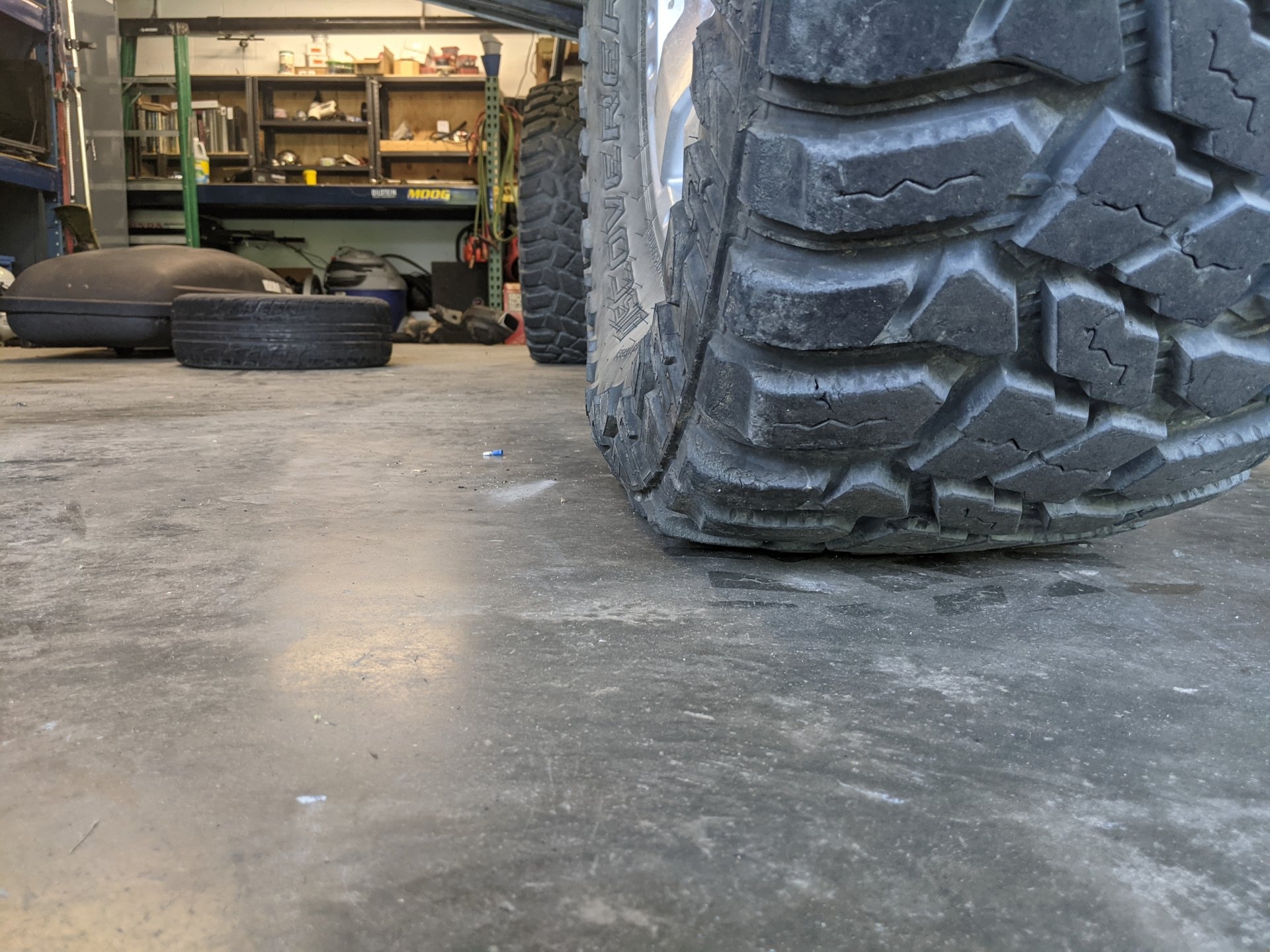

Dragged my shyt out to Ashland and swapped to some new SORD front springs. (rec by Justin Reese)

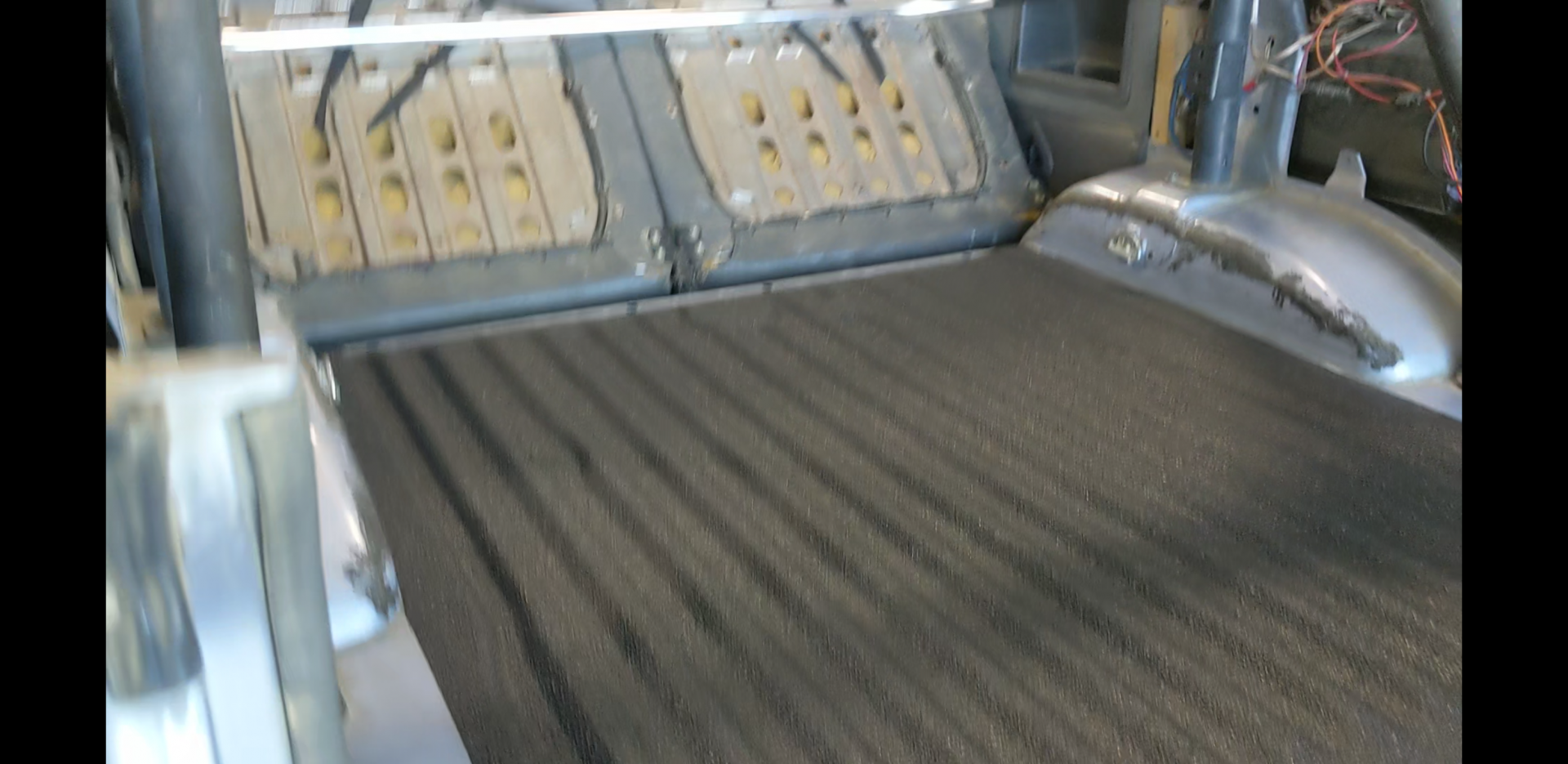

We also did some Raptor liner to the bed in lieu of my old rubber mat(47lbs)

These new front springs are much better than the old clapped out RUFs.
They have significantly more compression and are way more stable on road.
