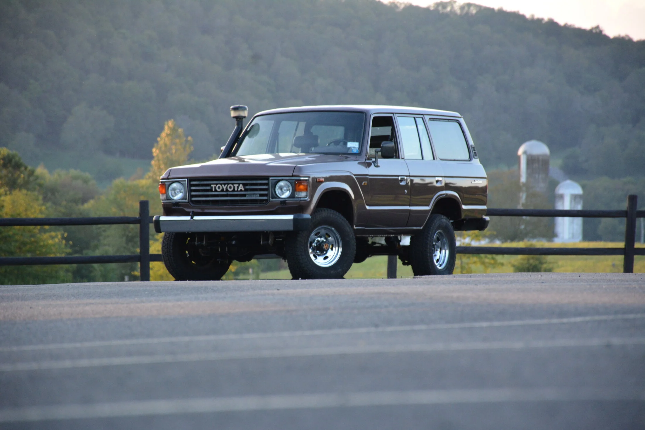

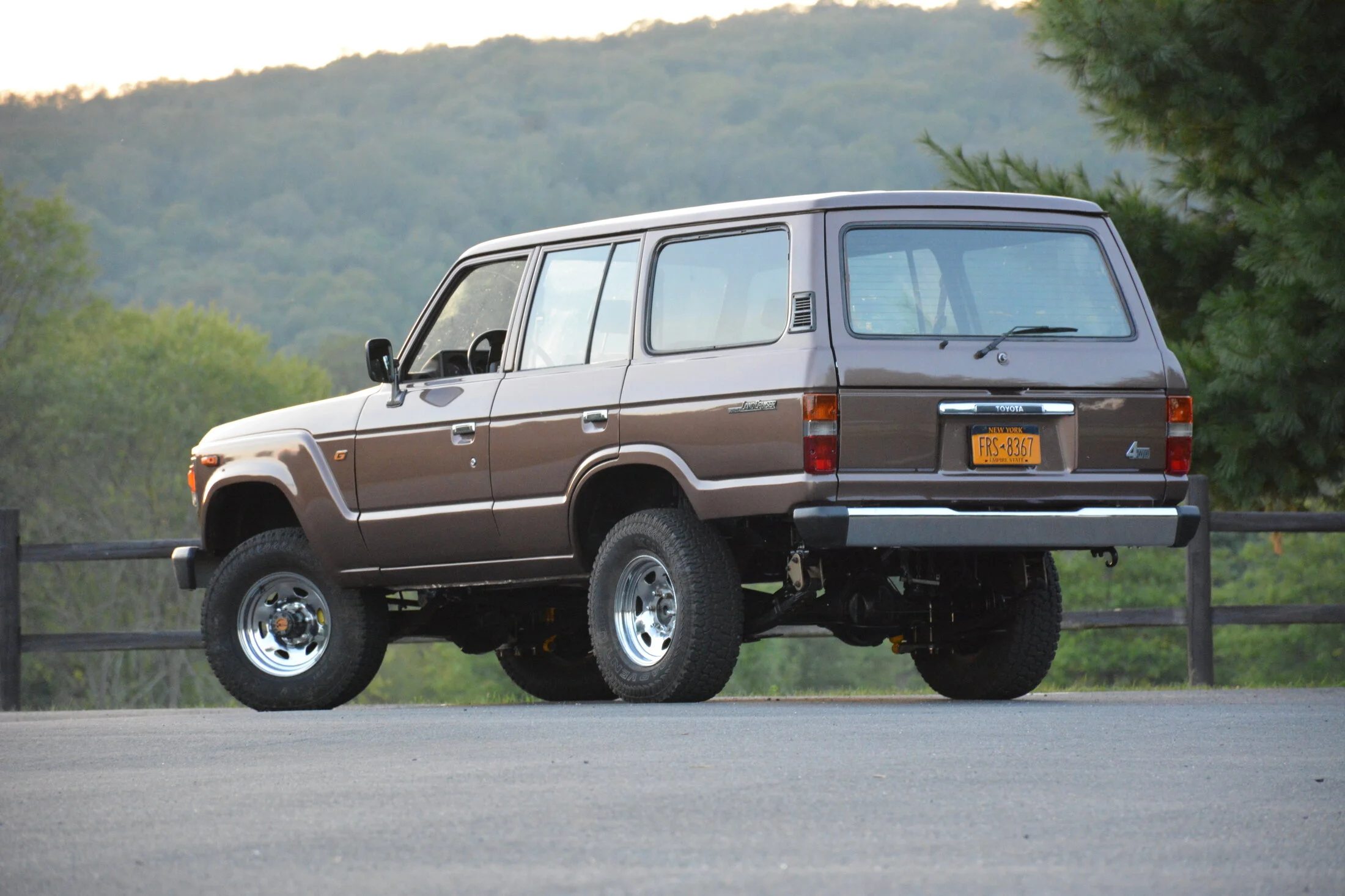

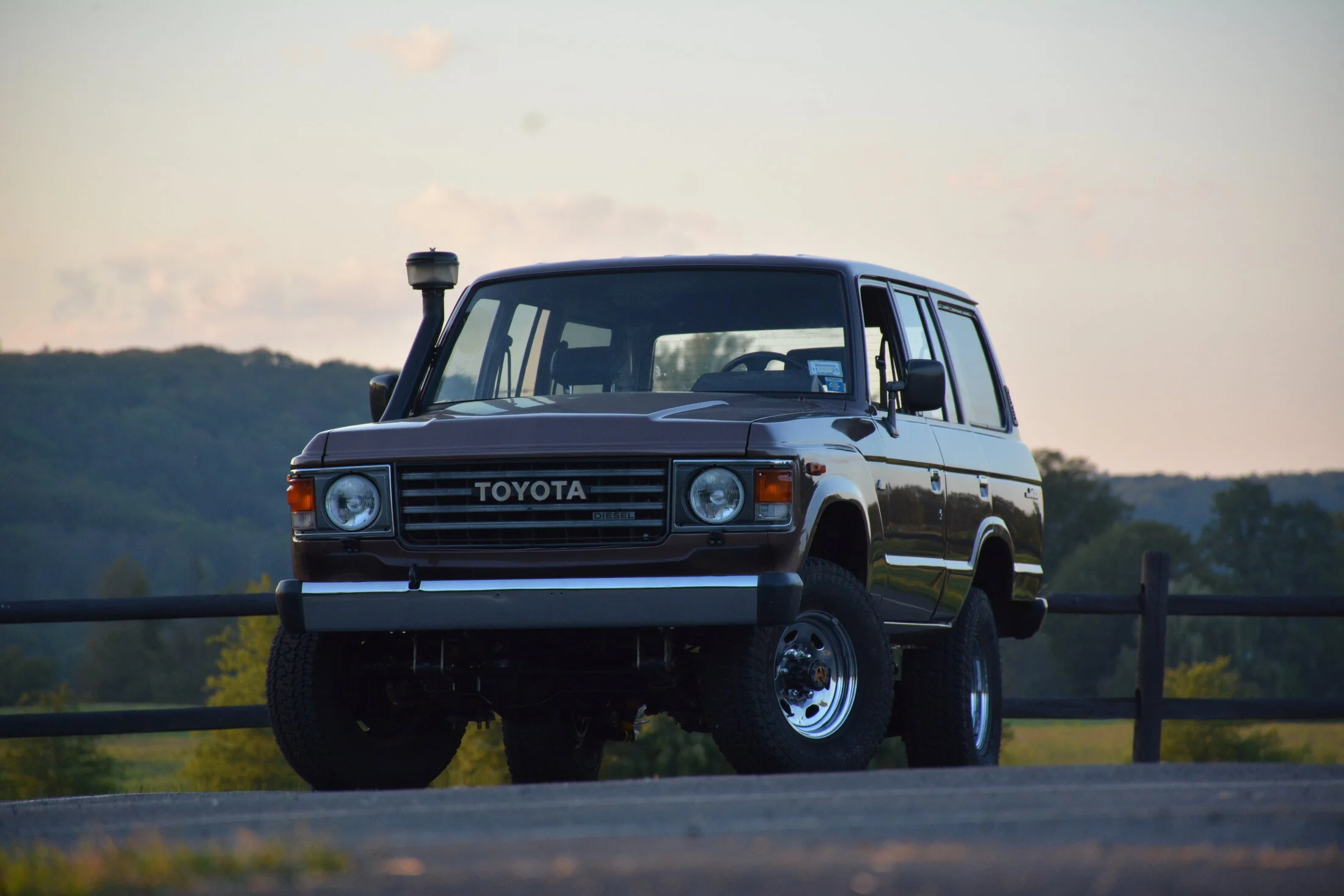

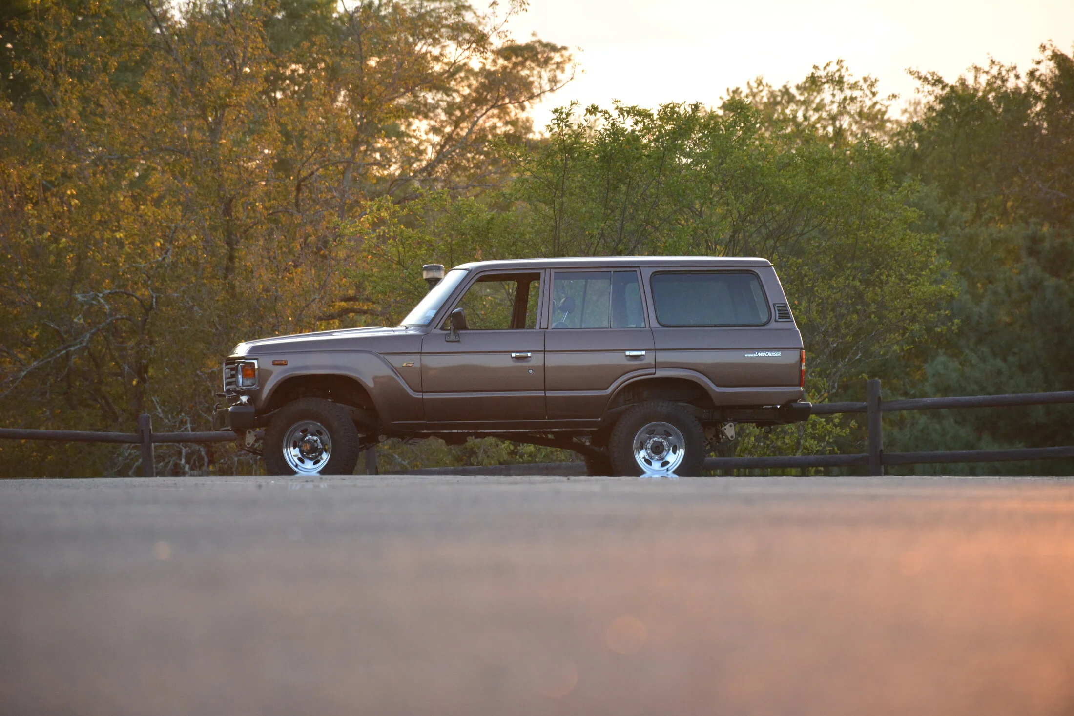

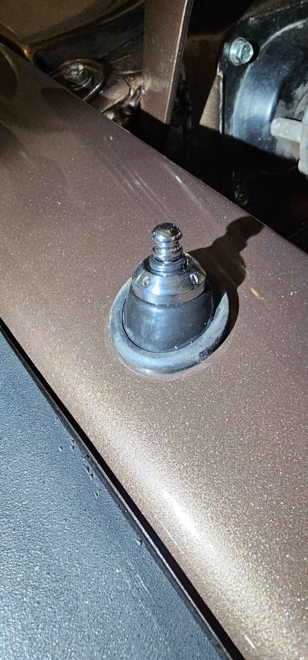

I went out this afternoon to see if I could take a couple pics.

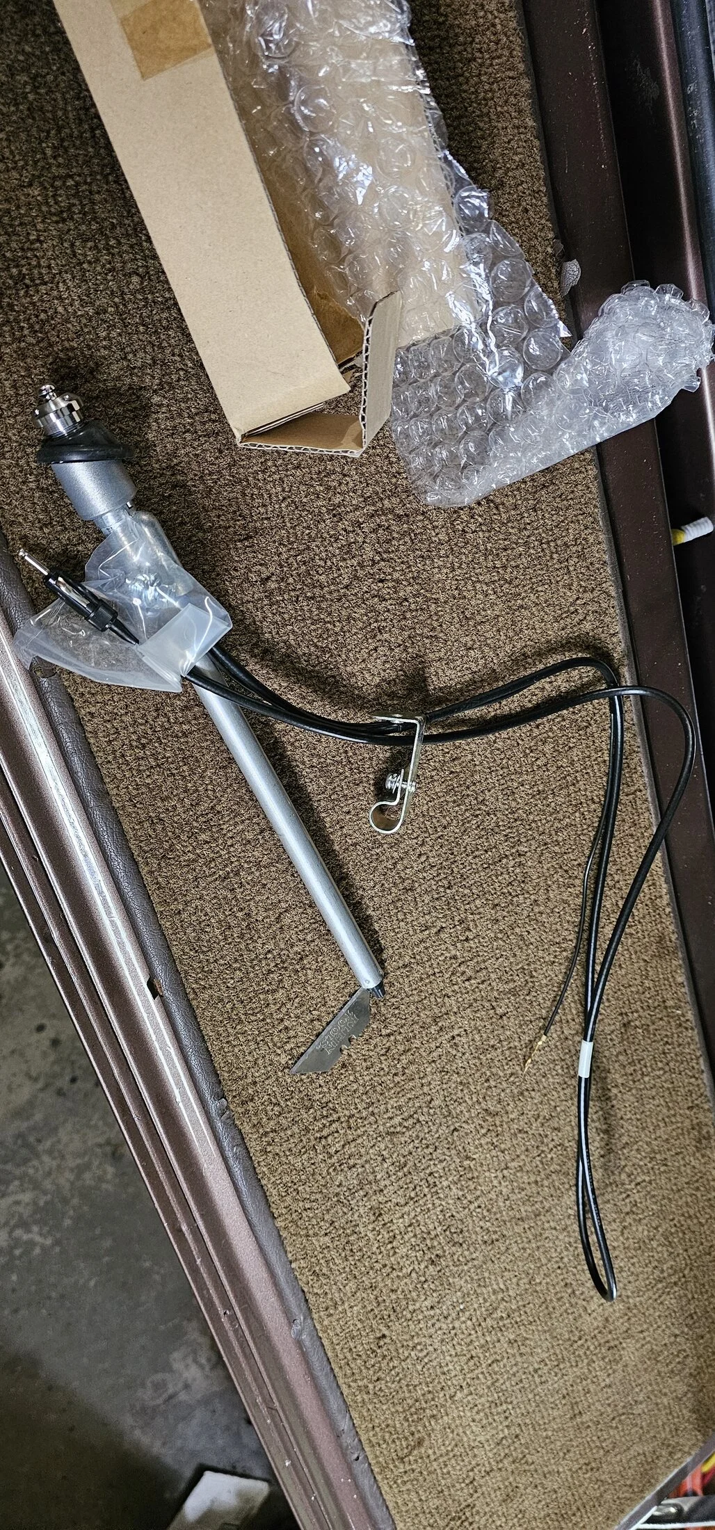

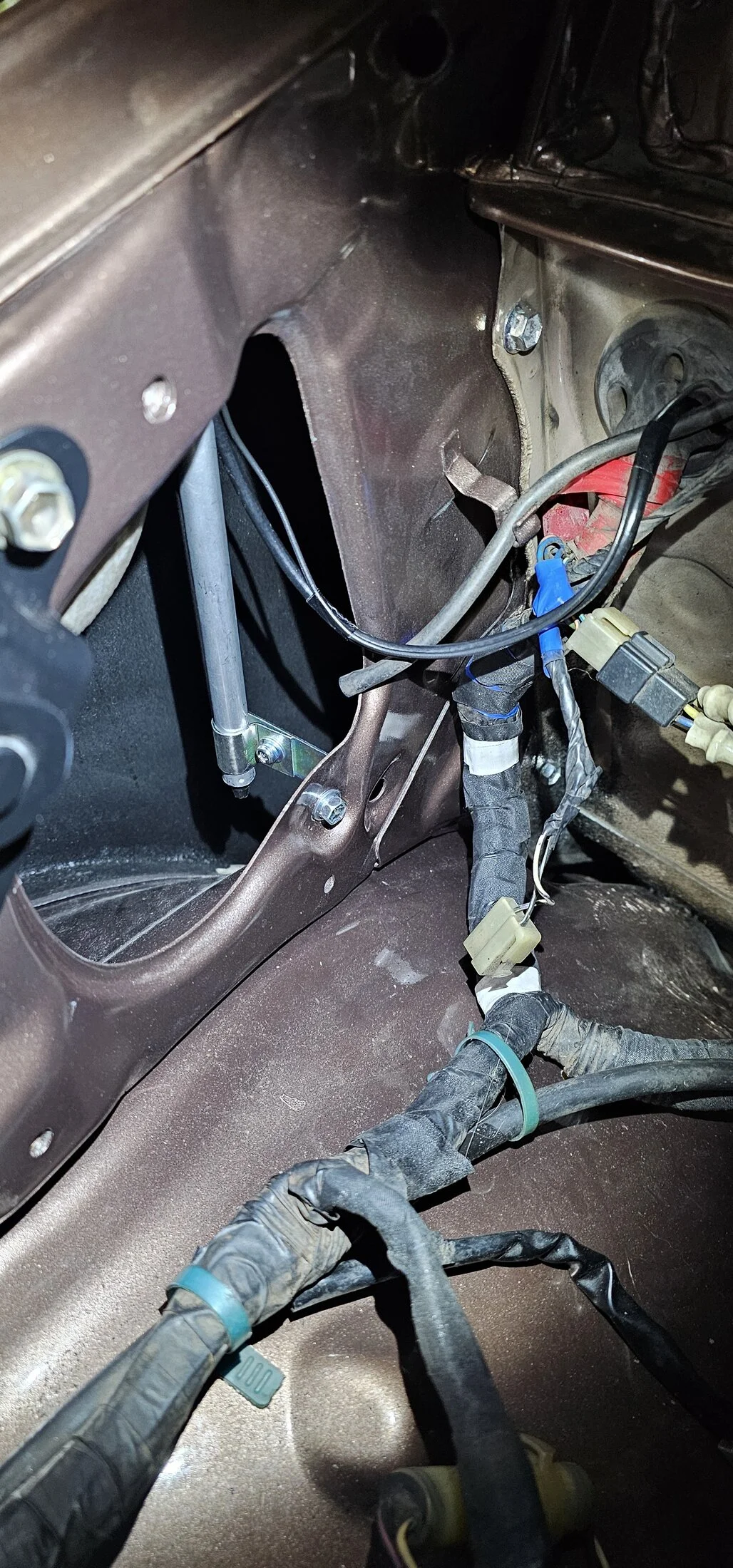

wow that looks so much easier on a 60 than a 70, just did mine....wasnt fun
Tidying up the last of the remaining things to do here. Namely, installing the jack mount in the rear quarter and the jack, putting the quarter panel covers in place, and replacing all the lug nuts with new units. I have left one of the issues for last and that is, my t case won't shift via switch to 4wd. Now I know of @Spook50 's writeup, but before I do anything like that, I figured I'd do some diagnosting.to try and retain everything factory. Here is what I found when depressing 4wd button.
