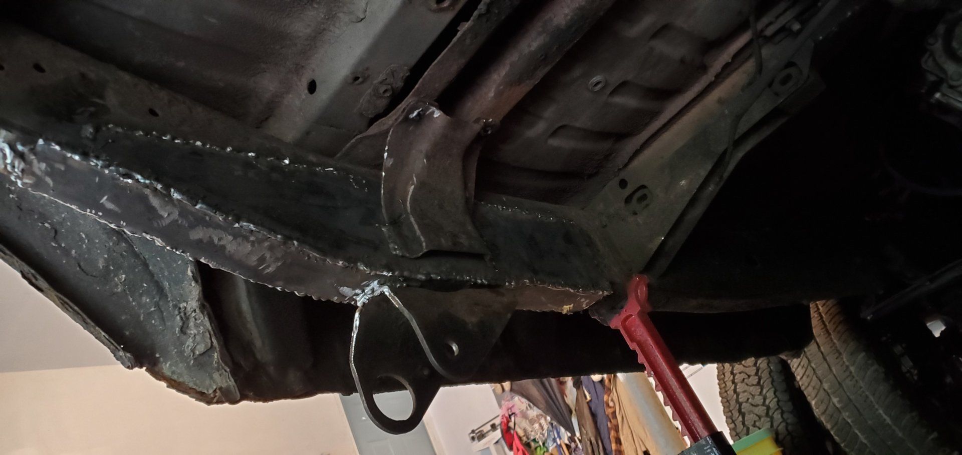

The axle had been put back together with a used spare, courtesy of cruiser parts out in NH. Today, for father's day, I figured I would resume work on my truck as a gift to myself. I cut the cross member gusset on the pass side so i can access the chassis at the perch, just like the drivers side. While this side is bad as well, its not as bad as the drivers side. Who am I kidding, it's just as bad..
In the pile of crap u see on the floor, u can see what appears to be dog food! That's what came out of there. Im thinking mice carted it in the chassis.
Then, I cut up a patch out of the steel I bought and proceeded to try and weld it on. That is when I realized that my welding skills suck so I started practicing.
The two bottom welds were my last two. I then ran out of welding wire...so I am going to pick some up to get some more practice done. I hope to get this thing back on the road before summer is over.
Finally got around to getting some of the chassis patched up. I laid some bird poop in the process, ha ha ha
Welding upside down withan entry level welder is very unforgiving. I mat d9 some more passes in places, but i am satisfied with the repair because of good penetration. Now i just have a little work to do on the other side and then reassembly. Pheeewww
Im not even going to fight it anymore. I am just going ro enjoy the truck once back on the road. Thats it. The mechanicals are great so....i will probably cut and patch as i go.

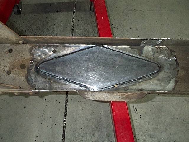

I'm not so sure your patch is structurally strong enough for the springs. I'm sure better than the old rusty frame..
But I think it needs some better overlapping patches. I would add a diagonal type of patch. Over the old, onto the new. I might even put some angle iron to form the corners. Your welded edges need some over laps. Grind somewhat smooth, put angle iron over, and re-weld on the angle iron.
Spring perches are normally also riveted to the steel, Did you bolt it on? I would not want to trust welds alone here maybe.. unless you are 100% sure of a strong weld. This picture is found online. It shows an angular patch. I would do a few of these.
Yes, so I made patches for the holes I cut then overlapped the large piece over. I will do another weld pass in places where it looks crappy. Other than having someone else weld for me, I can't think of another solution. I also have a spare frame that I will eventually swap over but for now, at least is better than it was before.
