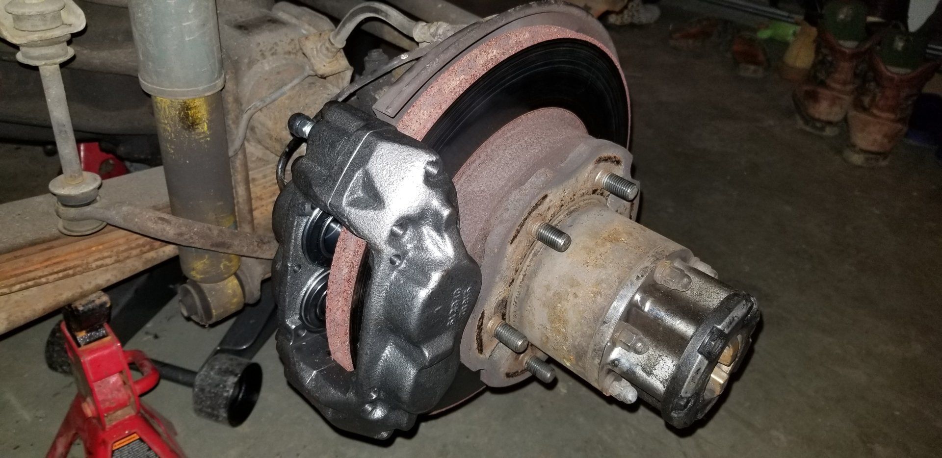

Right, so she is fixed and back on the road! What a feeling it is to be driving it again! I do have a front caliper acting up, tsk tsk, disuse kills these things. Now onto more work.. pics and video to follow.
