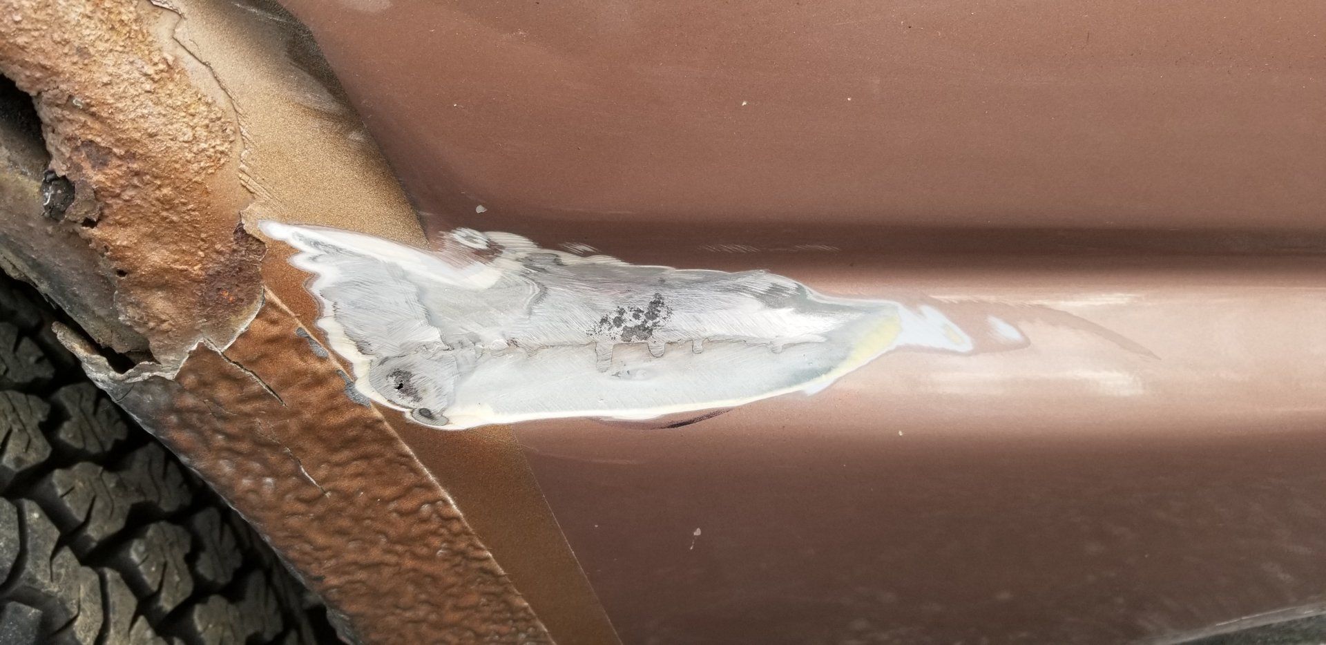

And after replacing the rear cylinders amd getting the brakes sorted, i decided to grind some of the bubbling paint off, to prime it and stop the rust from progressing. I was appaled, to say the least !!! This thing is bondoed to death!!!

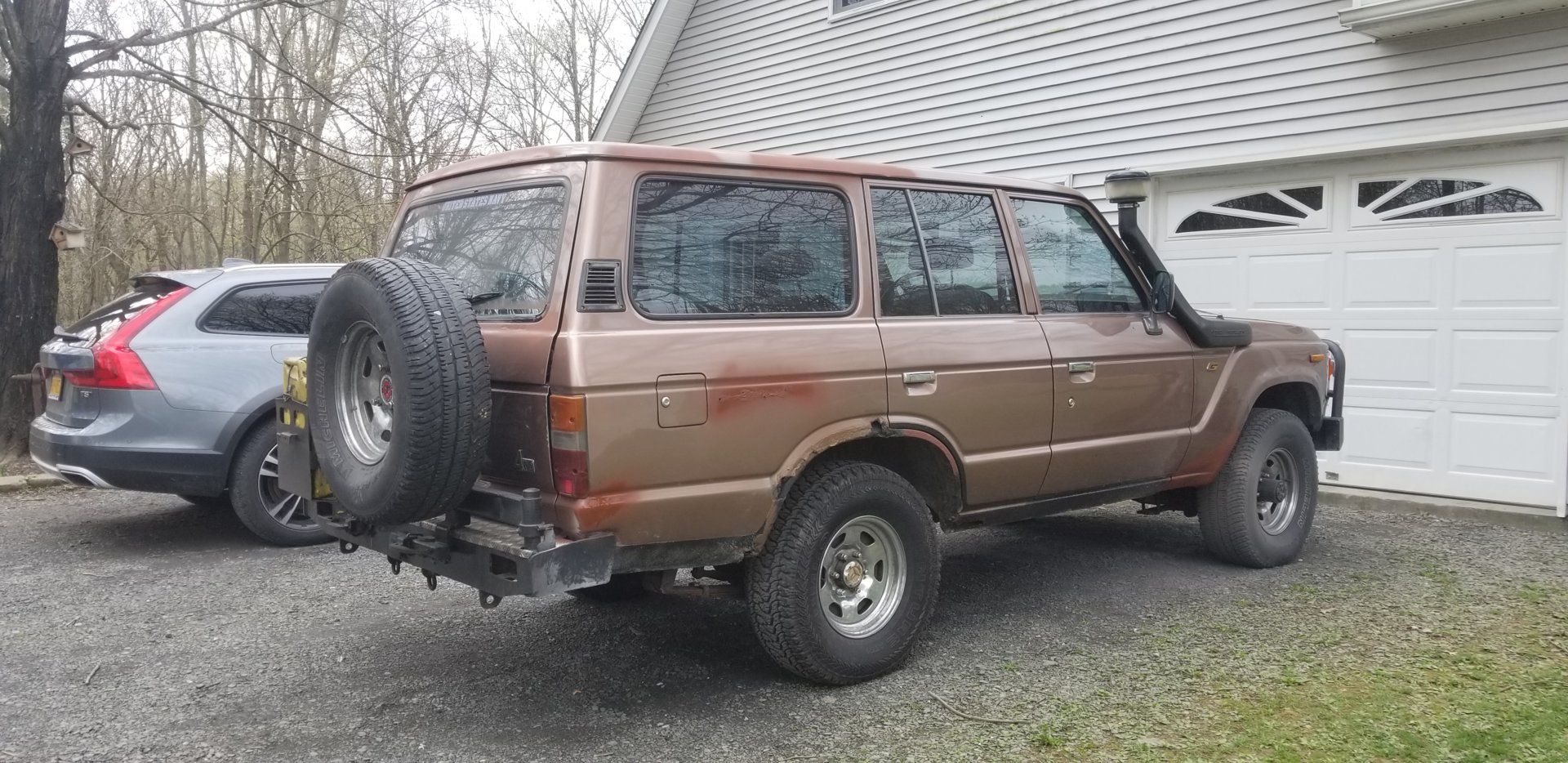

That's exactly what I plan on doing. Can't fix this professionally, too far gone. I have a welder, plenty of flapper wheels and I simply plan to just enjoy it. I would however, given the opportunity, do a body swap if i could find a rust free one. I guess I'll just keep on fixing as i go...

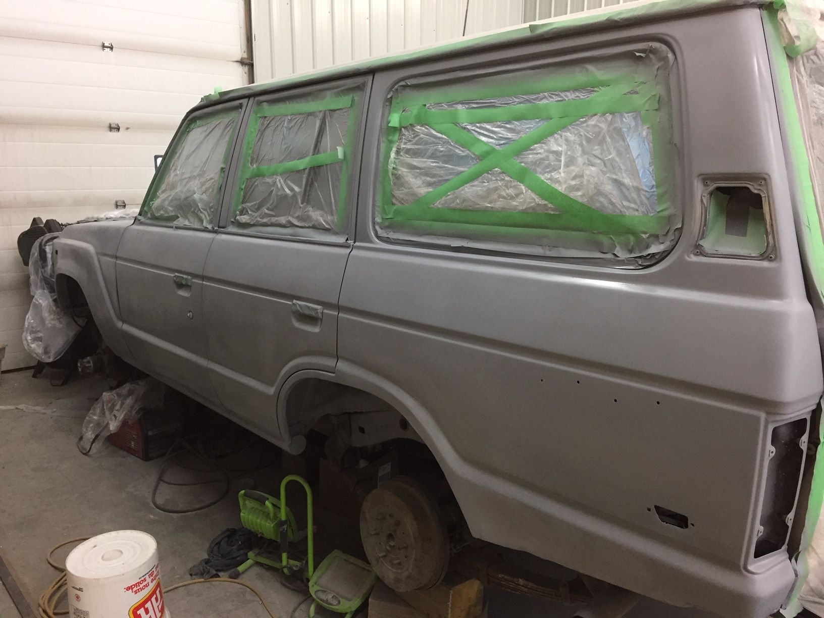

Okay for some motivation. I bought quarter panel kits in 2007, and installed them. They rotted back out and now this year I got to re-do it.
The rear portion of Left hand side quarter arches were rusty, so I cut it out and used a finger type arch repair piece. I welded it in spot weld style. I used a fiberglass bondo, then a little smooth bondo to make it shaped. Not a lot of filler, but yes it needed it to make shape. I was able to shape the metal.
I would not call this an ideal repair. But I did cut out the rust and will hopefully get a few more years before I do it again... Maybe even one day I will turn it into a ute.
Have a look at these pictures for yah.
In my pictures you can also see my new tube rocker panels. I cut out the rockers and put in tubes.

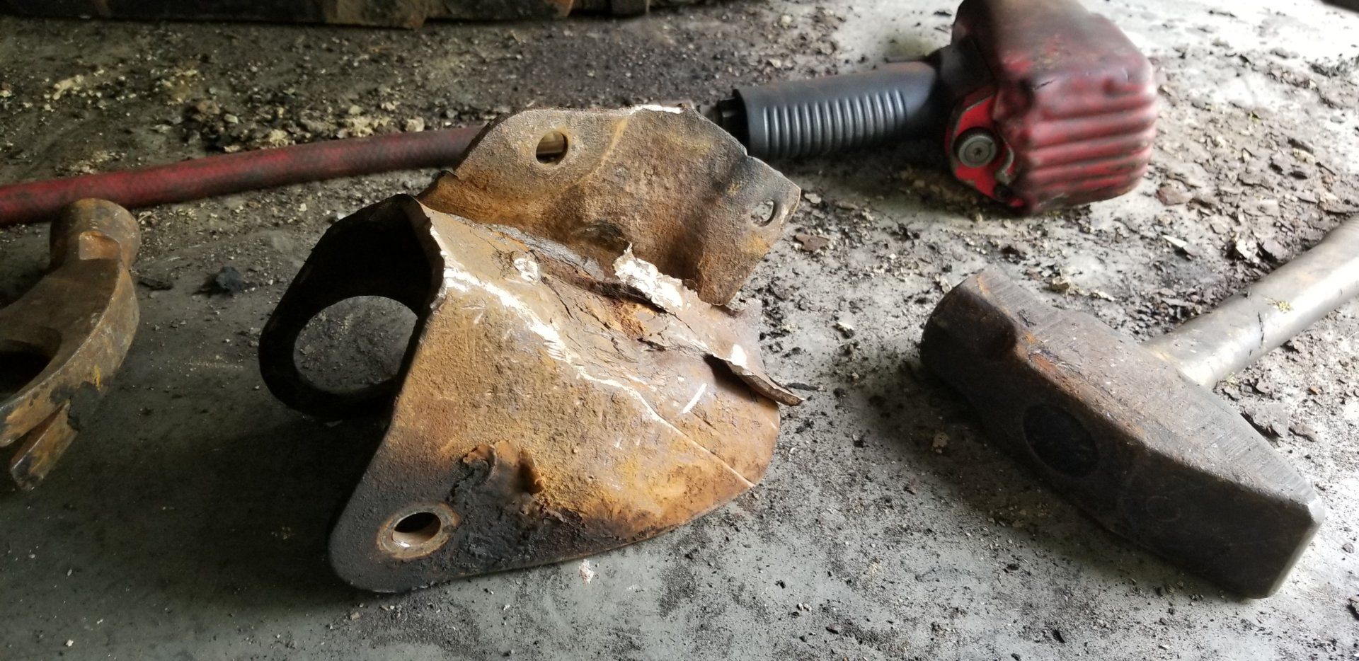

So today I dug, or wanted to dig into the damaged areas of the frame. I figured it wouldn't be too bad. I then realized the extent of the issue. I am now in the process of removing the rear axle and so on to fix this thing. See below...
