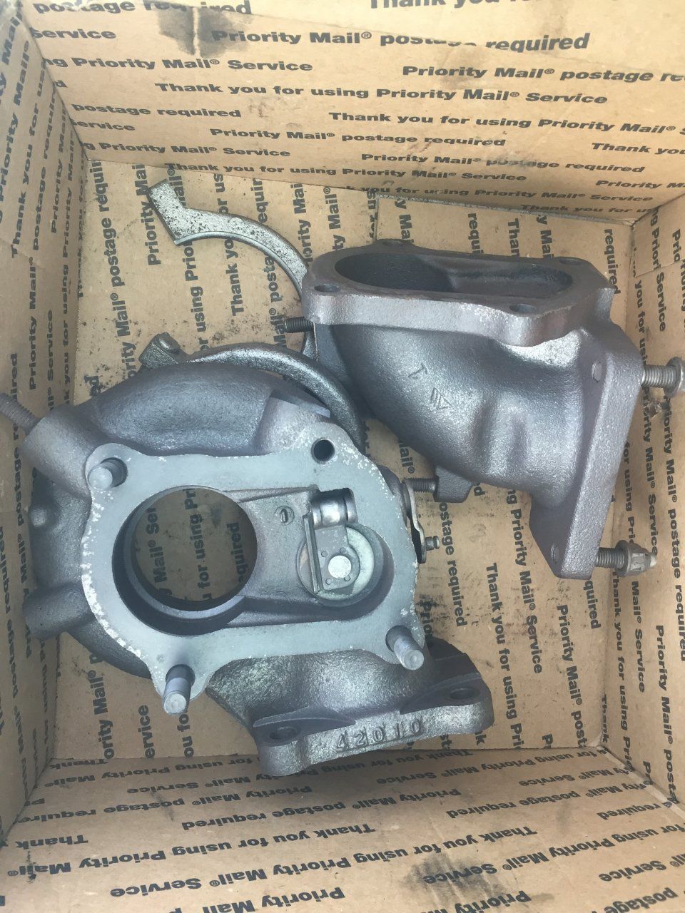

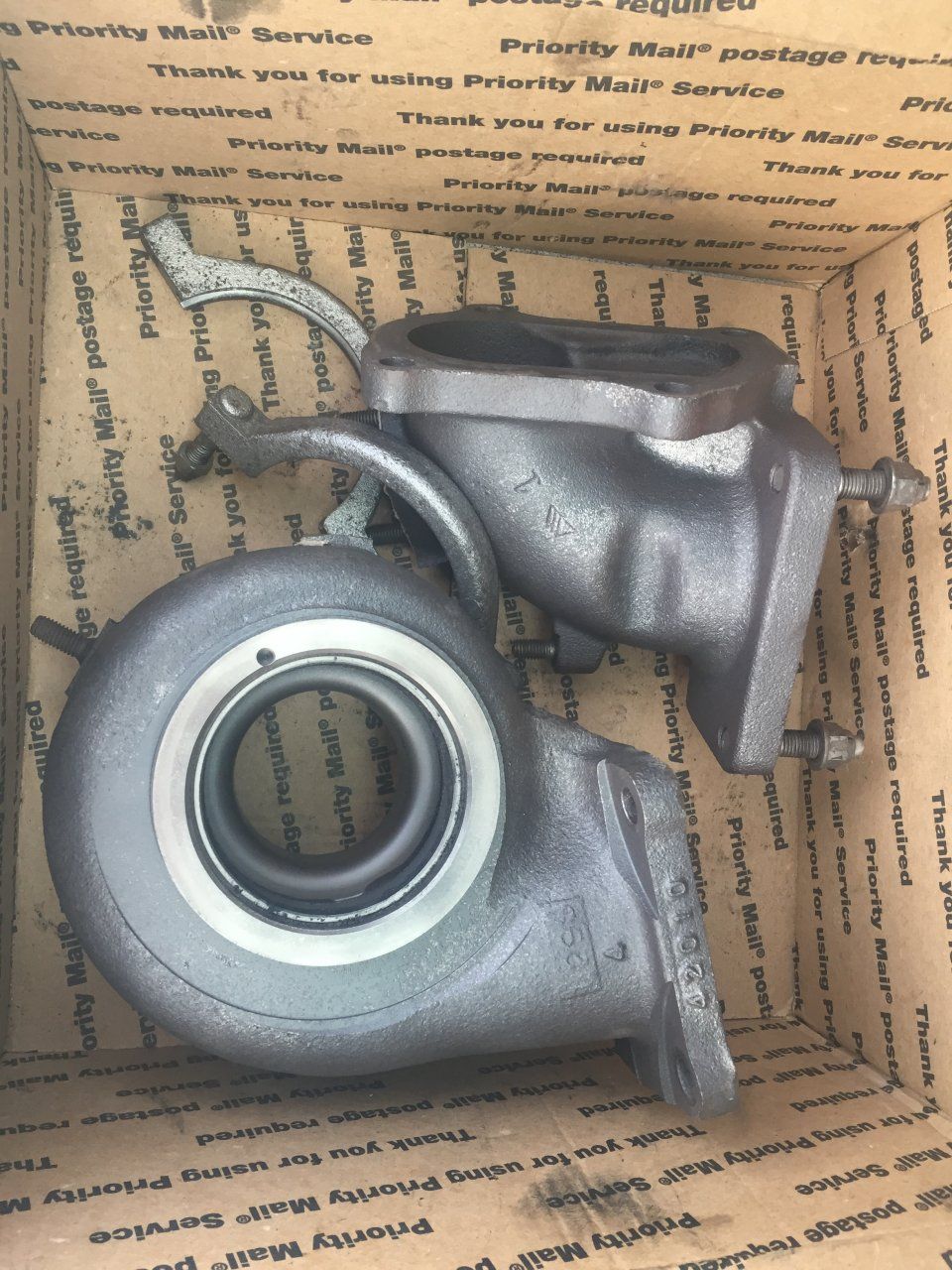

Started rebuilding my used ct26. I took it apart and glass blasted the turbine and the other exhaust side bits. I bought a rebuild kit and will tackle the work once it arrives in the mail. The turbo is of a supra 7mgt so I think I will have to reclock it for proper oil feed and drain. I was thinking about keeping the water cooling. Some of you mentioned it wouldn't be necessary. Should this still be up for debate? If I do, can I tap just anywhere for coolant? Any help is greatly appreciated.

A couple more pics of the cleaned turbine.

Ok. Looks like you have 42010 turbine housing which is bigger than 58010 12H-T housing. That means the turbo will spool at higher RPMs, unfortunately.
I don't have experience how big of difference it will make but when i asked the turbo gurus in this thread said it is better to use the smaller 58020 housing if you want more low-end power. The 2H/12H-T/1HZ/1HD-T/1HD-FT Gturbo Alternative Tech Thread
