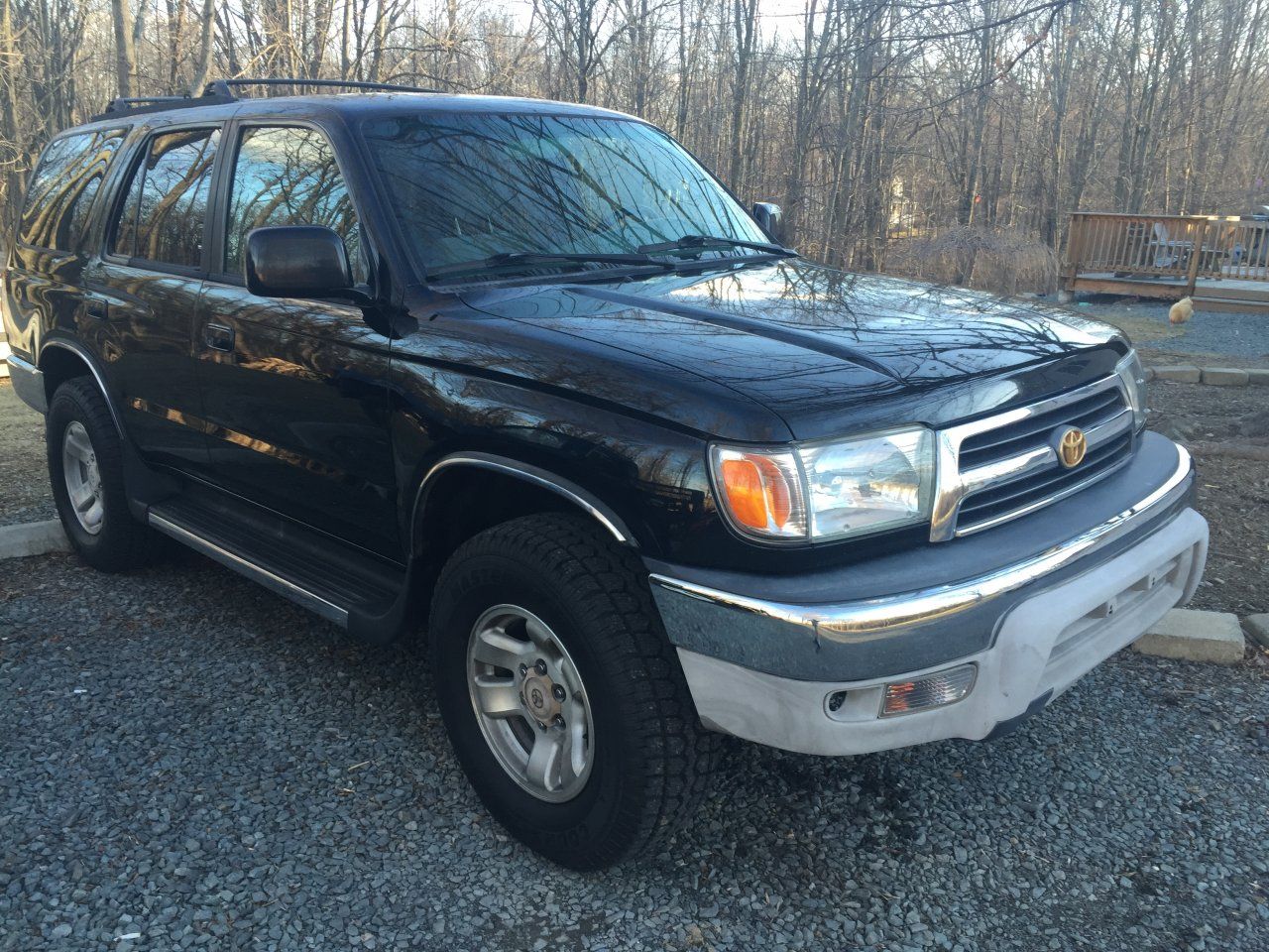

Ok, so kind of keeping it in the family but a little different. Picked this baby up today. Awesome truck. I love it already.
Wife and I love our '11 4Runner. Was thinking that if work changed and I have to commute then I am looking for a 2nd Gen 4Runner with the 22re for that duty.
Oh yeah the 2nd gen with the 4 cyl. The 3 liter was bad. My pickup has the 22r carbureted and I love it a lot. This new runner is pretty good too
