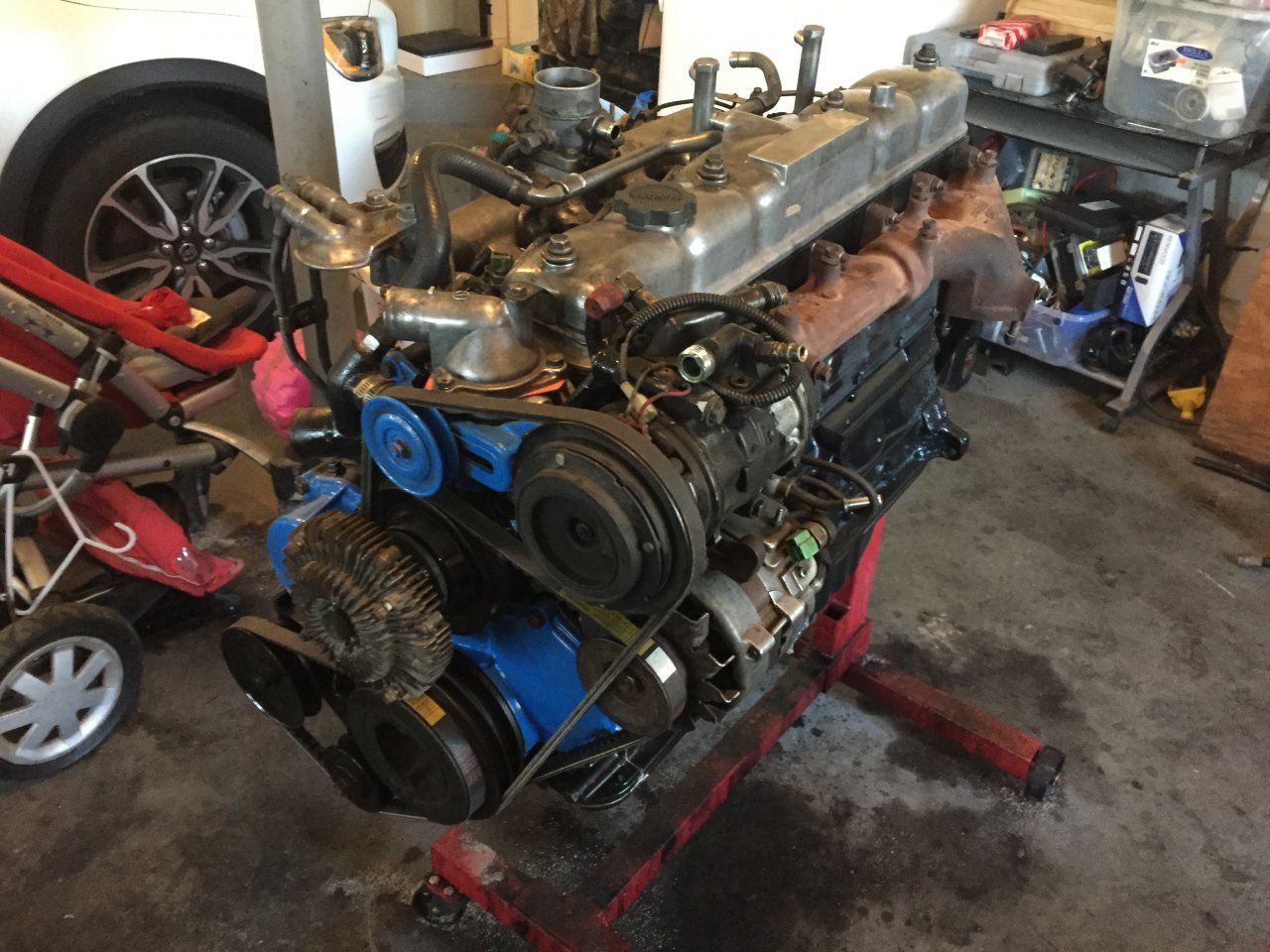

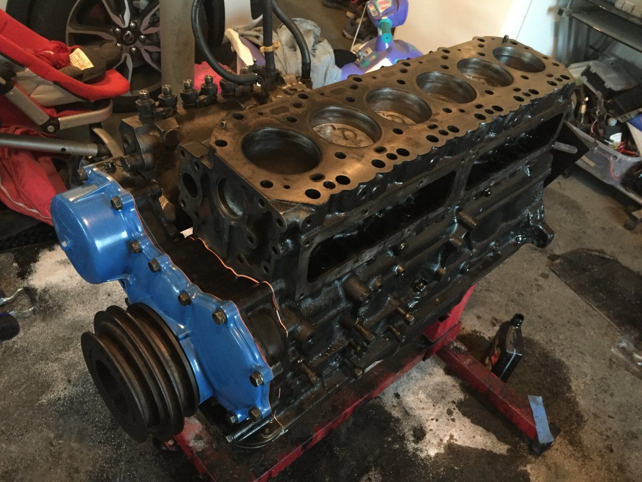

Ok, so today I started reassembly of this big ol' engine and got about half ways through. Got the bottom end all buttoned up. Next is the head and then the components such as Ac compressor ps pump alternator etc.

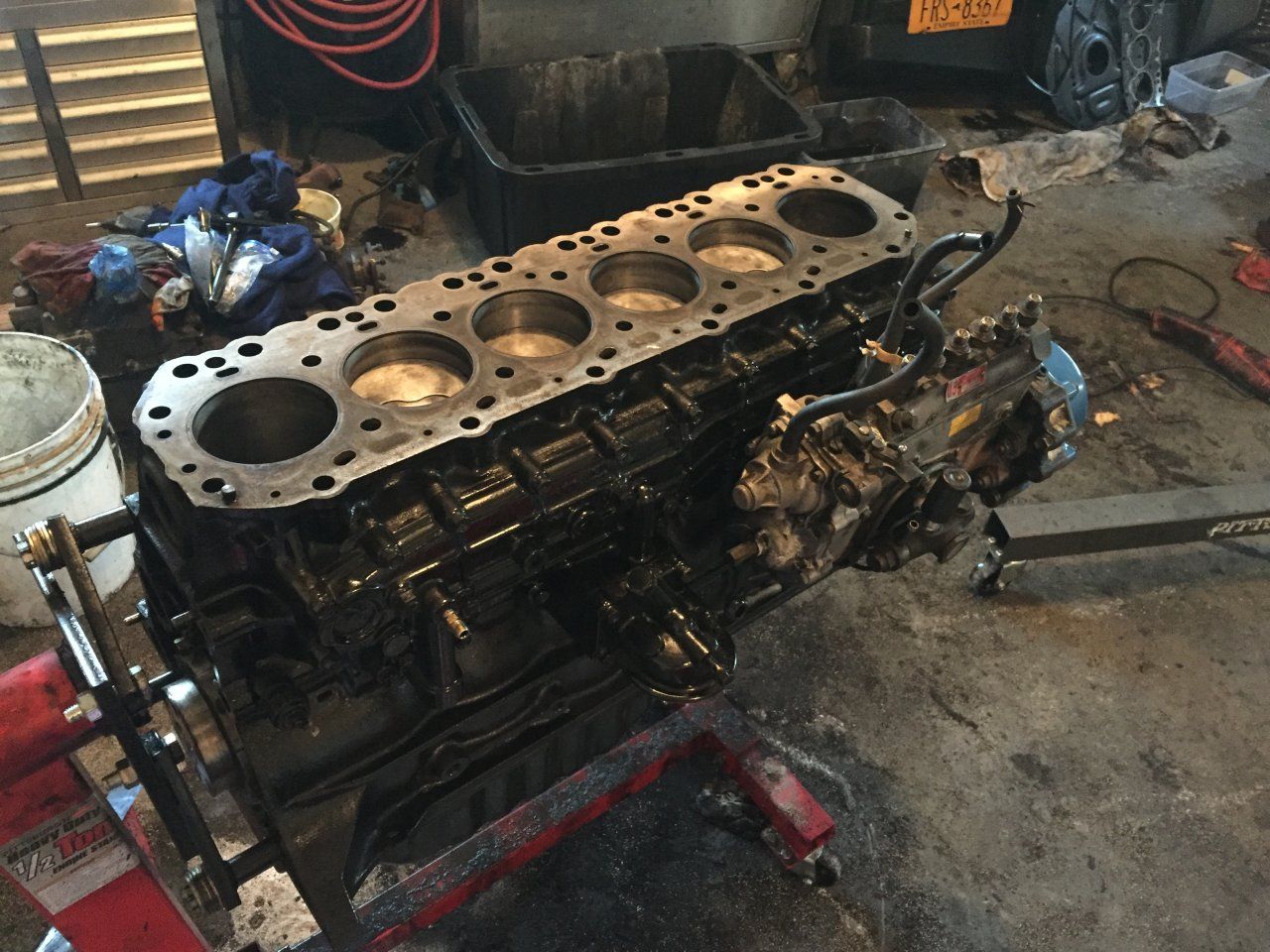

Not replacing that rod?, the others can have damage to, mostly not visible only measure. Might do it later from below when engine is in?
This is the worst while youre there I know, good luck but if you have time find a better one.
Ok I dont know but I am missing the actual repair? re-grinding the valves so they close better, removing the cylinder glaze? new pistons?
If you only clean it I dont think it will stop using oil?

Oh, lol, I did replace the bent rod. I did rebuild the head too but unfortunately I don't always have the time to stop and take pictures. Cylinders were honed as well. It's slow going but I'm trying to get her done before thanksgiving. Ill try to post more pictures as I go along.

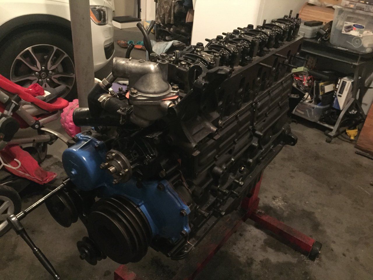

So last evening I put on the head and started getting stuff buttoned up. It's starting to come back together.

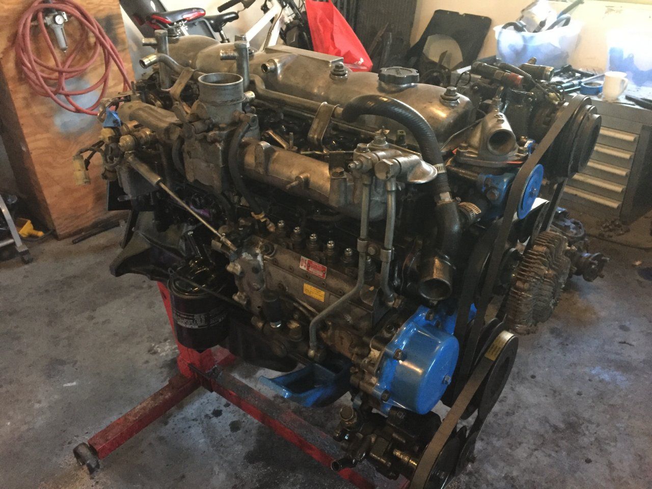

@beno, thanks for the parts, got them last night. U can see the filter is on already. Those precups were wonderful to look at, lol. Easy to install as well.

Ready to be mated to the tranny tcase combo. Cleaning those as I type.

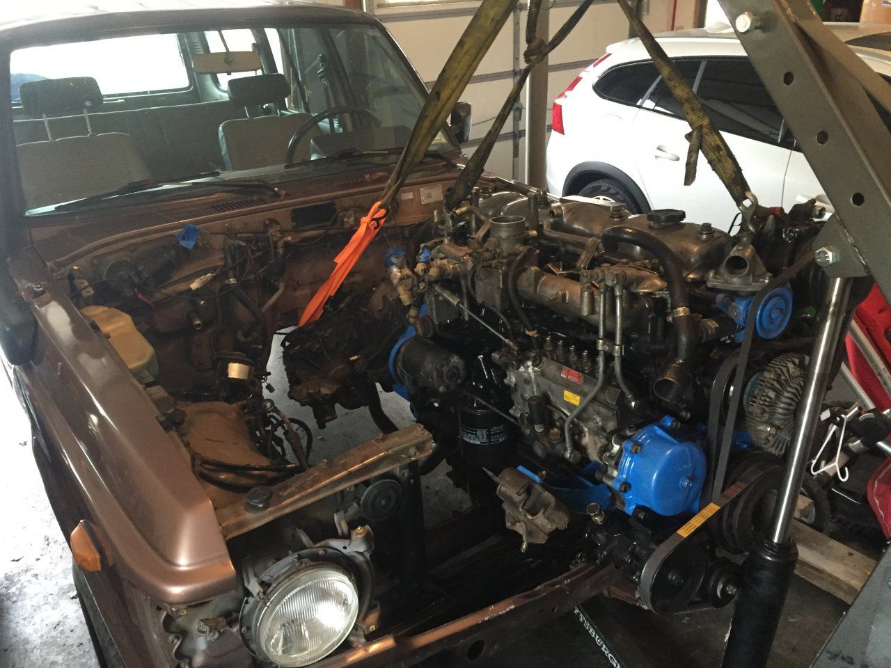

Ok so I thought I'd be dropping in the engine but ran out of time tonight. I guess tomorrow night s another day.
