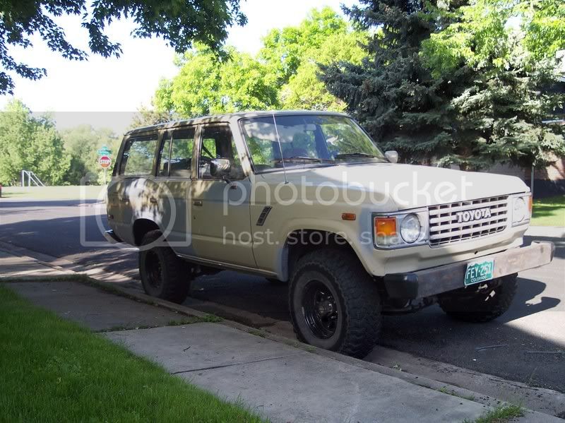

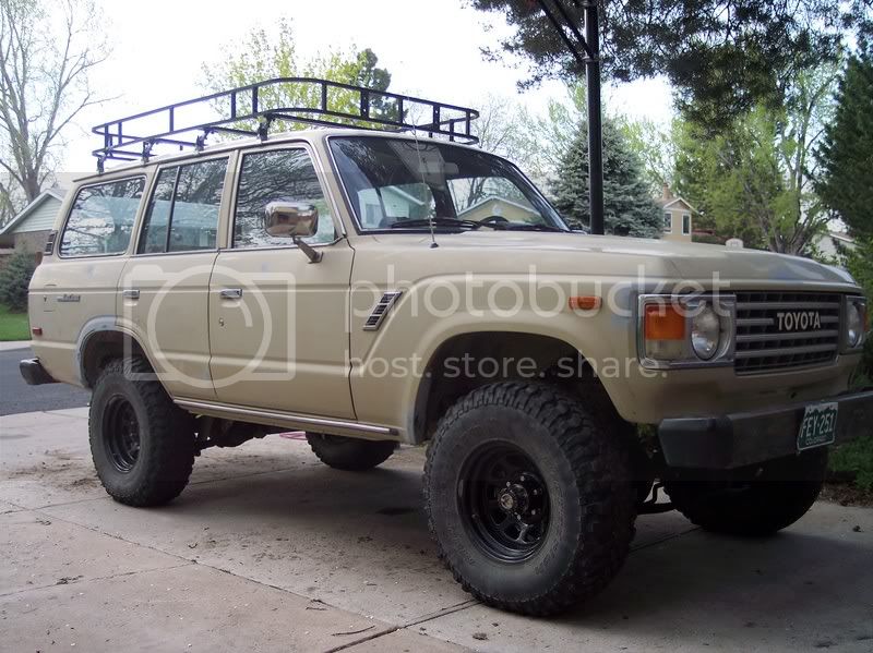

It now sits at least five inches higher at the doors than when i got it!
looks good! I really like the look of black wheels on these.
Thanks again Matt! They will be put to good use.

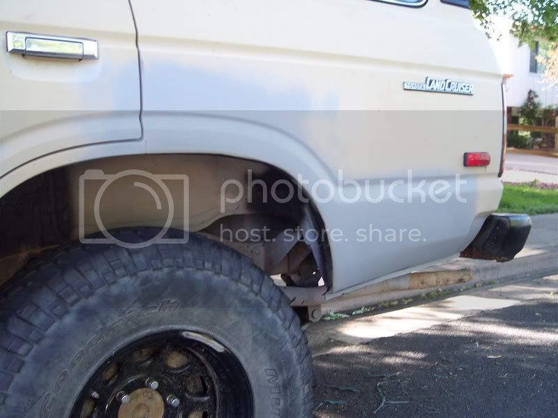

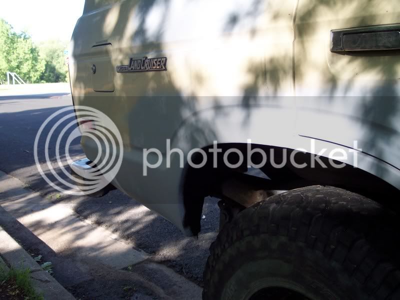

I got my 60 back from the body guy!
It's looking good! (really needs to be painted now). The Wheel wells are looking SO much better, not to mention the 24 years of little dents that are gone as well!
He welded up new metal for the holes i had inside the wells also and on the front fenders.
He spreyed some black undercoating on the repairs, so the photos are kinda hard to see.
