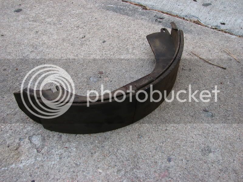

Here are the old shoes!!!!!
see the big Crack?

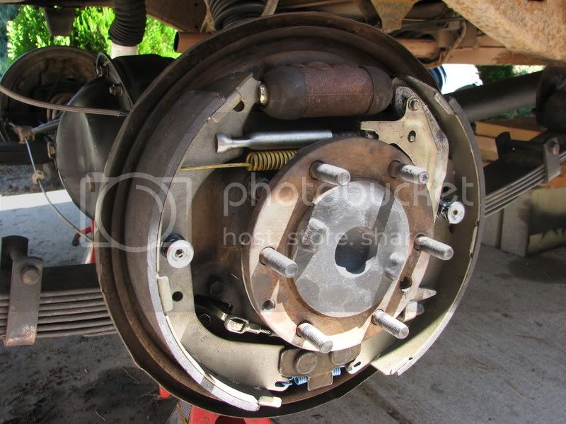

Freshly turned Drums! - the guy said he barely got em in Spec.
The shoe and HW replacement was pretty easy. I just did what people said and kept one side together while I did the other. I did have to take one side back apart because I left out the washer on the adjuster screw. I tested it, and its stops. So we're good!

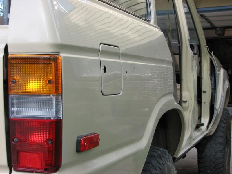

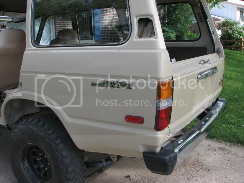

I don't have everything back together yet, but im basically done painting, minus a few little touch up items. so after over five months! :eek: i have the roller paint job done!. Here she in various stages of getting put back together -
Once it's all back together, I am taking it to a Muffler shop for a new Exhaust. Its also scheduled to get a new windsheild on Wednesday. Then If I can get it to pass emmissions, I can get plates! :bounce2:
http://img.photobucket.com/albums/v349/brazharris/LandCruiser/IMG_1942.jpg
Nope, that's straight Rustoleum. I still need to wax it.
