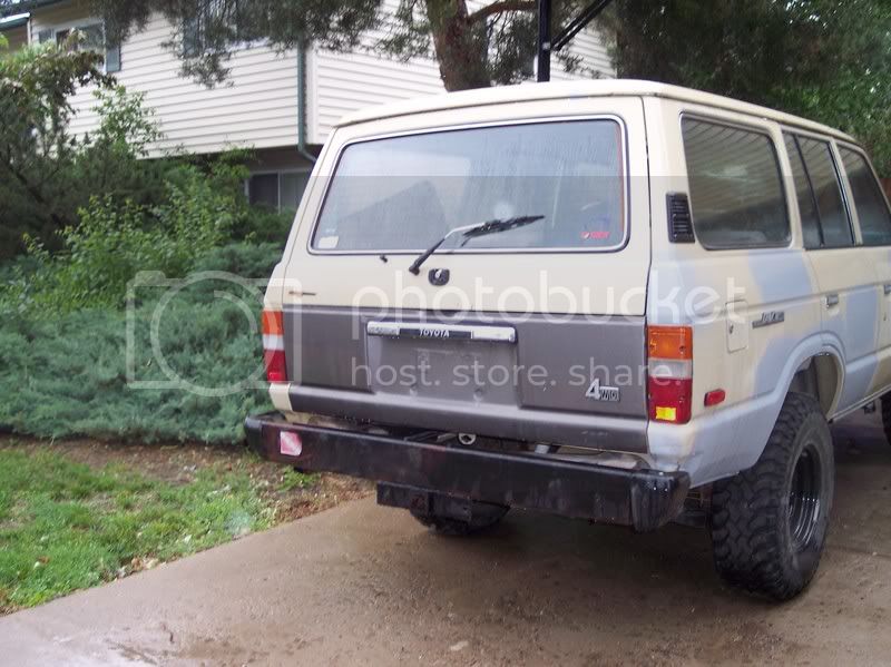

Some results of the De-Chroming quest -
Lame mirror -
Picture with the new 62 non rusty tailgate

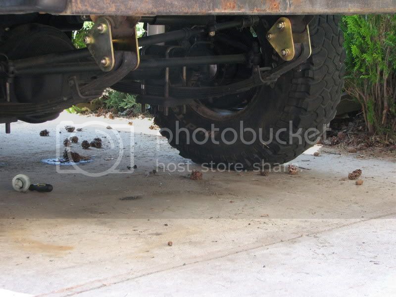

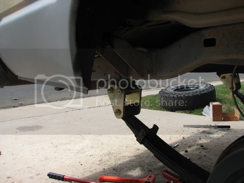

Got my new Shackles done today -
If you look at the rear driver side you'll see that the bolt that is supposed to keep it from inverting is missing. That's because as I was trying to get it tightened it sheared. The peice that broke off hit the inner fender - HARD. I am probably lucky i didn't get hit by a sharp peice of metal. :eek: I did call SOR and they are sending a Replacement, no charge.

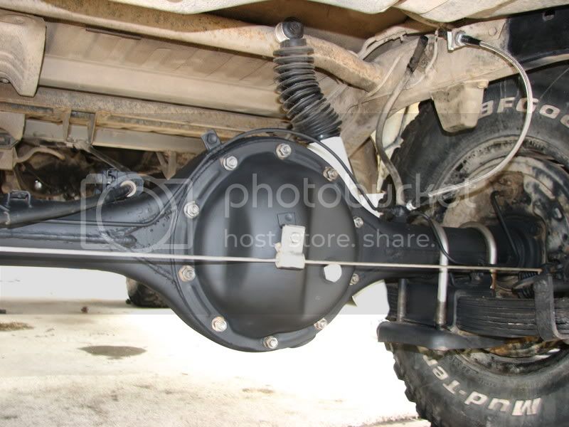

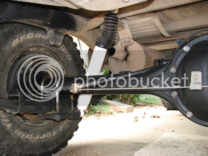

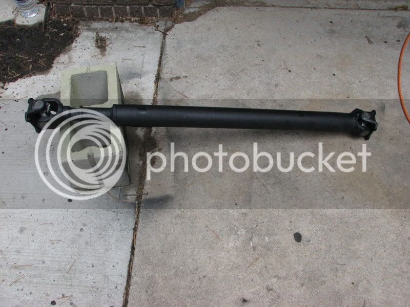

I just finished cleaning up and painting the rear axle similar to the front. It wasn't as hard as the front. It was cleaner, and there's less in the way.
I think the next mini project will be the T-case seals as they both look like they are leaking. I will also clean up and paint the Drive shafts when i do the T-case. This is good prectice for when I get done underneath the truck, and move on to the engine bay.

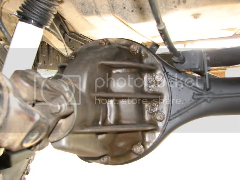

I pulled the Rear Third, Rear Axles, the Drive Shaft, and the T-Case rear output seal.

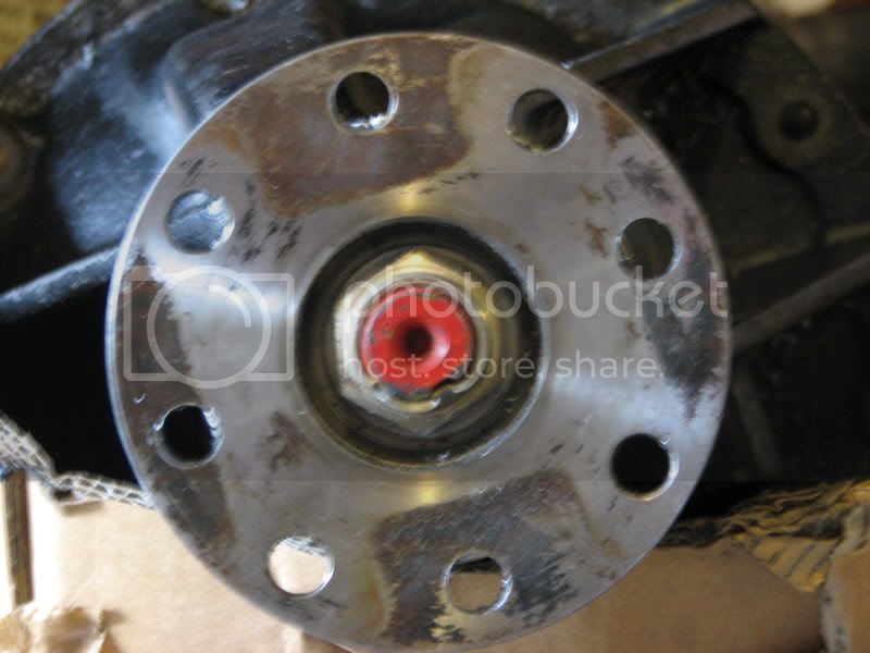

My new 4.11 Thirds were the Wrong Flange, So I had to Drill the original bolt pattern into the new flange
heres a photo, and here's the link to my other thread on the Thirds replacement -

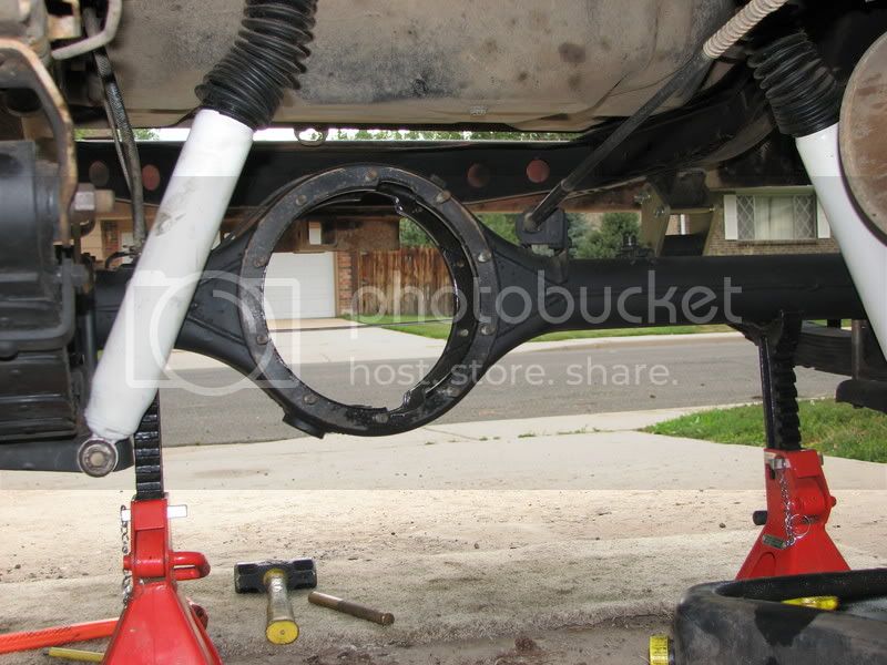

Here's a Shot after I pulled the old Third -
The toughtes part was getting the old Gasket off the back of the axle housing, I had to put a wire brush on my Grinder and crawl under there.

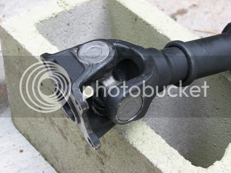

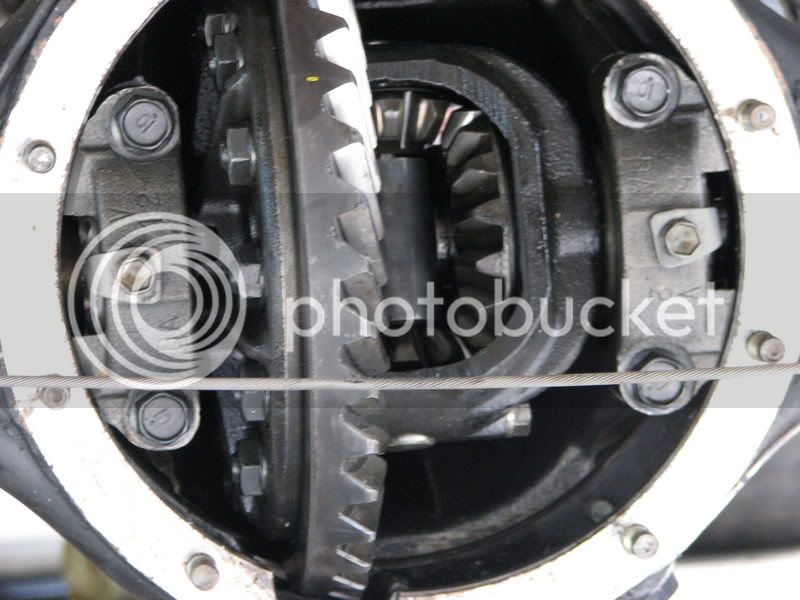

While i had it apart i Replaced the U-joints in the Axle -
Here is the DS ready to go back on the truck -

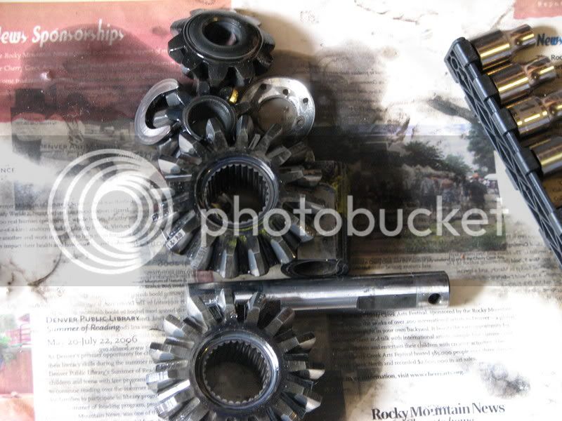

It was Cool to me how easy the the Spider gears were to take out and put back in. I was initially a little worried that it would be over my head, but it was completely self explanatory to take out and put back.
