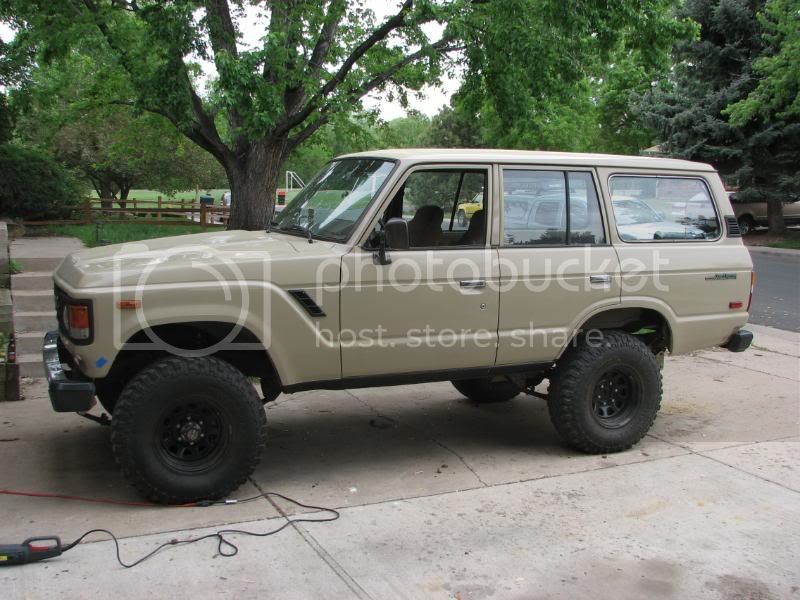

WOW!!! Nice work with the paint. I was taking a look at your before pictures and it's like night and day.
I can't believe that you painted your Land Cruiser using a rubber roller. From the pictures it looks real good. I have to ask though, does it look as nice as the pics or does the roller leave streak marks?

It a 4" white Foam roller from home depot. and Rustoleum "Professional" from Home depot as well.

I'll be honest. It is a about a 2-3 foot paint job. If you look any closer than three feet you start to see imperfections like swirl marks and minor blemishes, but I only spent a few hundred bucks, so I don't honestly think MACO could have done it any better for twice that., and i truly can say I did it myself.

Looks REALLY good! Way better than I imagined for a roller. (My grandfather once Rustoleum painted his VW beetle with a brush= bad results). Like to see some poser shots when it's fully back together. What happened to your windshield??
That paint looks great! Nice work, and another fine Black and Tan! Grill looks good too

It's really the thinned paint and how much you sand it. You have to sand the paint so it gets ultra smooth, then buff to a shine.
