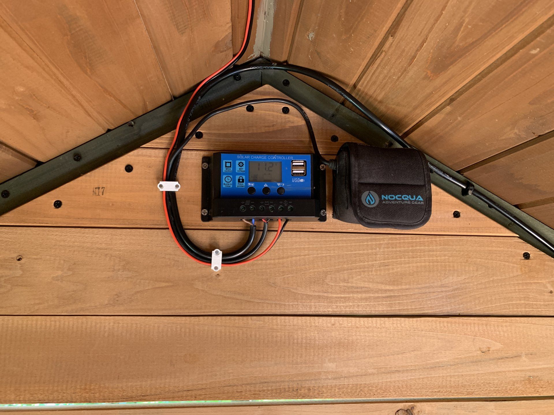

Wow - nice work. Little solar panel setup for the lighting, too? I remember putting together a swingset about 20 years ago... Not hard, just ridiculously time consuming.
Aww... you noticed. 25w panel to charge a small battery to the right.

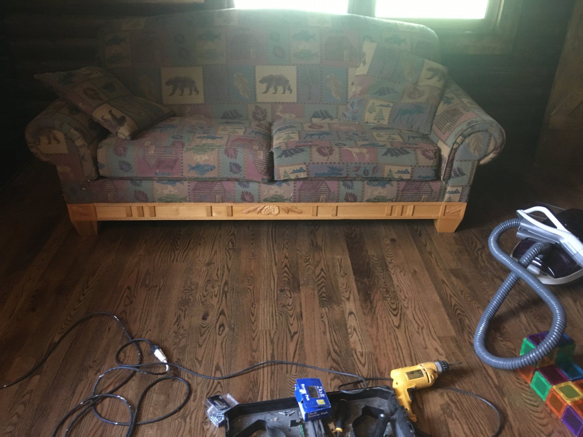

3) The fun one was turning a free and in amazing condition sleeper sofa into a hide a couch. Removed the sleeper sofa mattress & frame. Then replaced with blocking,1x6 cross pieces, and 3/4” plywood.

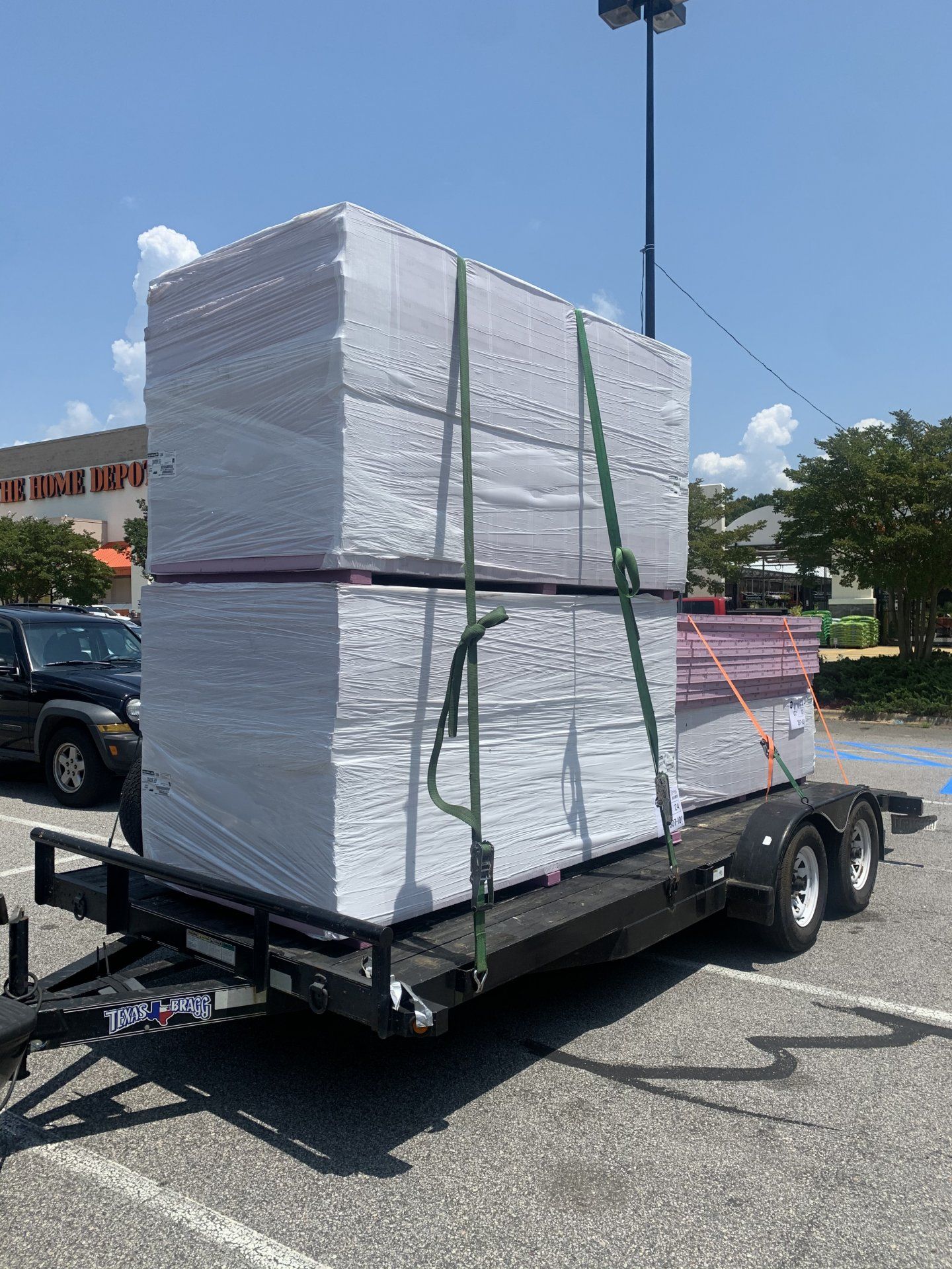

Spent the weekend insulating my attic. 180 degrees felt great on my joints.
I was able to finish the first 2 inch layer between the rafters. The next step is to cover up the rafters with a second layer. This will give me an R20 rating. I needed to lower the temps in the because I have an AC unit I. The attic that I just replaced that is already shutting down on me. It is not just that the attic is very hot. There are other issues and I plan to address other things As well. After I’m done insulating the roof. I have to seal all air leaks where conditioned air is escaping into the attic. There is plenty of places where the air is escaping. Some expanding foam will fix all this. Then I will be fixing all the ac ducts which are old and are leaking before they reach the ac vents.
I am hoping rhat all this work makes everything run more efficiently if I reduce my power bill that will be a plus but I am mainly doing it becasue the vent system used on my house is 60 year old technology that is not very effective.

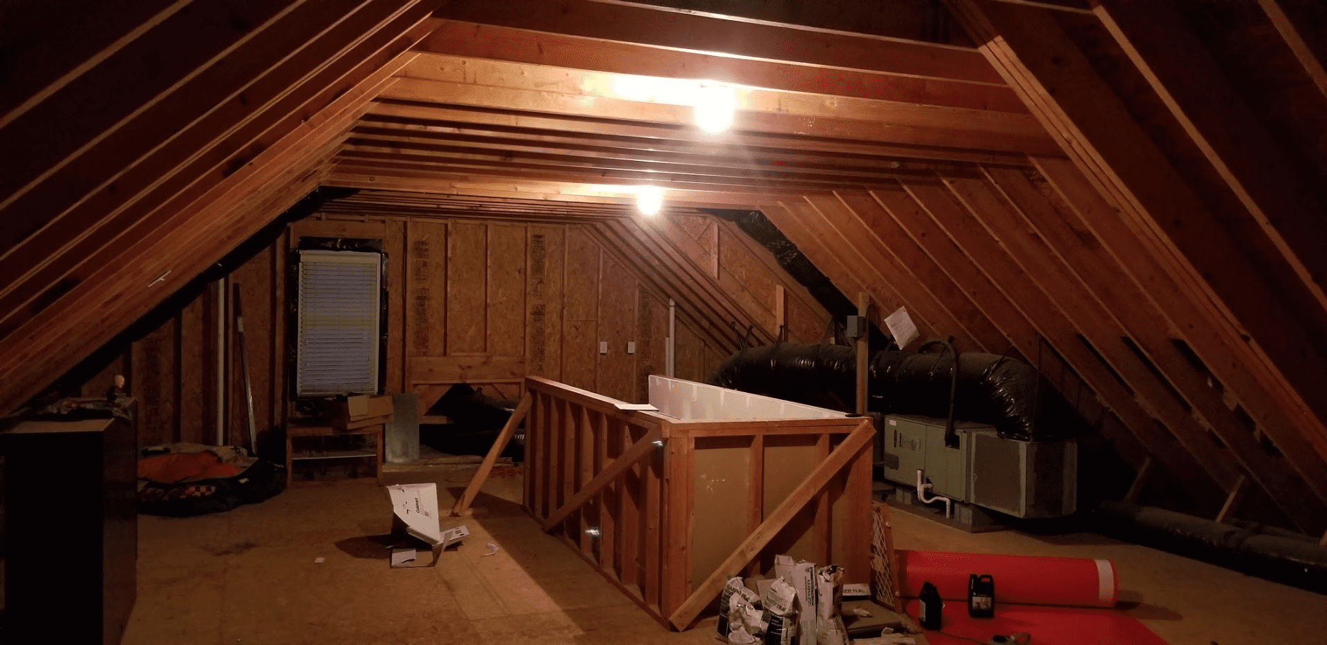

I am eventually going to finish my 3rd floor. It's 700 square feet of open area. A small portion will be storage but most will be a open area for entertainment or another bedroom. Our house falls under Region 4 with attic insulation minimum of R38. I have 2x8 trusses but will add horizontal banding to get the proper thickness and reduce thermal bridging. My plan is to leave a 1.5" gap for venting, a 1" layer of foil backed EPS, and either batting or rigid foam to create R38. My upstairs HVAC struggles on hottest of days but it's also 16 years old.

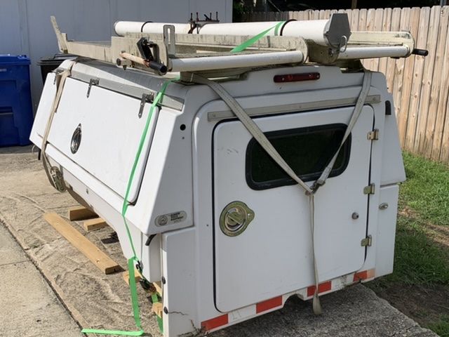

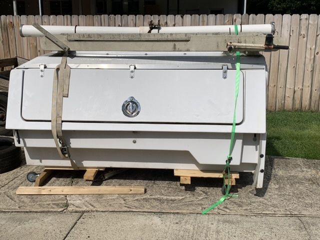

Finally got my hands on the drop-in utility bed I want to use as the base for my camping trailer. Once I strip off the ladder rack parts, it looks like the integrated aluminum frame should work out pretty well for the RTT. Now I just need to decide what style tent to start working on.

Dude, I love that idea.
