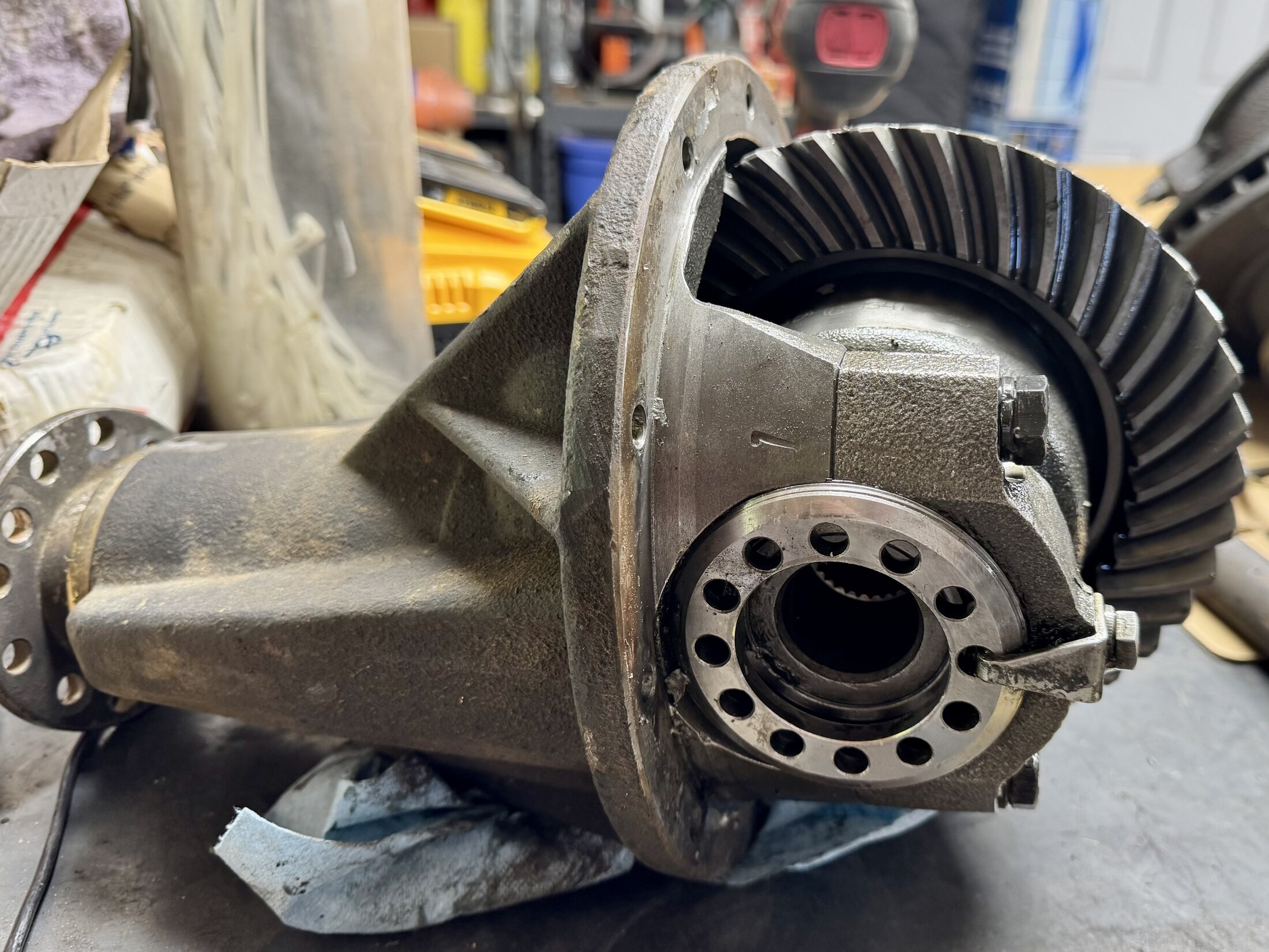

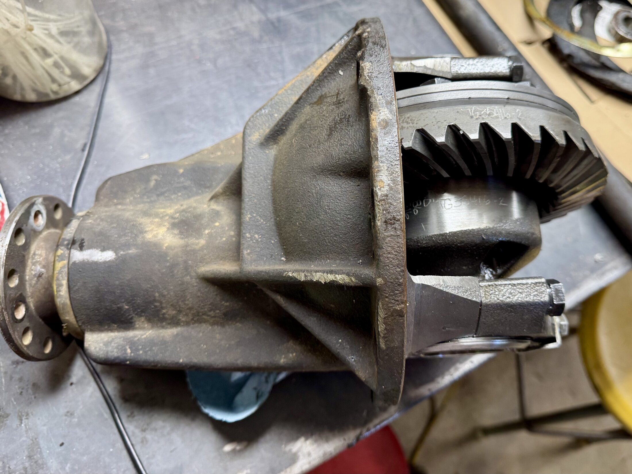

Hydro assist was already in this rig, so I’ll be reversing the lines and mounting it up front with the Hellfires. No selectable locker for now. Grizzly will do for now. Later on it’ll probably get an Eaton in it, but the head gasket going in February took those funds away
