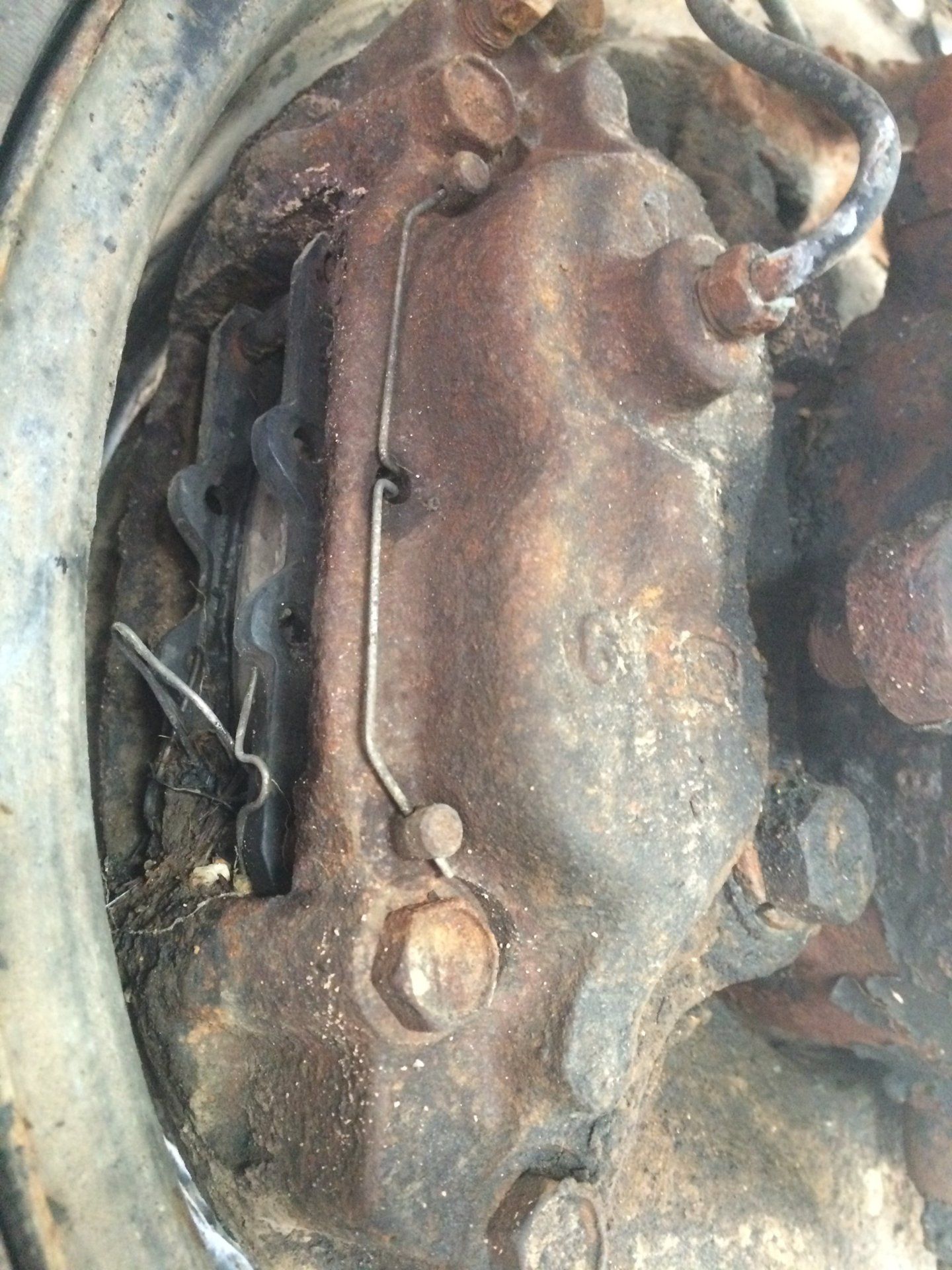

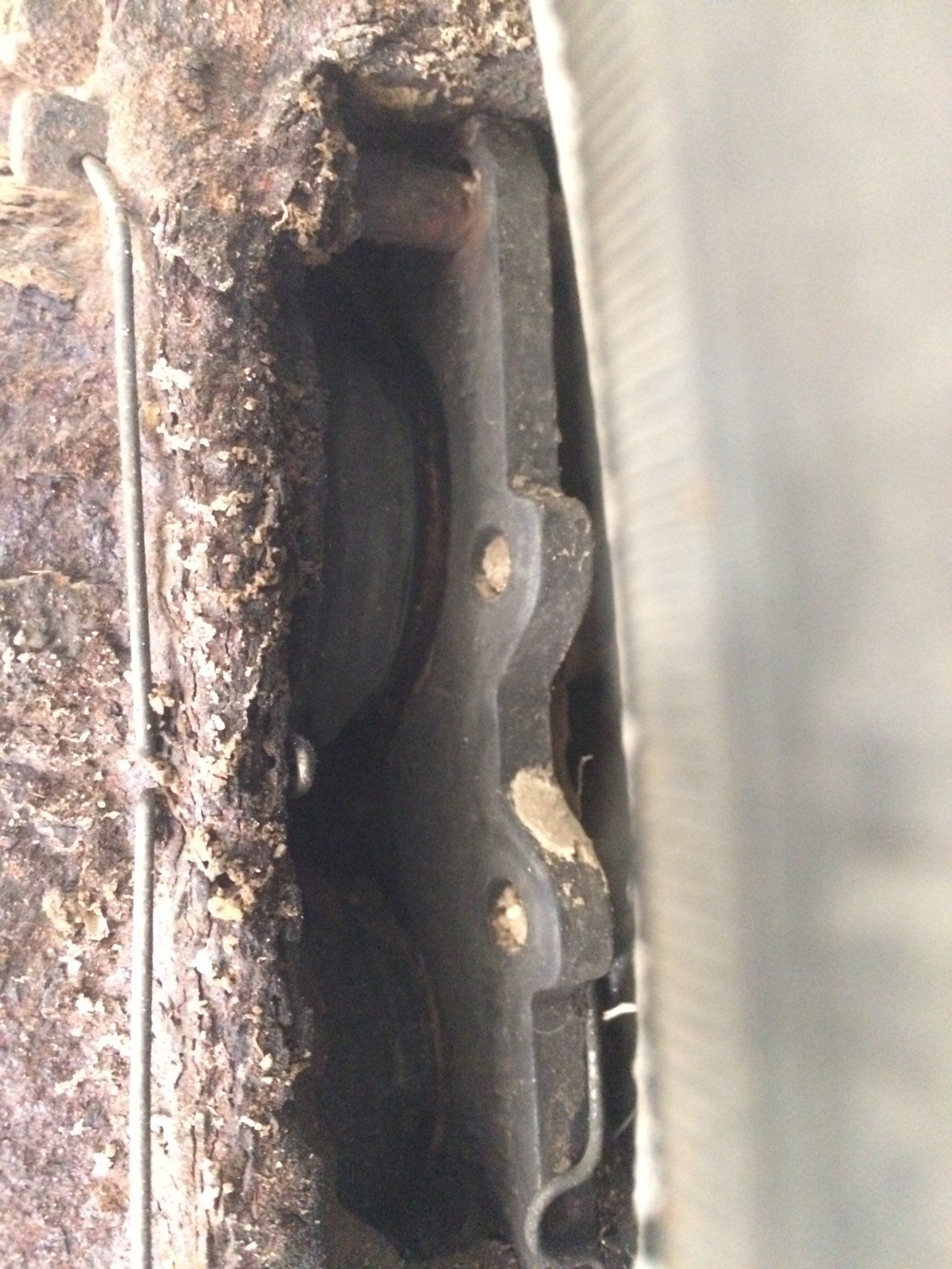

So I forgot I squeezed my ph in under the truck after the second time I washed it down at the car wash and it appears I don’t have the anti rattle plate?
And yes they are ugfugly. And I’m not driving it. The grinding got excessively worse and I wasn’t up for the challenge if someone did something dumb in front of me.
Can't see the rotor but in the 2nd pic your pistons are fully extended so ya it's time. You're probably metal on metal. Not safe.

Grinding you are metal to metal. Those calipers look bad.
If metal to metal then you might as well just replace them. IF they are ground down to far tuning them will not be an option.
For those pins, just use needle nose or pliers that can grab them and pull. You can see how they come out.
As you are looking at replacing the calipers and the disks, then I would just pull them out and not care to much about saving anything. The pistons may have to be compressed a little. You can get fancy with a tool and or a c-clamp and open up the bleed valves. But since they are being replaced, take the brake line of and use a prybar to compress enough to pull them out.
Great pics. Looks like the pad is completely gone.
I would say, rebuilt calipers is a good plan. That rotor may be shot too, so good you're replacing it. The missing anti-rattle clips are no big deal, and you should get new ones with the rebuilt loaded calipers.

Anti rattle thing was a plus sign shaped metal bracket that gets held in place by both long pins that go in horizontally top and bottom of the pad thru the calliper housing.
