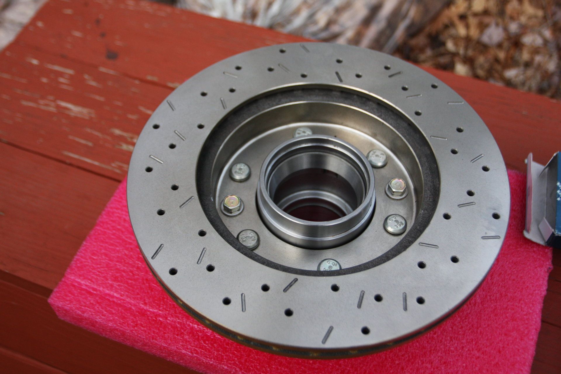

Funny how to us, that’s really an equivalent of a woman’s fancy pair of heels. But seriously that right there is way out of my budget. It’s sure is pretty tho.
