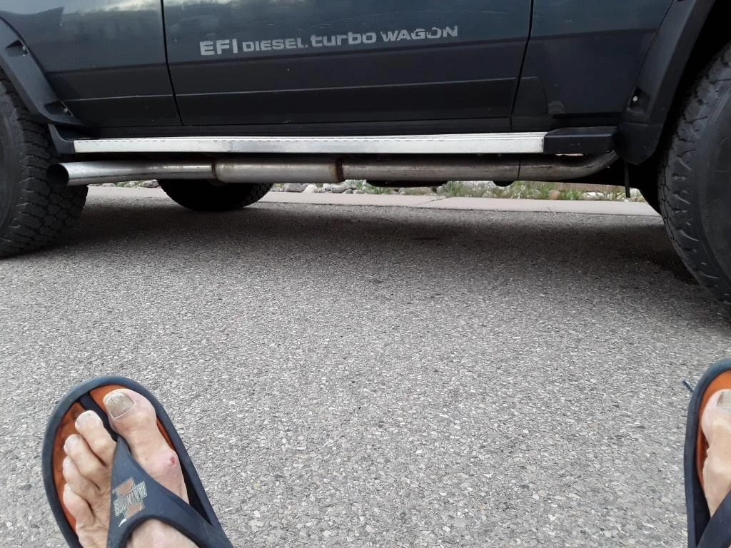

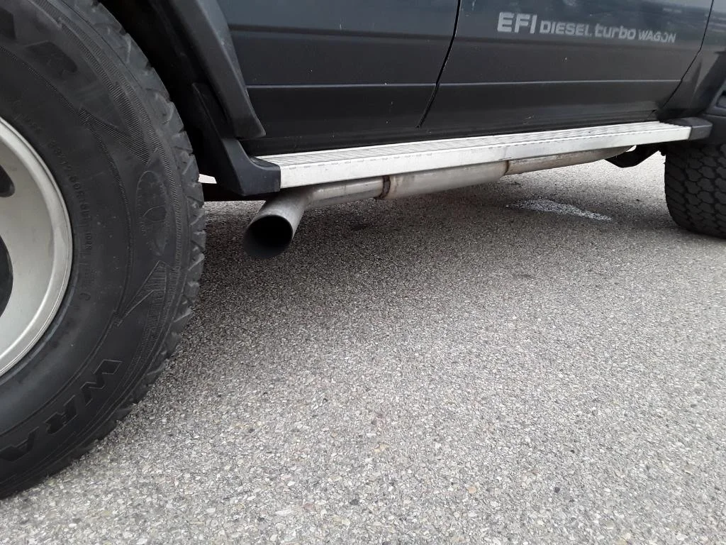

As far as the size of a air to water intercooler it's not the size.. it's the heat transfer surface area & the temperature of the coolant.. along with intercooler take a look at your exhaust.. as also mentioned on the forums as well. I went with a super shorty 3" with a thru glasspack muffler.. + all the other recommended mods (snorkel, disco butterflys..etc)

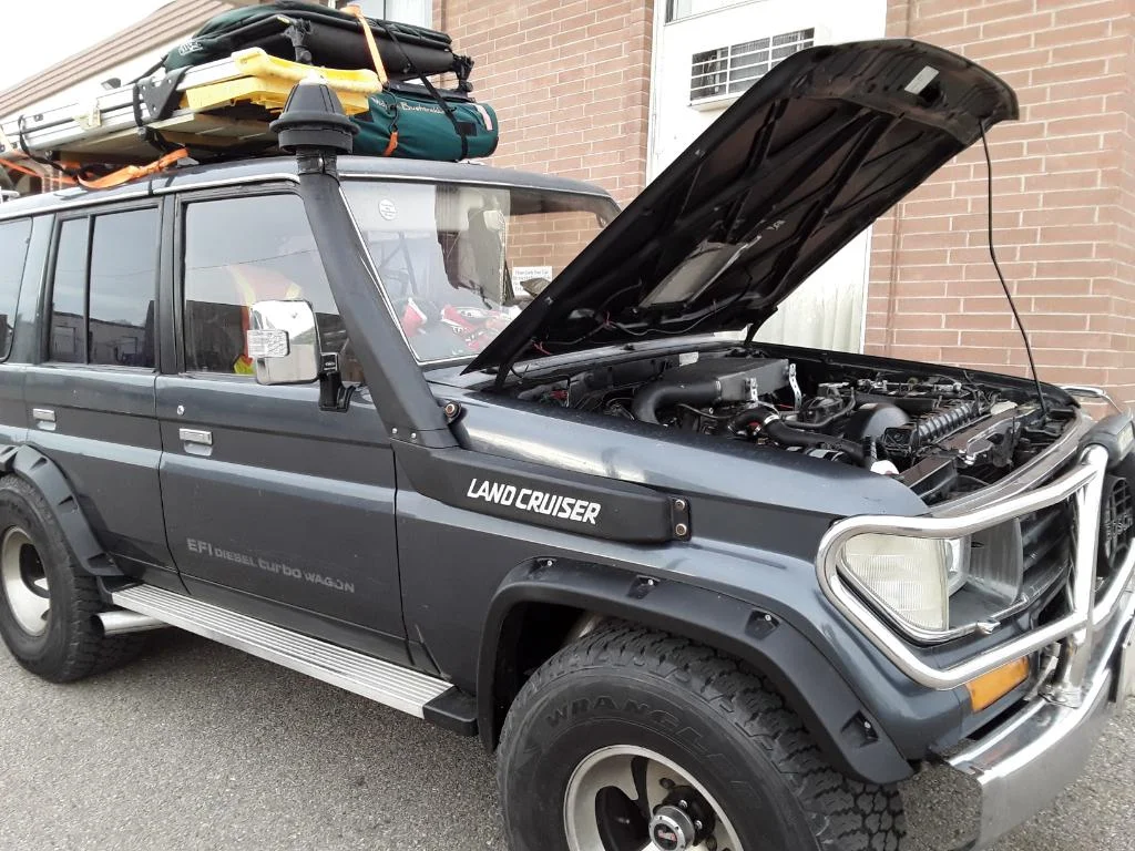

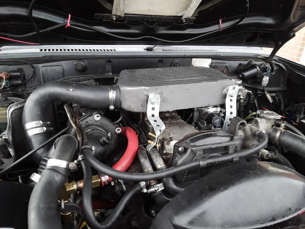

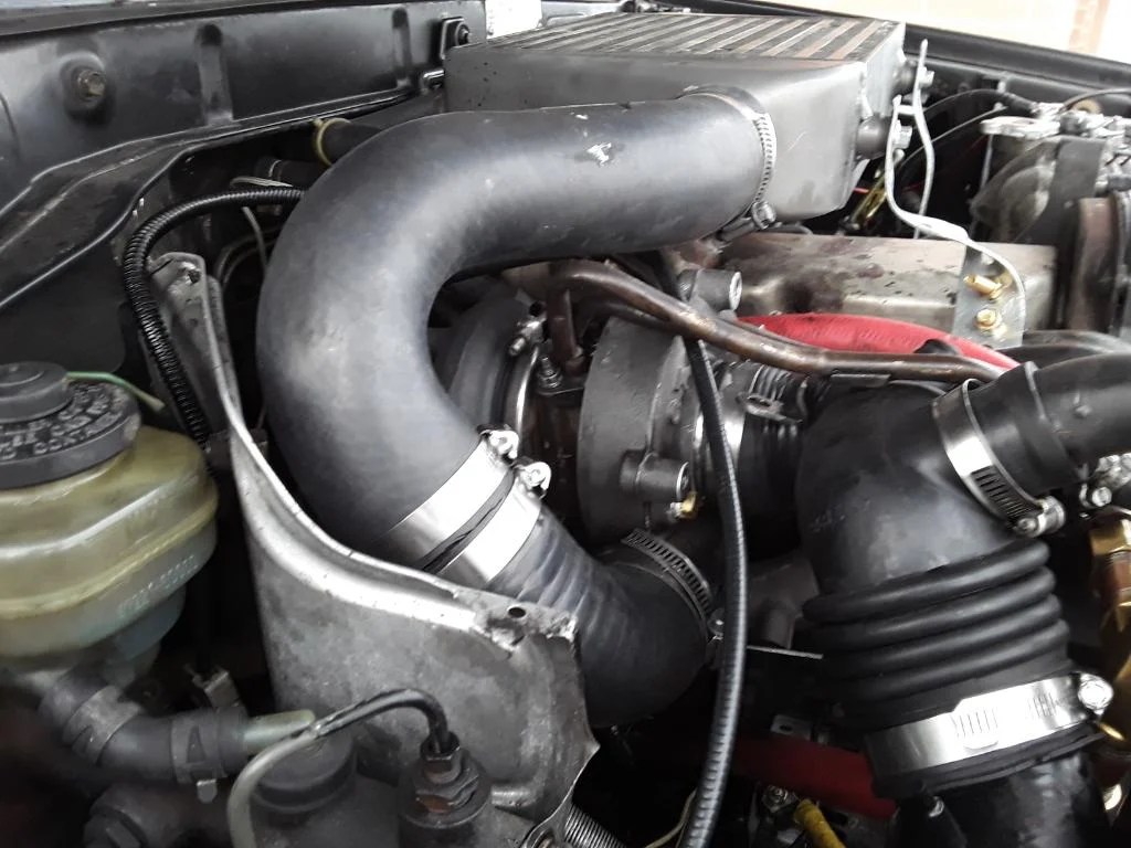

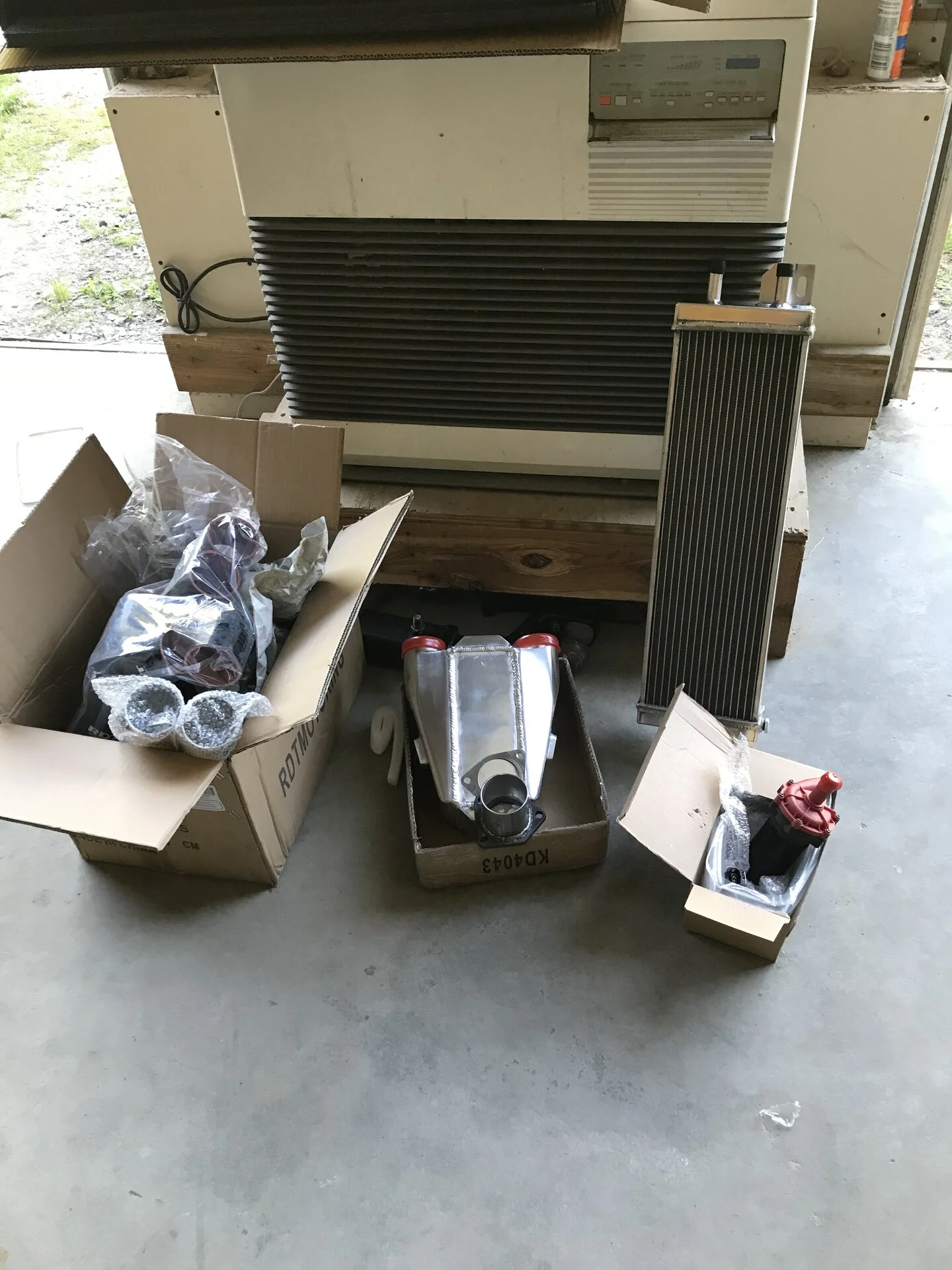

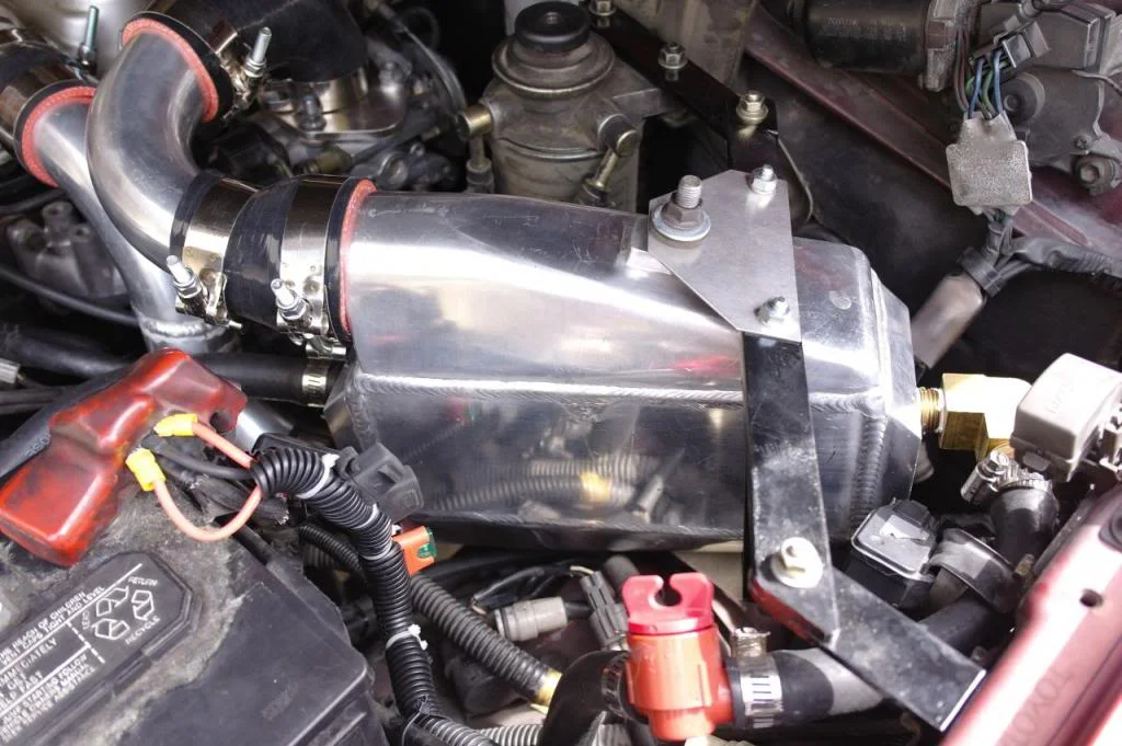

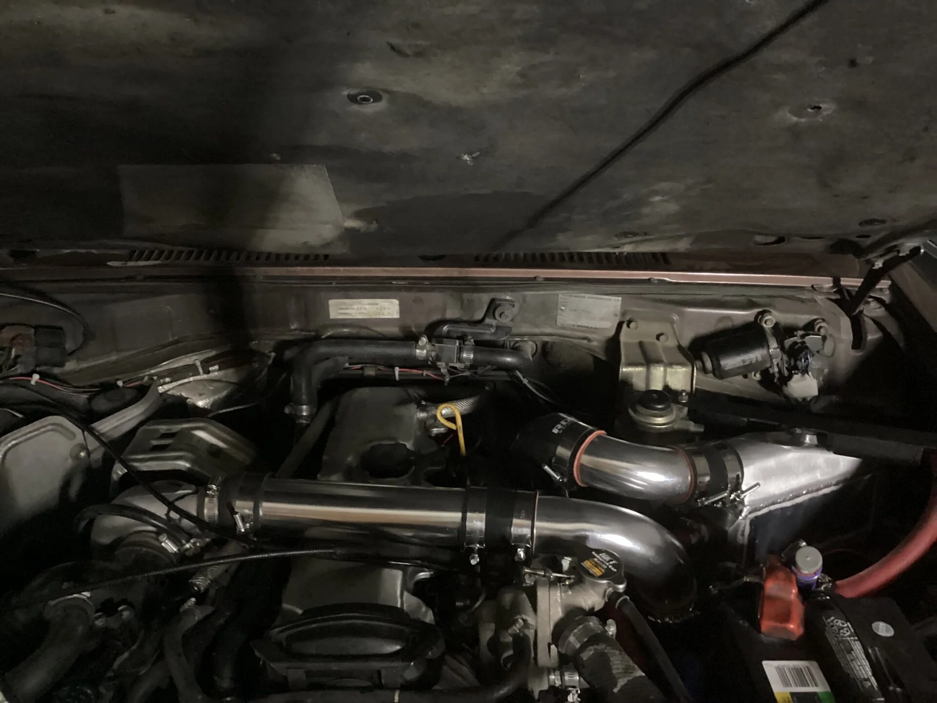

You guys have probably seen these, but here are a few photos of a air/water setups that a few of us have built now. And I can say this design works very effectively. Facilitated transformation of my 2LTE from a pathetic anemic fragile thing into a decently capable and powerful engine.
My setup after I first built it:

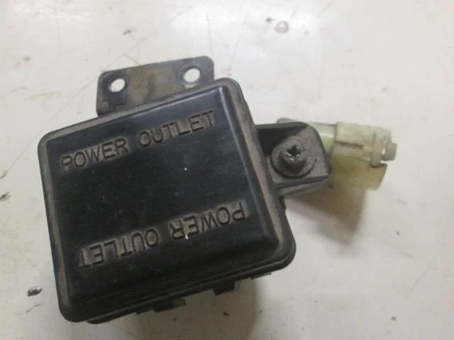

My pump runs anytime the key is in 'on' position.
I use a relay to do this. The control side of the relay gets power from the OEM Toyota Auxiliary Power Box, and the power side of the relay gets fused power directly from the battery.
I use that strategy for pretty much all the extra wiring I've added (for trailer connector, elec fans, subwoofer, intercooler pump, etc.)
This is how the OME Aux power box looks. It's handy for controlling relays!
Thank you. Very nice. Will take this approach :)
You're welcome. The OEM power box is handy, as it has constant 12V, accessory 12V, and on 12V. It can't supply a ton of current, which is why I still use relays. But it is great for all sorts of things. Toyota had a good idea with that.
I think most all of us so far have put it off to the side. The couple bends make virtually no difference in performance. On a turbo engine, post turbo piping has was less impact on performance than on a normally aspirated engine. Pre turbo is a different story. Freeing up flow there is a very good thing.
I don't think the cooler you've linked to will fit. Make one out of cardboard that is exactly the same dimensions, and try placing it on top of your valve cover. I think you'll find that it covers your oil filler cap, might interfere with the throttle cable and hood. And the inlet/outlet are too high up.

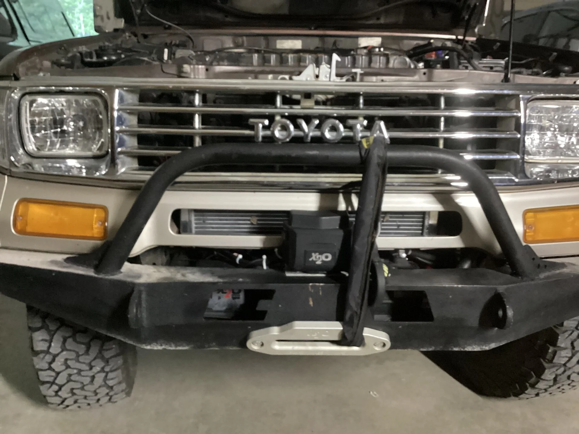

Does your A/C work and do you use it? If not, the best performance/simplicity/cost option is a front mount intercooler setup like this: How to Install a Intercooler on a '91 Prado EX5 (2L-TE)?
On the highway (where you really need an intercooler to perform), an air/air system is just as good if not better than an air/water. Air/water is better around town though.... Only reason I went air/water is to retain the A/C (no room for pipes to the front of the truck there).

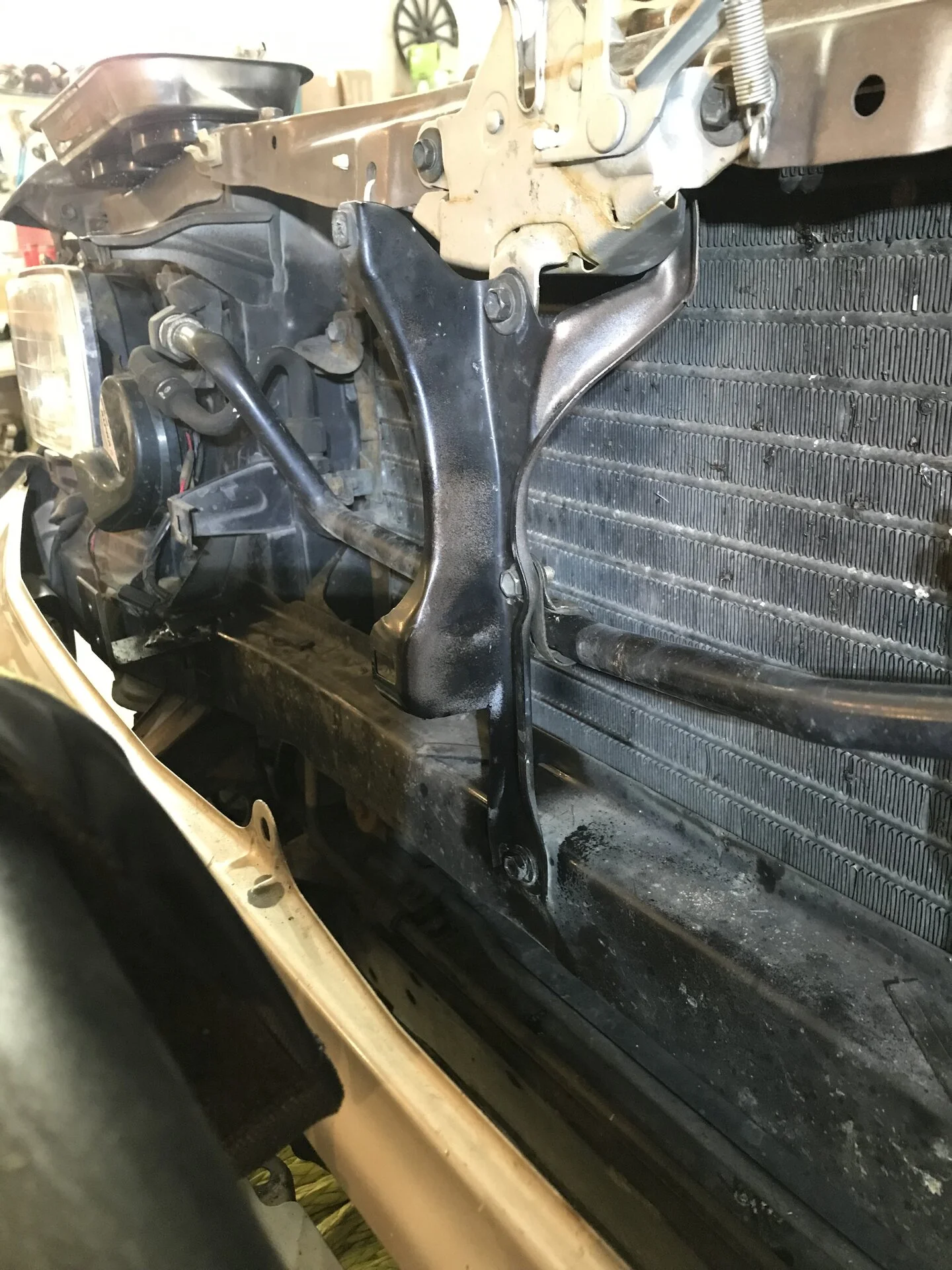

I am looking into intercooler options. I'd like a front mount and air/water because I use my A/C in the summers (with family). I want to avoid trimming the front grille which I've heard can happen. I'm curious, what brand and model number air/water did you use? Did it require trimming of the grille?

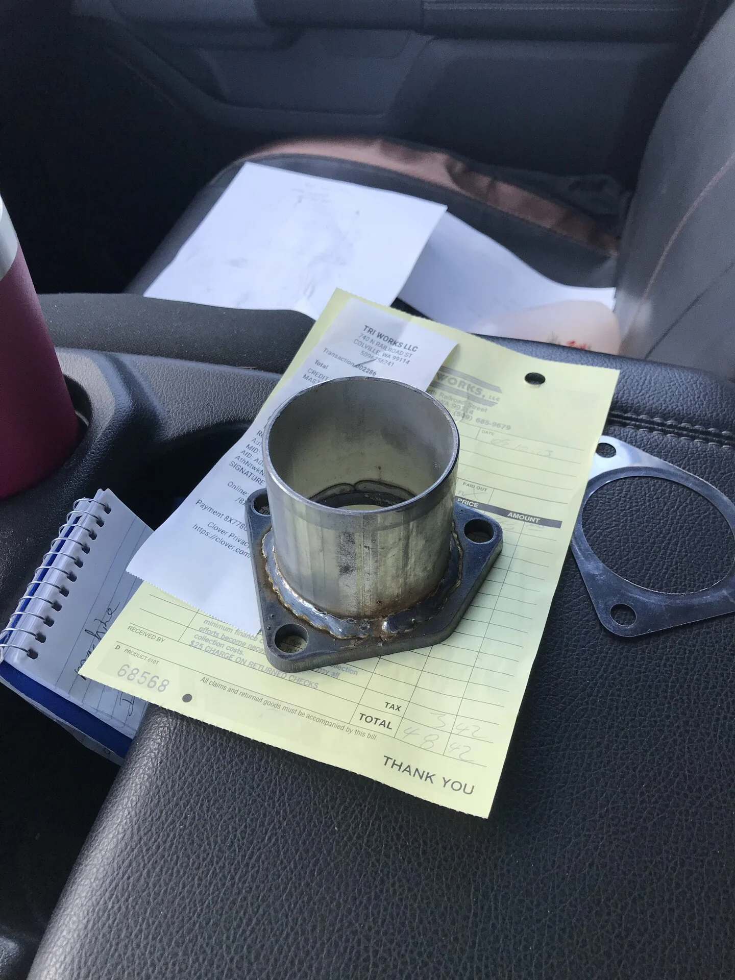

Found all this stuff on ebay. Did not have to trim the grill or bore holes in the fire wall. The coolant hoses routed under the Rad frame. Did need to fab up an intake flange.
Its not a kit. All the parts are sold separately. have a nice search.
