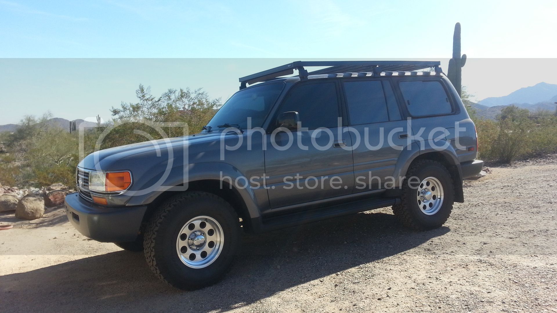

Any opinions would be appreciated. Pictures as well since I'm also concerned with stance.
Attached a picture of my 80 on stock springs, has Bilsteins in back which I don't think I can appreciate since the stock springs are mush. I like the way the 285s fill the wheel wells, so might lean towards stock height..

33s will run just fine on the OME stock height suspension. In fact, you could run them on that tired old OEM suspension. So don't lift to fit them, they already fit.
I see you're in the NYC area and have a roof rack. You will be at or over 6'6" on 33s with a 2.5 lift. I only visit the big city from time to time, so you'll know much better than I how much that might limit places to park. That was a factor here because of our garage's 6'6" open door height. I could've squeezed in, because we don't have a rack, but I wanted enough slack to not need to worry about it and had no plans for anything larger than 33s.
Finally, not having to sweat caster correction saves a lot of effort and/or cost and you're almost certain to need it with the 2.5 and most unlikely to need it at stock height.
I'd go with the 861/862 stock height coils if it was my truck.
