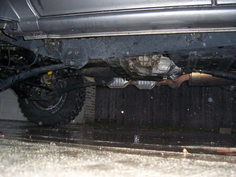

ALso, both my front spacers are not seated all the way up (From Man-A-Fre) on the cone. In fact the drivers side spacer has another issue. my spring has jumped the seat and is sitting on the ledge of the urethane. (see pic). i need to drop that side and re seat it manually I think. I don't want it to be damaged by waiting too long.
Dude- my front spacer looks IDENTICAL! I thought i screwed up on the install, but seeing yours i am not so sure now...could be a design issue, or we just didn't quite hold our mouths right when we put these on, who knows? I am not gonna mess with mine, hopefully it will seat on its own but i don't think it will cause any undue wear plus it eliminates the stinkbug i would otherwise be looking at :D
Brett, I had the same issue with the MAF spacers when I installed new front springs...
I ended up taking the spring out, jamming the spacer's lip into the spring (so it seated properly), and putting the whole thing back in as one unit.
No problems now. :hillbilly:

I hate to tell you this, but you have 6.5" of lift up front with those spacers unseated like that. Remove them, and lubricate the cone with grease and they should seat. You prolly don't have enough caster until those spacers are seated. I barely have enough with Slee's 4" springs, 30mm spacers, and plates.
You may also eventually have driveline issues with that amount of lift. I had none until grrr noises started at highway speeds letting off and applying light throttle. Then the noises came down into lower mph until I had to get DC shafts and other corrections. Not saying you will have to, but anything over 3-3.5" is no-man's land. You may want to pull those spacers and run just the J's. Not wanting to be a party-pooper, jsut be prepared financially to do more if those things come up.
