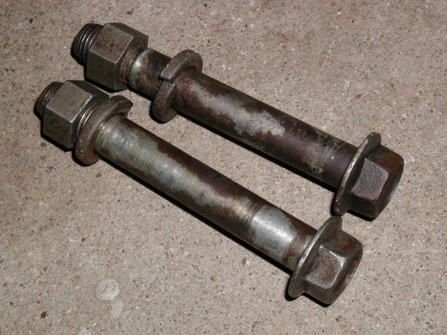

When I swapped the rear springs the first time, the fixed pins came right out. I still have them, I've never seen a set that nice.
