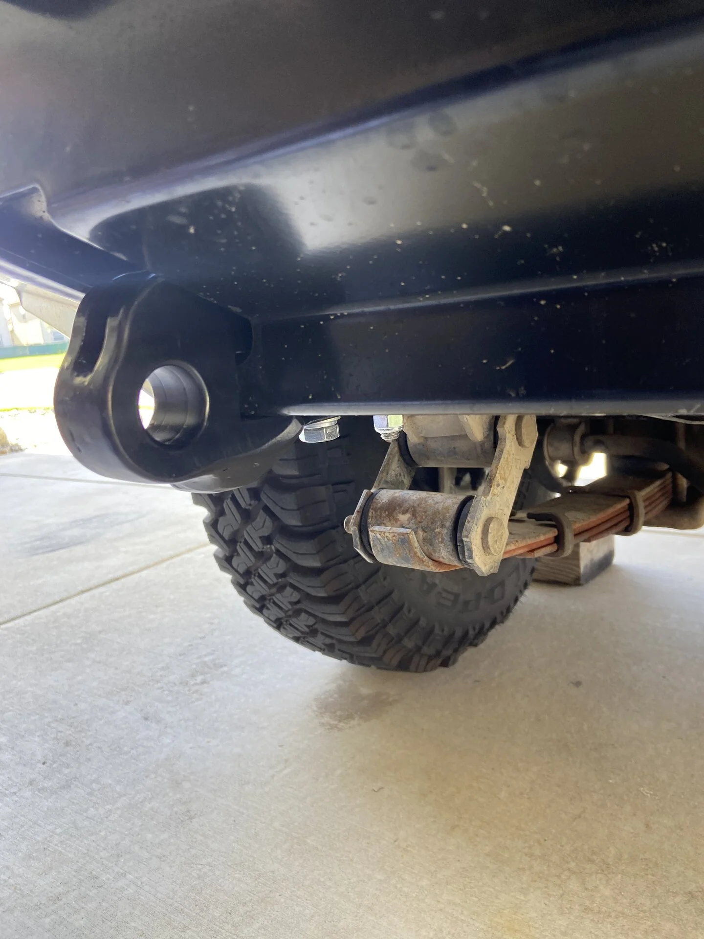

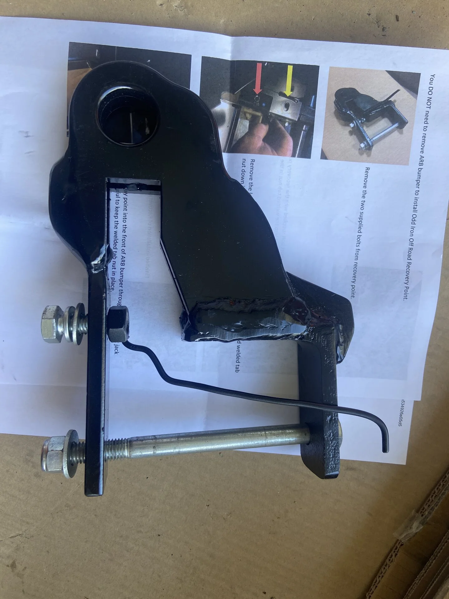

Installed the Odd Iron Offroad 70 series recovery point today. Only thing on the market that will fit with an ARB bull bar it seems.
Of note, they're sold as singles, so get two if you want to run a brindle for recoveries.
Your order benefitted from a recent design change. All of the new fabrications will have this area tapered to better accommodate soft shackles. 😊

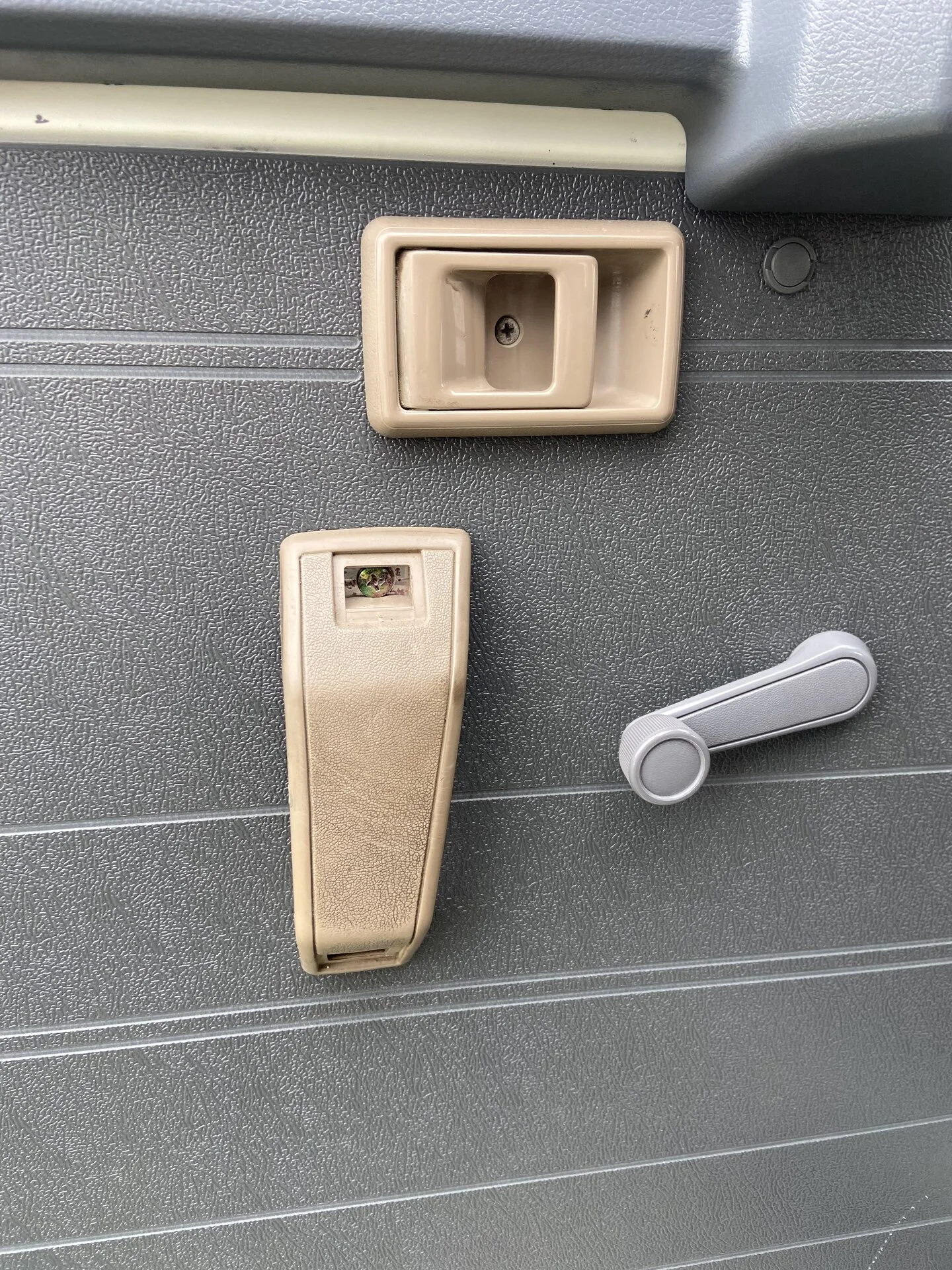

Finally color matched my door pull and latches.

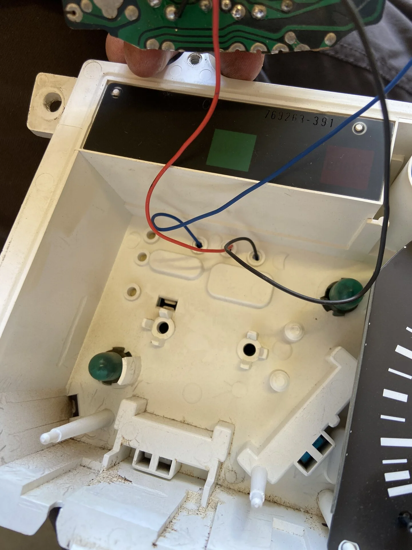

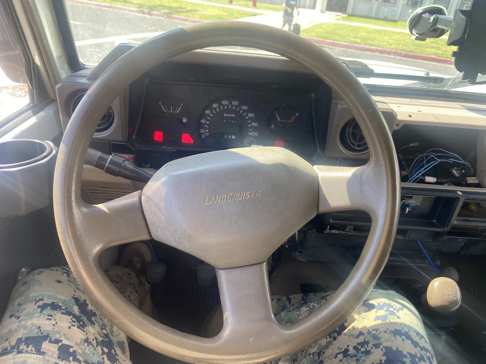

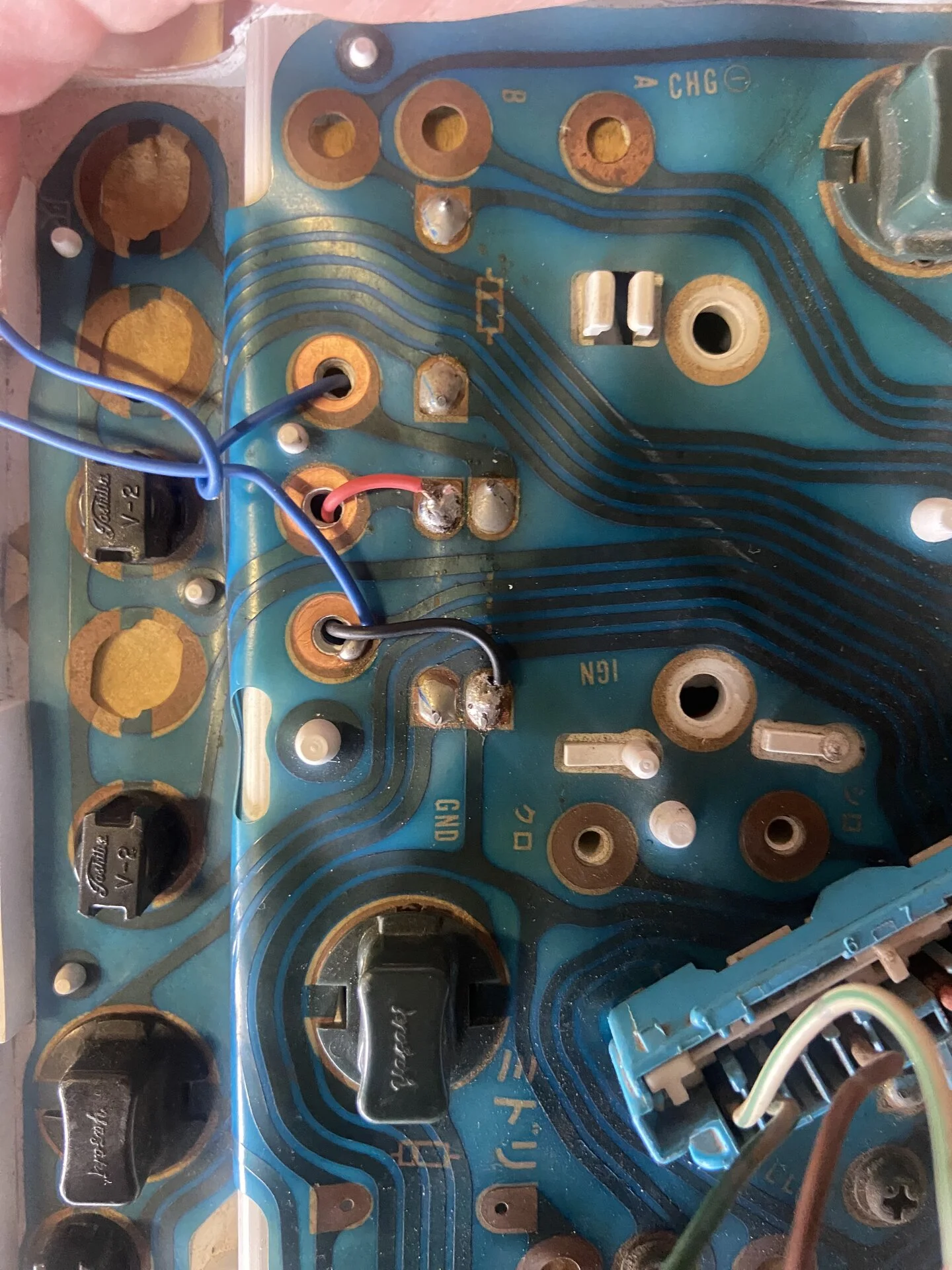

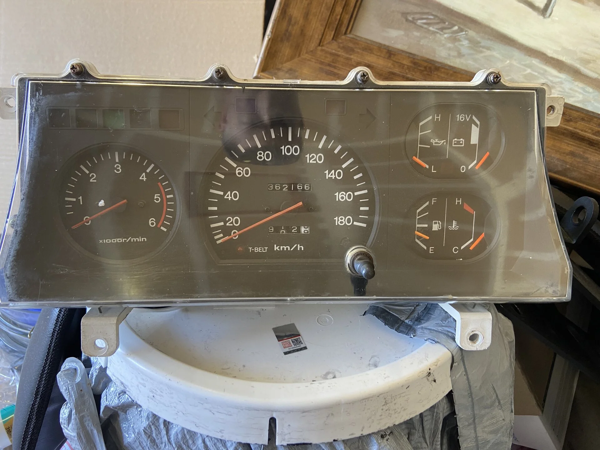

Do you have a speedometer cluster that doesn't have a tach? Doesn't have an oil gauge, doesn't have a battery voltage, goes to 200kph when that's totally excessive?
Well do I have good news for you! With the help of @Zee and @dzehner12 I was able to get this upgraded cluster to work in my troopy!

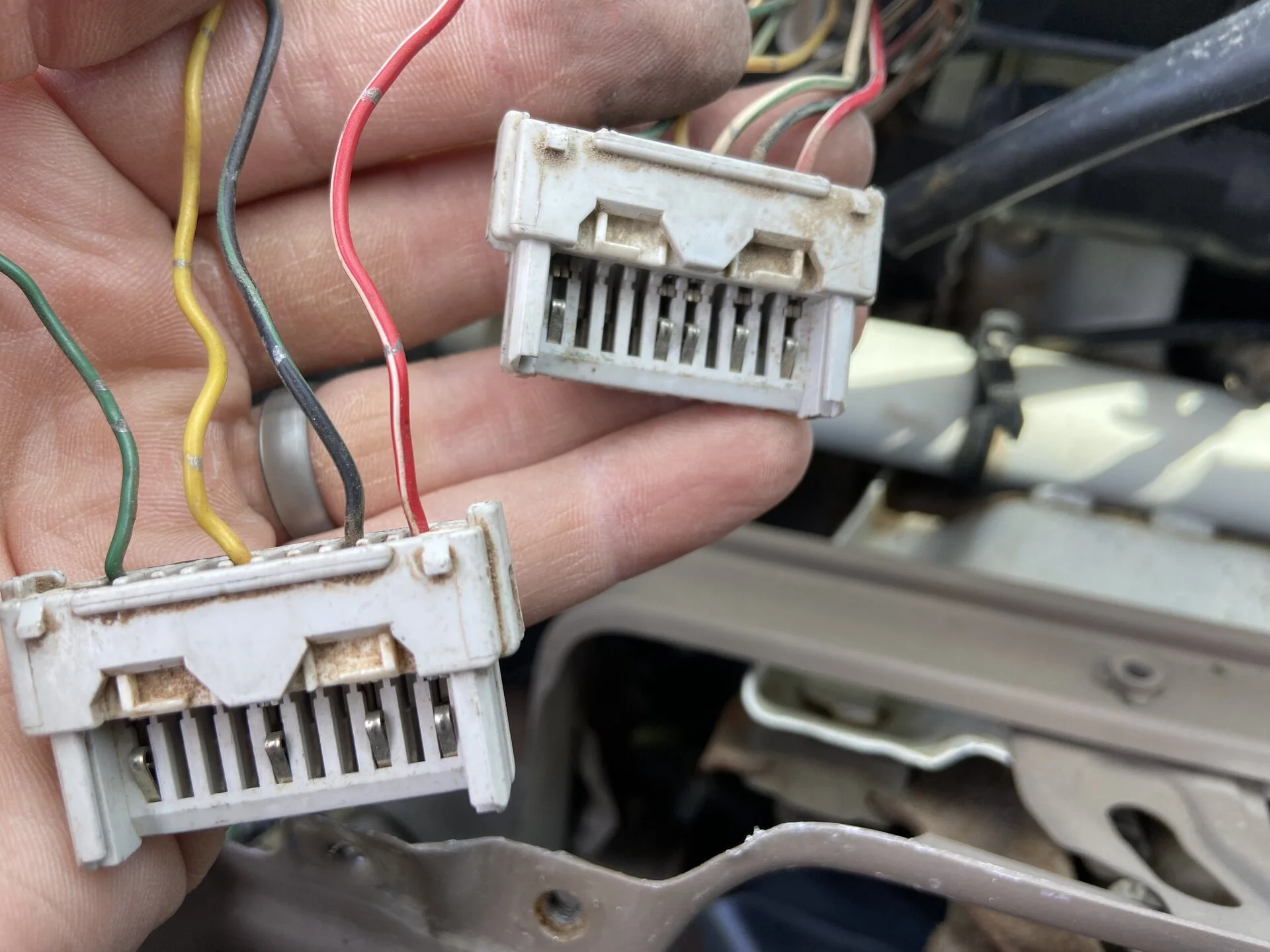

I have the wiring manual, but was told by @dzehner12 that this was relatively plug and play except for the oil pressure sender. The one on our troopy's is a single wire, the one for these clusters is a two wire sender. The plug is right next to the oil pressure sender, but I don't have the correct part to replace mine right now, so I just disconnected it.
More pics to follow.
Zee had to have his connections in Pakistan do some creative solutions to get the tach to work, but honestly I don't care what they had to do to make it work.
This is the oil pressure sender that needs swapped.
Also, does anyone know how to "roll back" this odometer? My troopy only has 251k km and I'd rather not suddenly jump to 361k.
