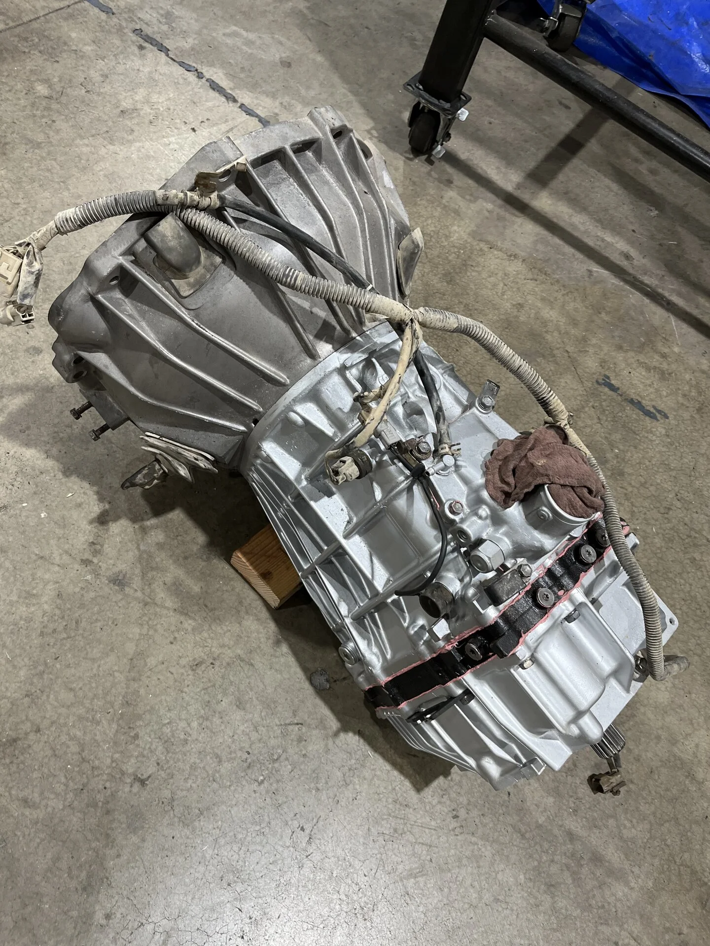

Clutch, clutch master. Rear seal, H150F rebuild started by Cruiser Tech in Laguna Hills California.
Transmission has been rebuilt, new synchros, new heavy duty clutch.

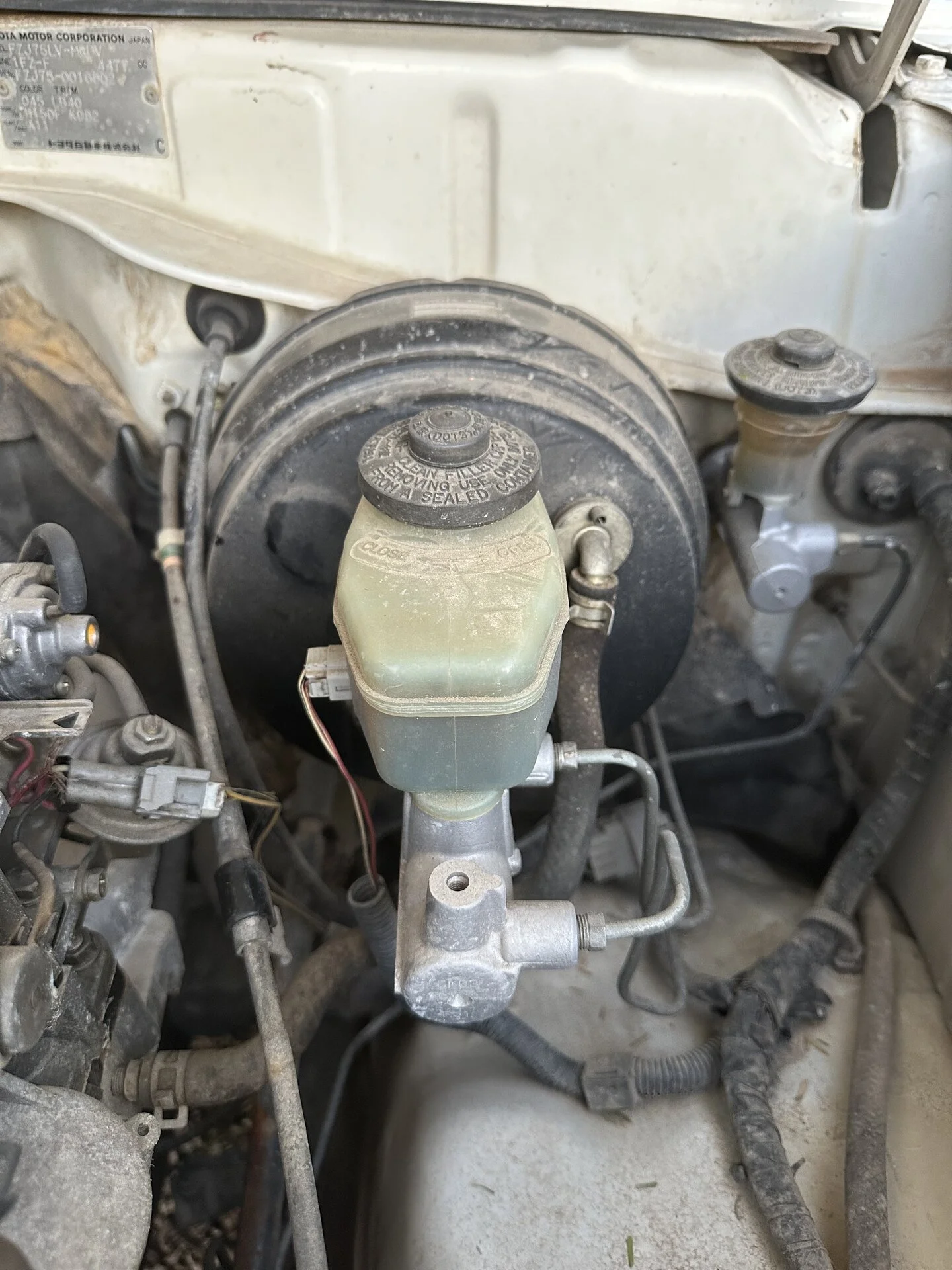

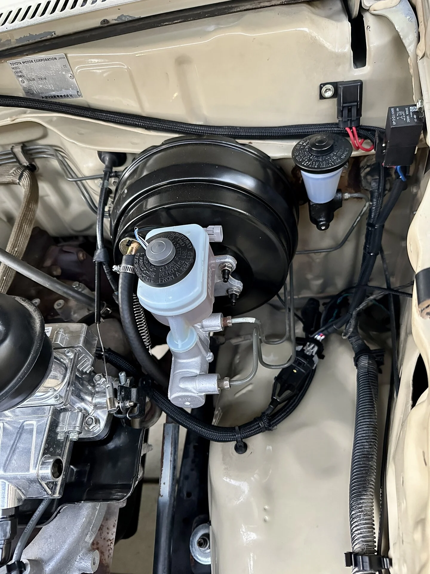

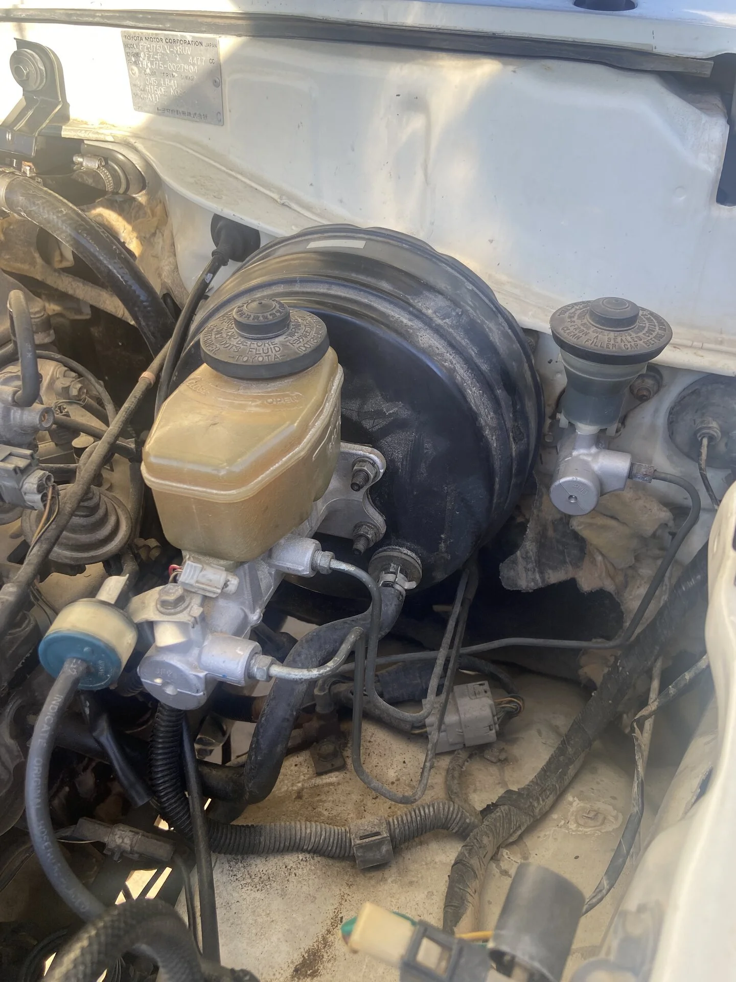

My local shop was trying to install my double baffle brake booster from the T100, but saying they couldn't get it to work.
Based on other threads, was under the impression that the T100 double baffle booster was a relatively simple swap. What went wrong here?
Do you have some photos of the double-baffle booster? I've got a T100 and a Troopy in the driveway... may be able to have a look-see and help out on this.

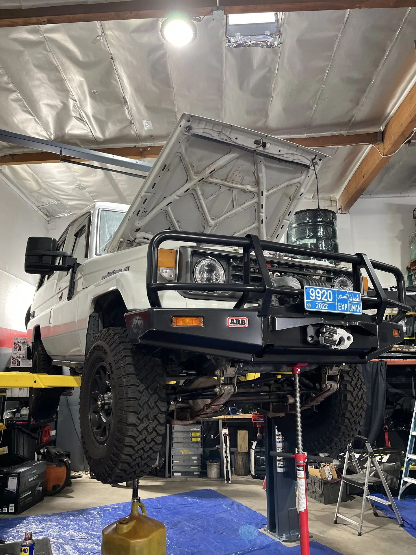

Got the truck back from Cruiser Tech in Laguna. They did great work on the clutch and transmission rebuild, but now having a couple other issues.
I had them install a new power bastards alternator in prep for my build out and eventual dual battery setup. However, now my battery light stays on, and so does the air filter light.

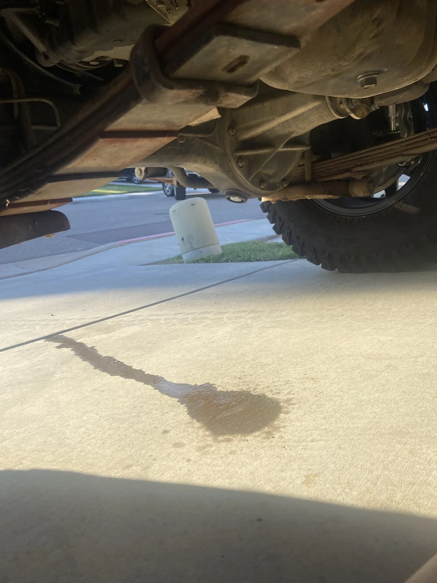

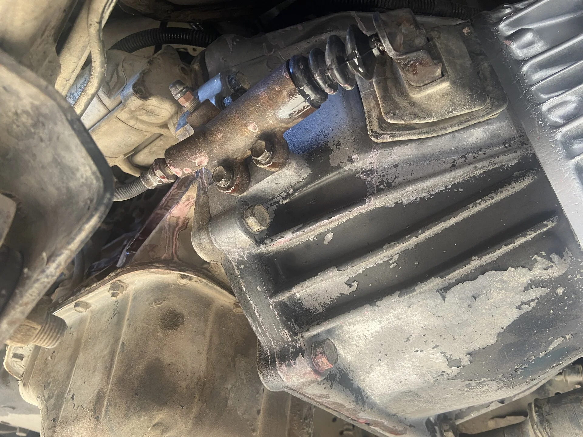

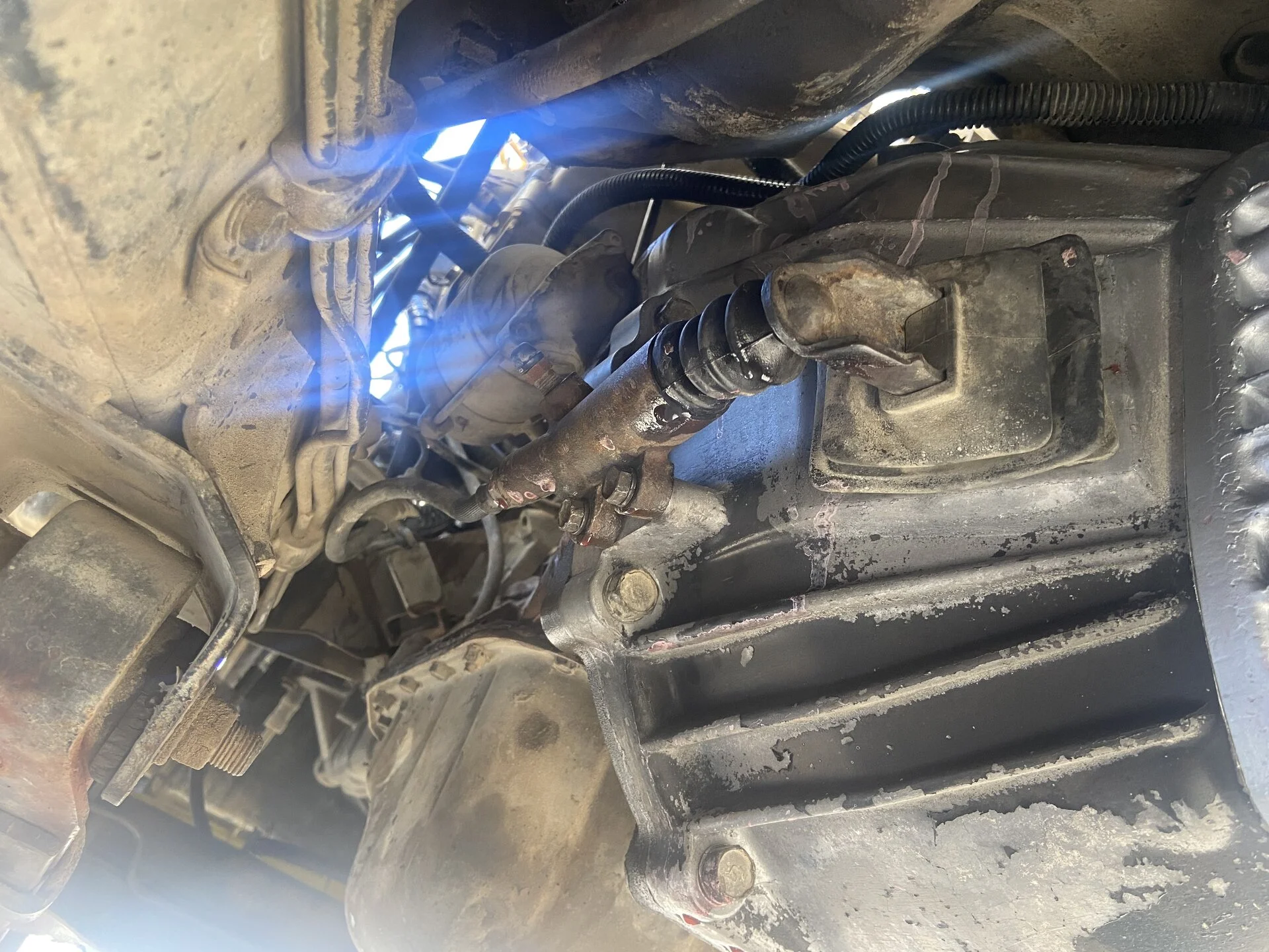

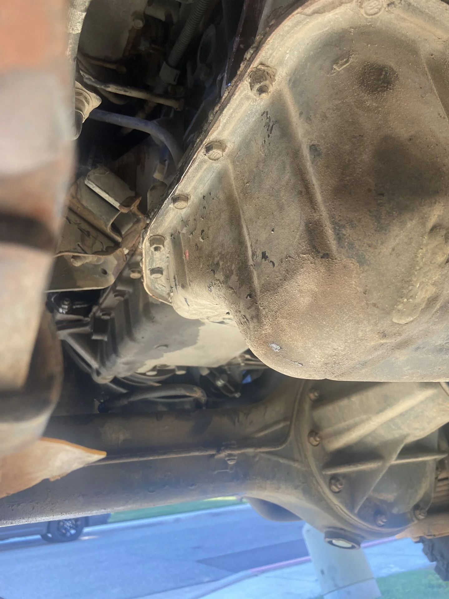

My clutch slave cylinder also is now leaking, unsure why they wouldn't have just replaced while they were in there.

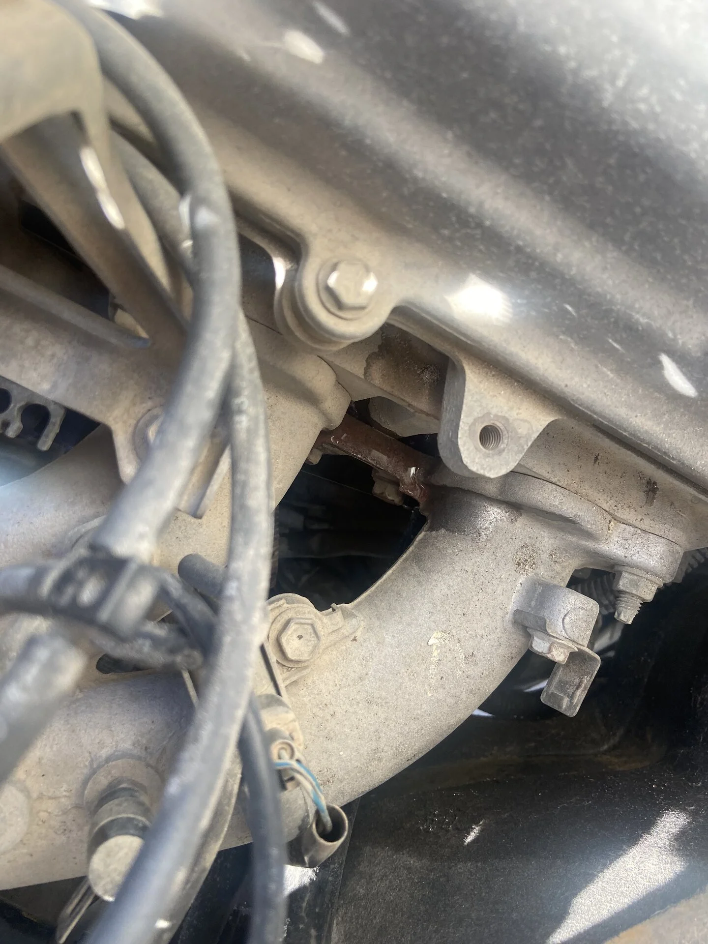

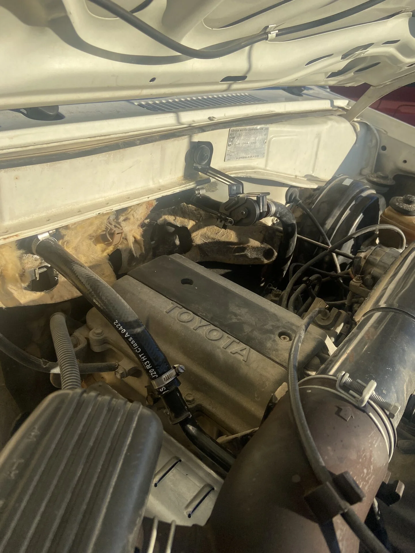

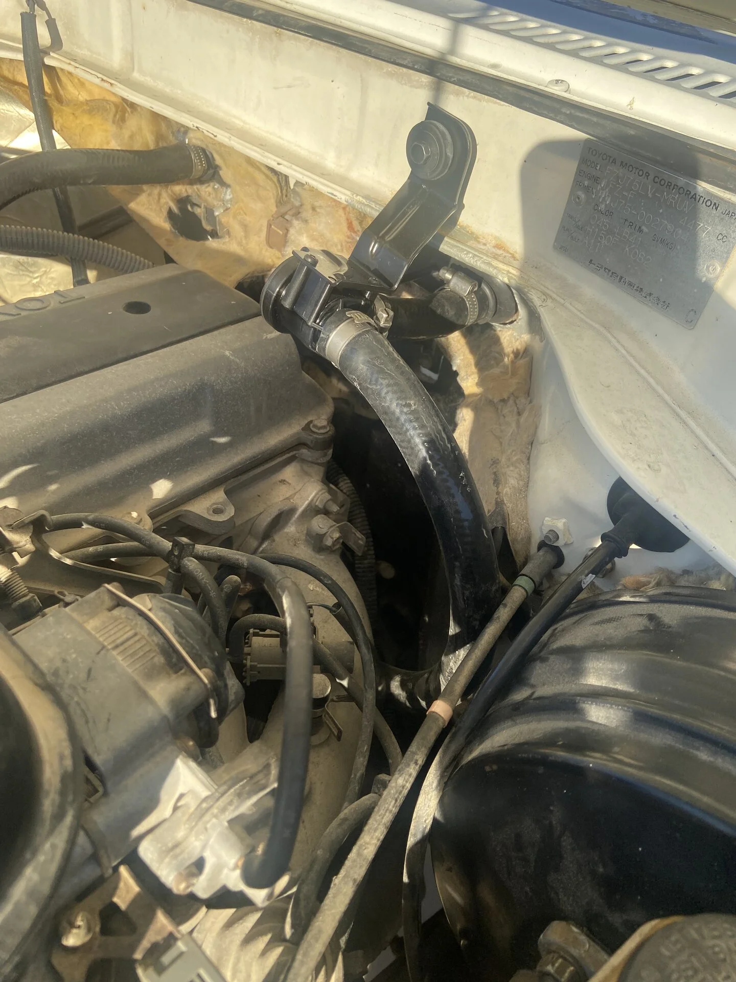

Cruiser Tech also did some work to get my heater working, no major concerns, except the hose into the block is now leaking too.

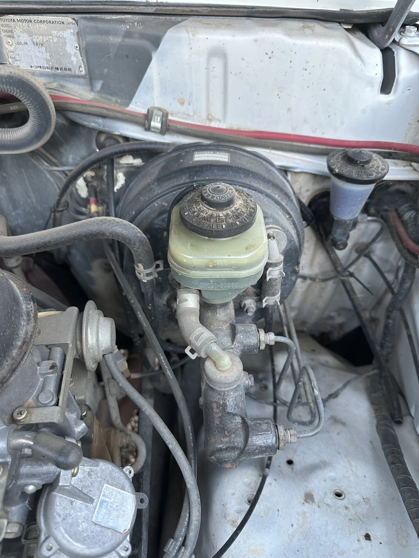

Finally, they said they couldn't use my double baffle brake upgrade. This is what my setup looks like @Honger
Little confused as to why they couldn't get it to work.
Ugh, worm-drive hose clamps. Get those out of there. ;-) Too bad about the slave, but that's often how it is - the other parts working properly/strongly now putting stress on the non-replaced ones. That's why often it makes sense to follow your "while I'm in there" instincts.
Did they replace the heater core? That's a very, very common failure on Middle East trucks. (As in - pretty much guaranteed). I would strongly suggest replacing it if not, otherwise it's a terrible mess - and an immobilized vehicle.

Yes, working with them time now. They said they're unsure what is causing the battery and air filter lights to come on because of the chopped up wiring harness I got from Oman.
They'll work the heater issue and slave.
This vehicle never had heat, I got the heater sent to me and added it myself.

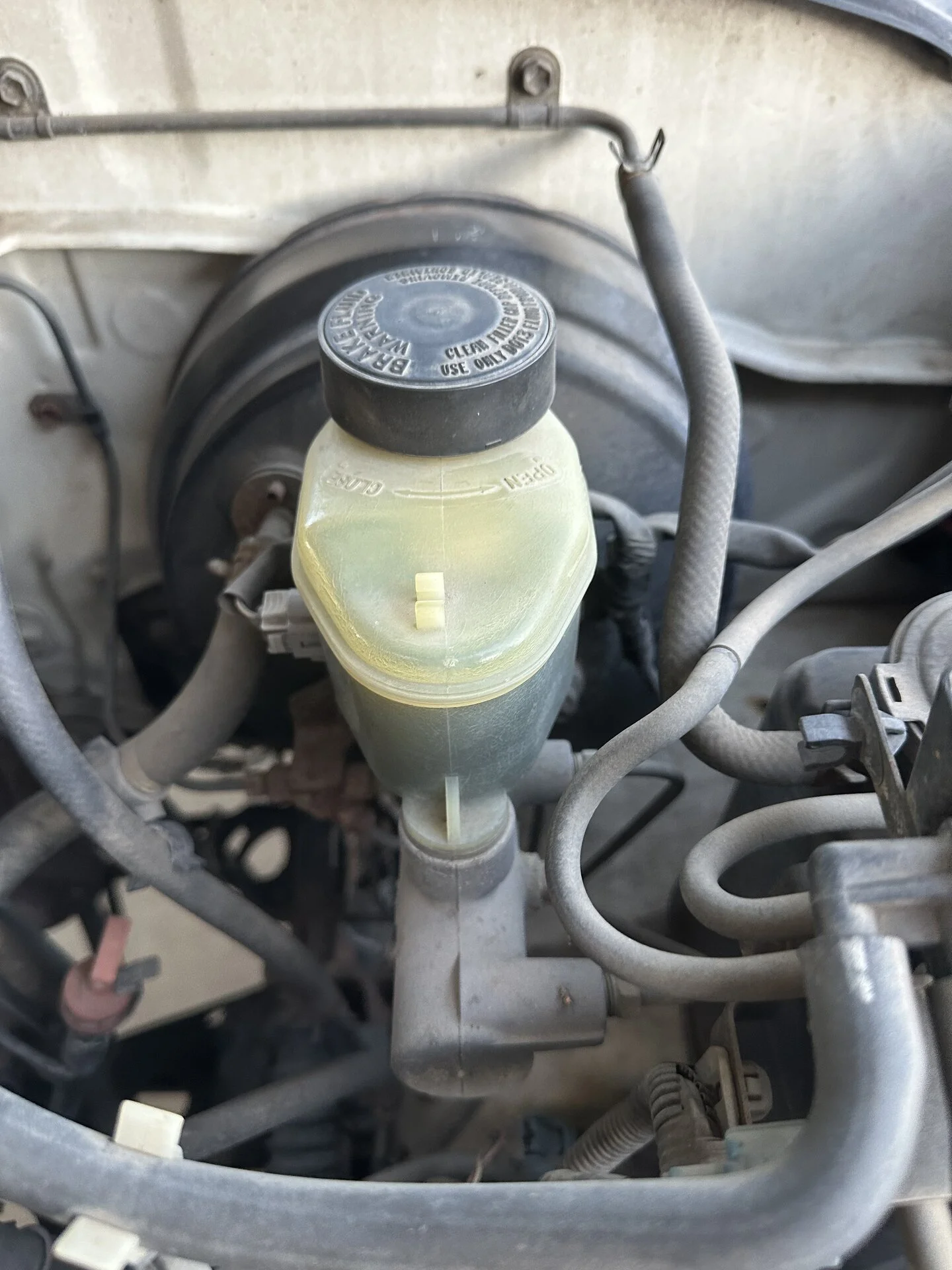

Here’s my Troopy booster and master…
And my T100 booster and master…
The T100 booster measures out to 1/4”-1/2” bigger in diameter. T100 is right at 9”… FJ75 is 8.5-8.75”.
