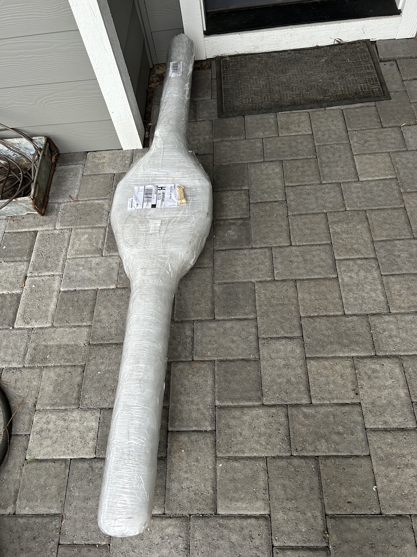

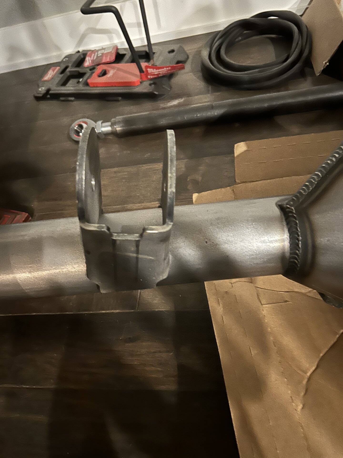

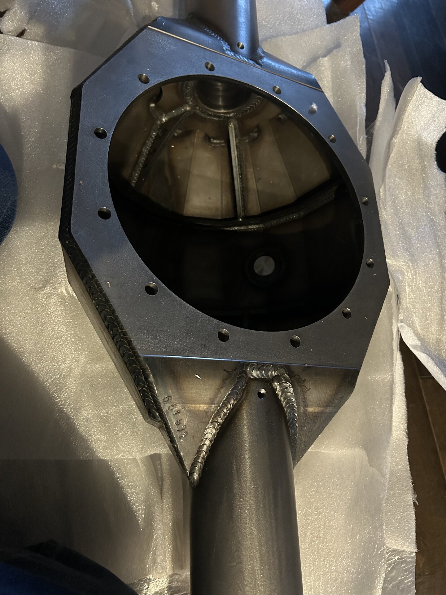

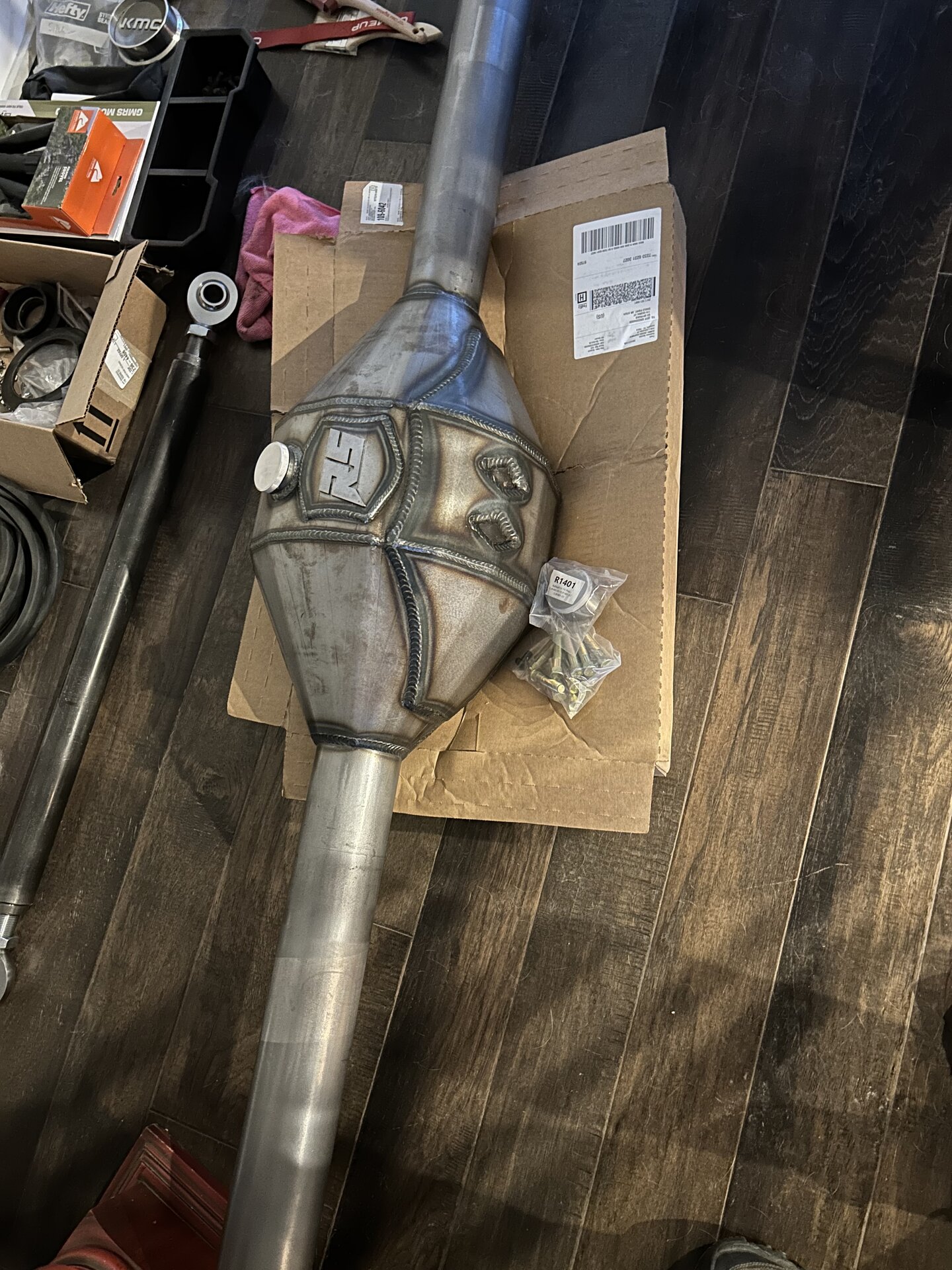

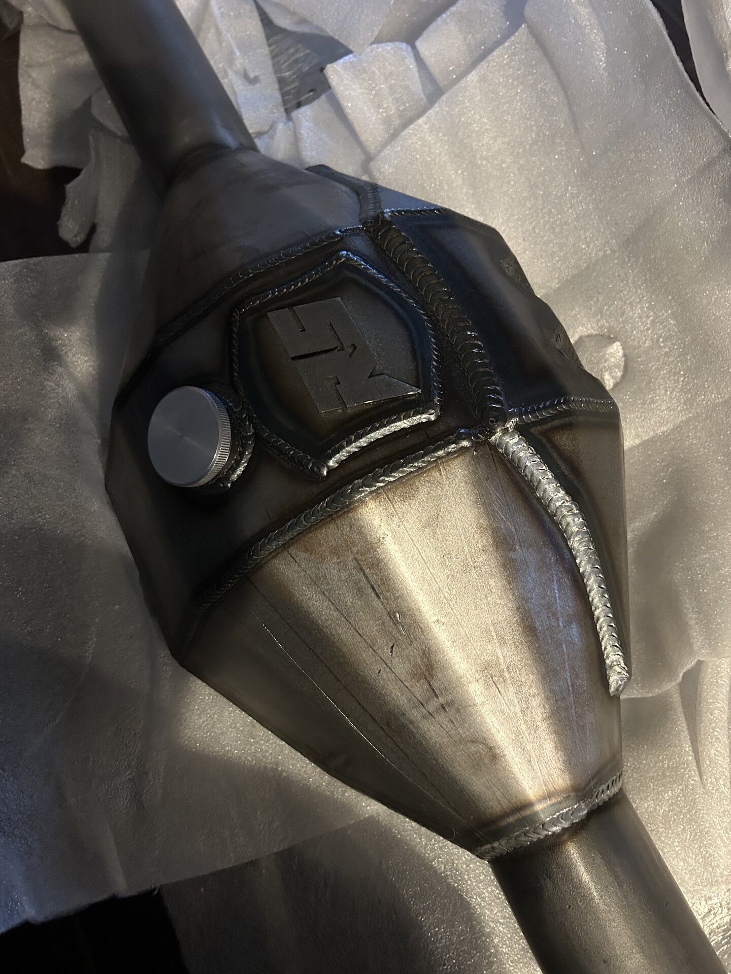

Rear axle showed up today . Ruffstuff housing. Tundra diff Dana 60 outers . Very well made housing

any reason you went with the RS housing vs FROR?
I did not Buy this This is My Friend Mikes 40 i am just building it . But if i where to compare the RS to the FROR i would have to say the RS looks to be built better . Not in any way saying the Diamond is not built well They are great . Just the RS welds look cleaner and they do add the extra skid .

why the tundra out back, I get the big parts but options & cost are higher than a 9 ", or it used to be.
Well Because we had the Tundra 3rd and what Toyota Diff is stronger than the Tundra ? I dont want to use one up front because the packaging gets tight and would be hard to make work . So for the front we will make a 609 . Mike had purchased a 9 inch rear the only problem was it was stock width . So we will use the 9 inch 3rd for the front .
