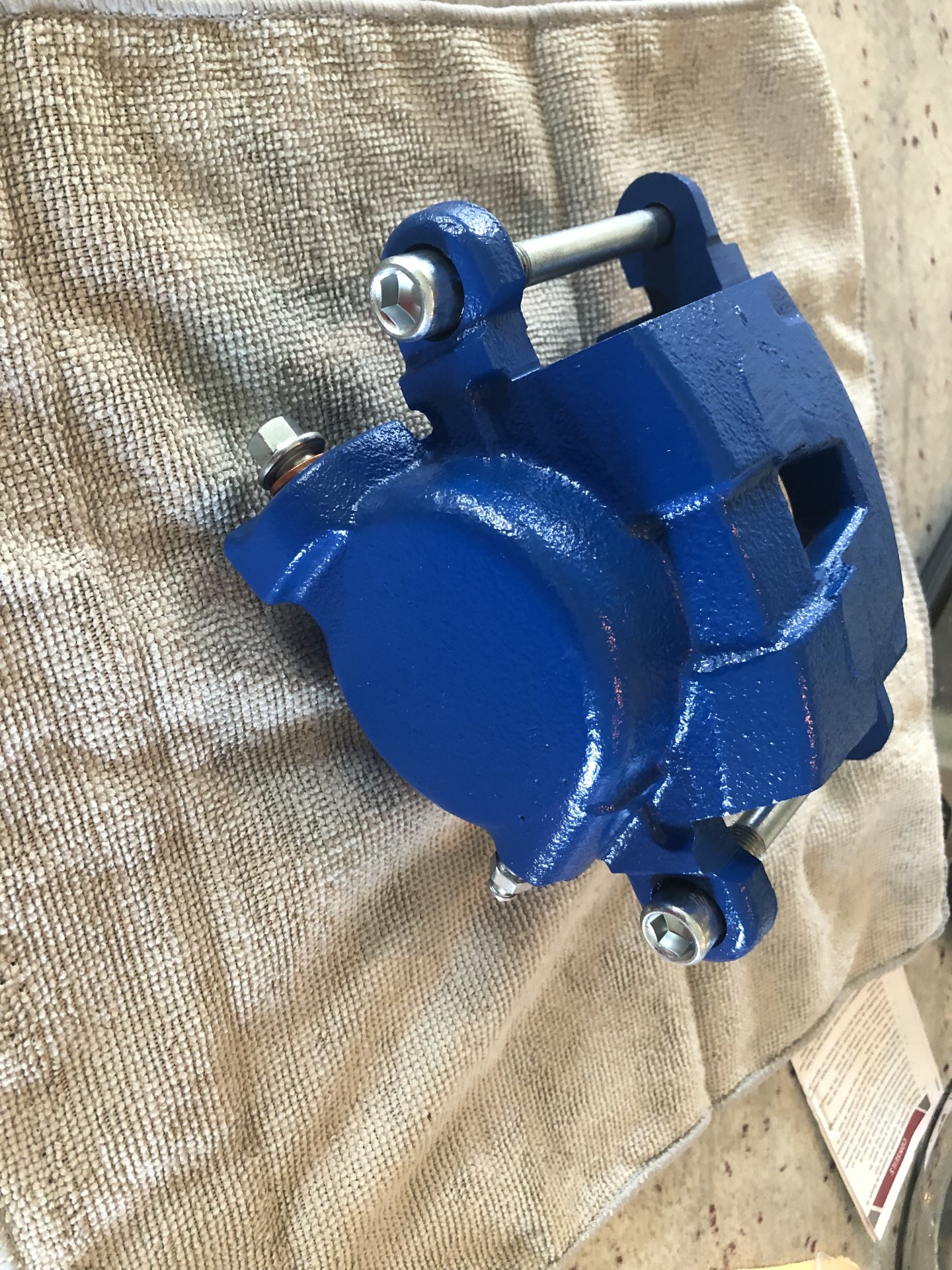

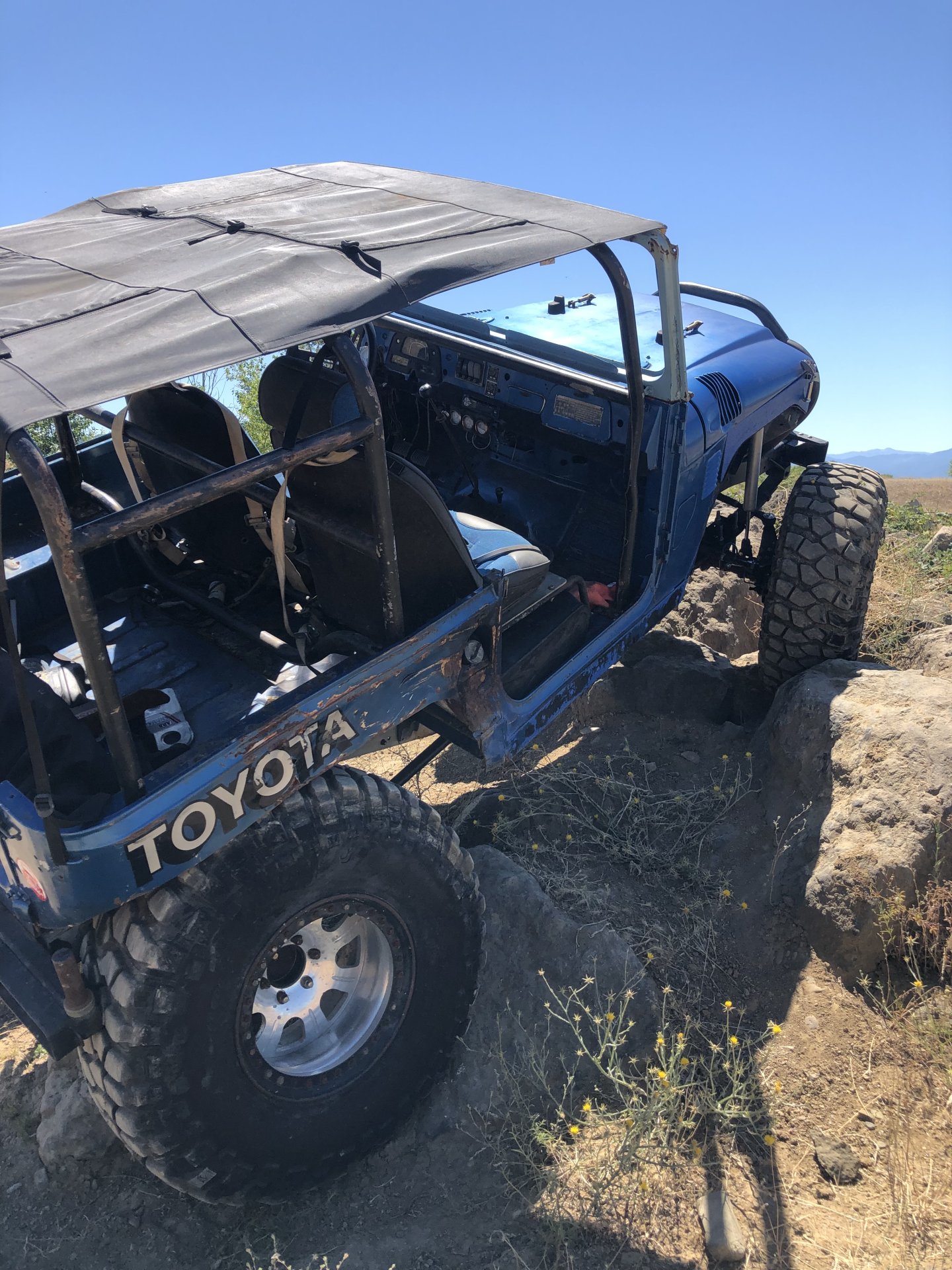

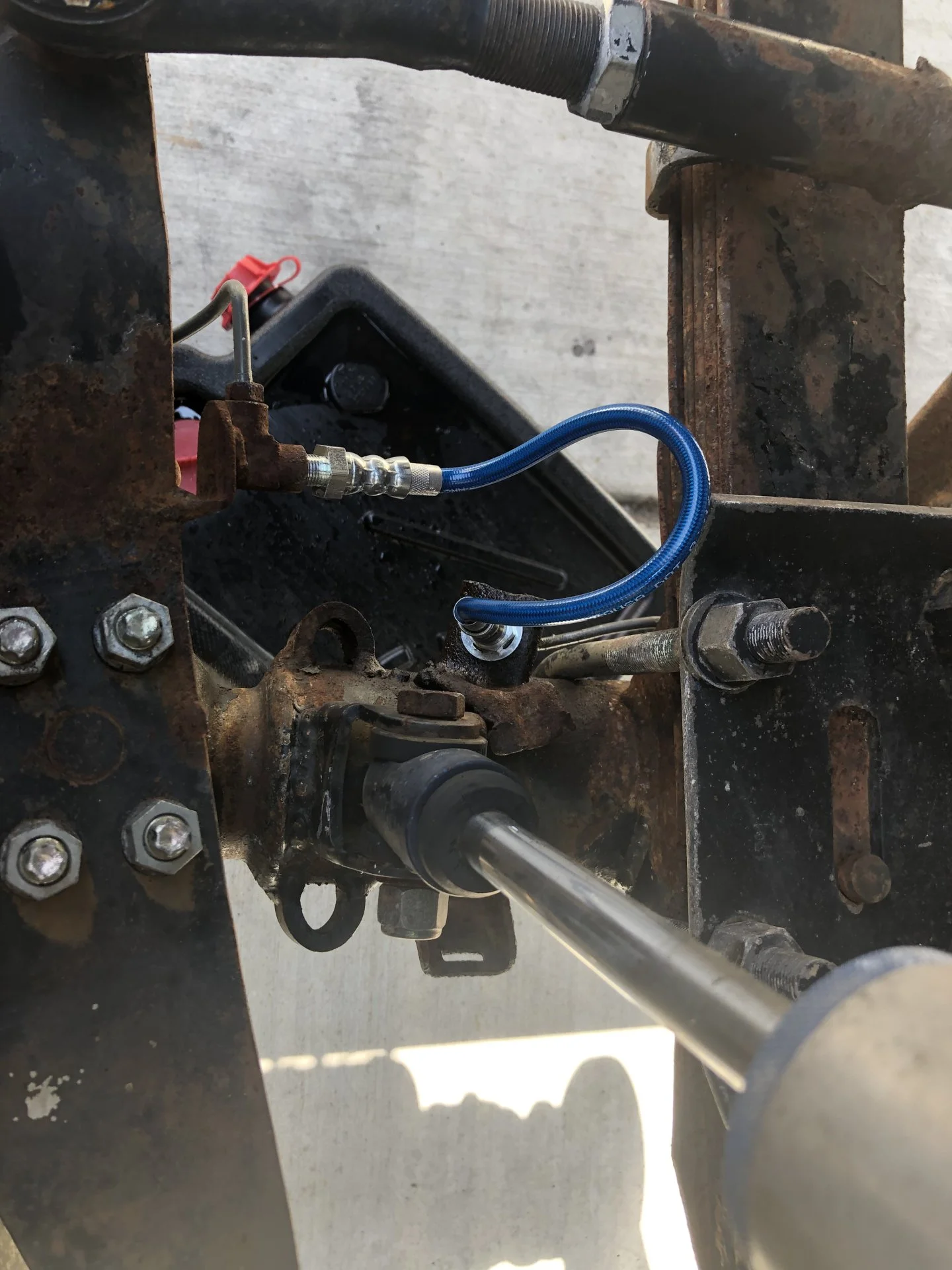

So I figured I would start a new thread on Old Blue so I don’t clutter up the Honey Badger . This is My Friend Mikes 40. I believe this was his very first Land Cruiser that he bought when he was like 18 or something . I will let him chime in with all the details. Old Blue is a veteran of many GSMTR runs. And I don’t think there is a trail in Tellico she has not done . Fast forward about 15 years I talked Mike into bringing her out west . Old Blues last trail had a lot of carnage and she was just sitting since . Basically nothing worked anymore. And if it was not broke , rusted off or dented it was no longer there 😃. The first thing I needed to do was to get it running again . It has a GM TBI. . I took that all apart and rebuilt that Drained and flushed the fuel tank 😳. It was nasty . New coil. Some new wires and she kinda ran again . The Rear wheel had broke off on the last trip. And did a bunch of other damage . I got that all fixed and new rear disk brakes . The Front diff was broke so I knew I would have to tackle that at some point . Then I got this great idea that I would take Blue to Sierra trek this year 🤦🏻‍♂️🤦🏻‍♂️ . So the past 2 weekends I have made a pretty big push . I will just say this if it could be bent broke rusted or hard to get that is what it has been the past 2 weeks . With the clock ticking . I had a brand new front diff with a ARB so I figured I better get started . The new diff had a Toyota triple drilled flange. And of coarse the drive line would not line up to any of the patterns 🤷‍♂️👎. . I pulled the front driveline off my 40 and it lined up with the diff but not the T-case 🤦🏻‍♂️ Ok plan B. Just swap out the yoke . The front springs no longer had any bushings in them So that was next . I will circle back to that later because I think it is a very poor design with how the shackles are , but they work for now . Now while I was messing with that stuff I caught my eye. Hmm why is the axle in a different spot on the spring from one side to the other 😳. Upon future inspection the spring pin had sheered and the axle was 3 inches back . And on and on we go

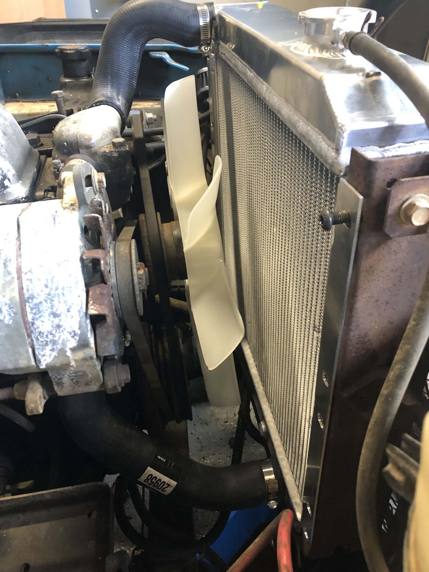

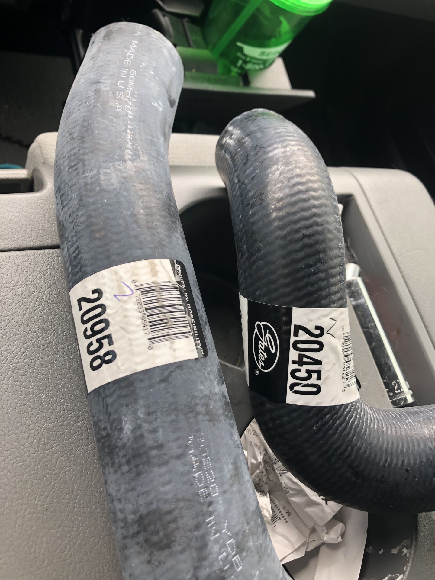

Once it was running we found out it needed a new Radiator the old one worked ok but it was not mounted well . Mike sent a Radiator support and a new Radiator. A couple new hoses and we are good 👍 or so I thought. Nope water pump leaks now 🤦🏻‍♂️ So we got a new water pump and now all is good

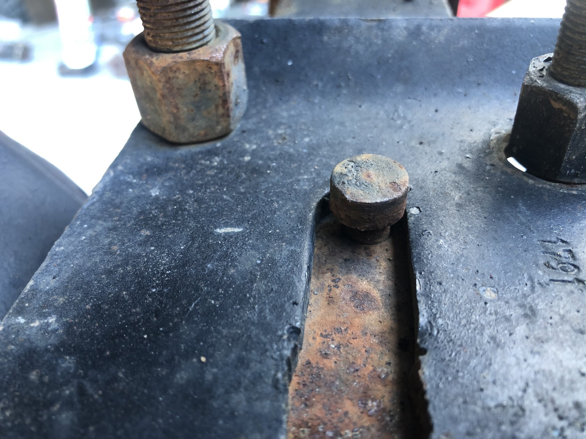

Radom pics of the spring center pin. I changed out the spring plates and u bolts.

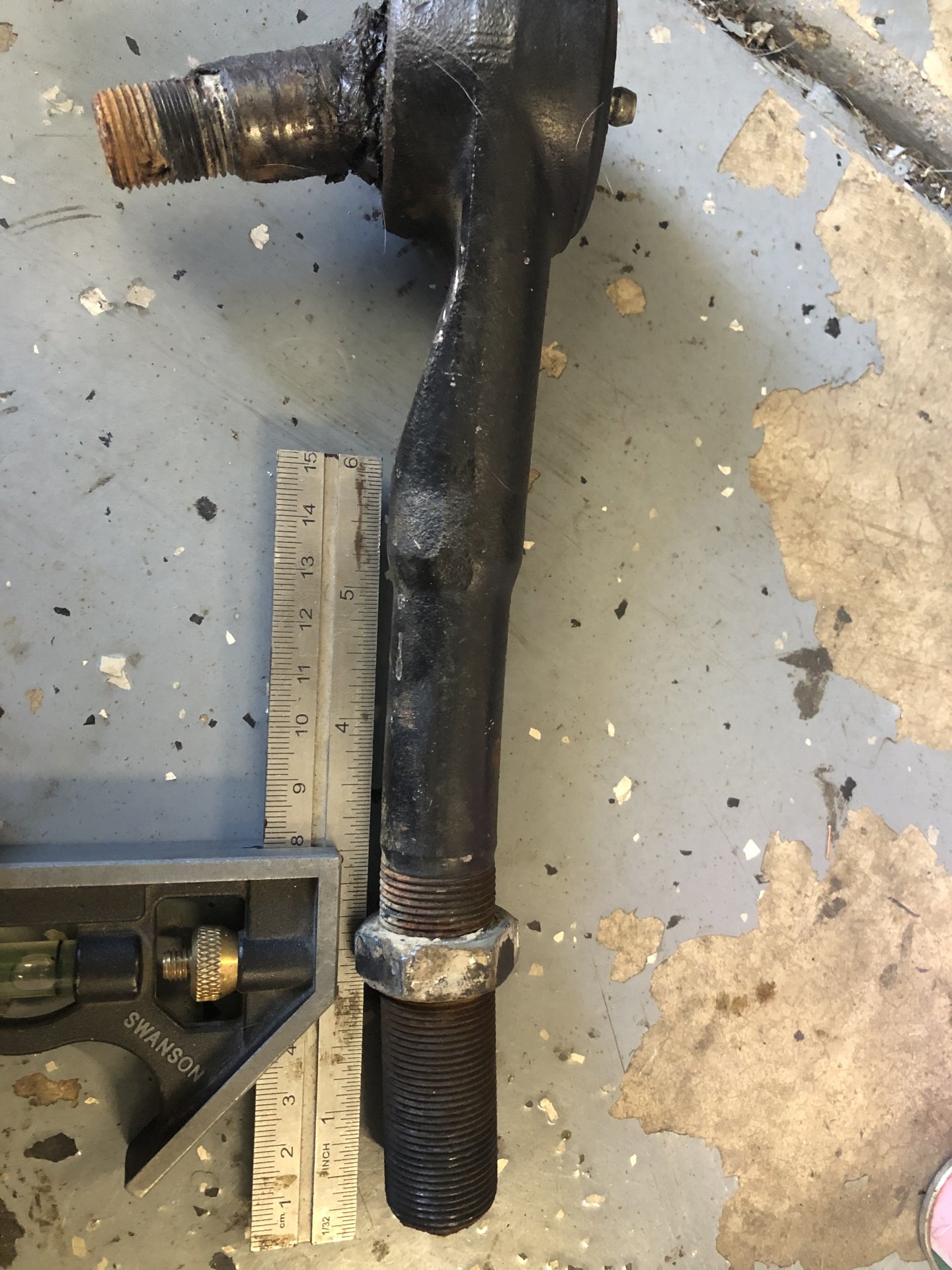

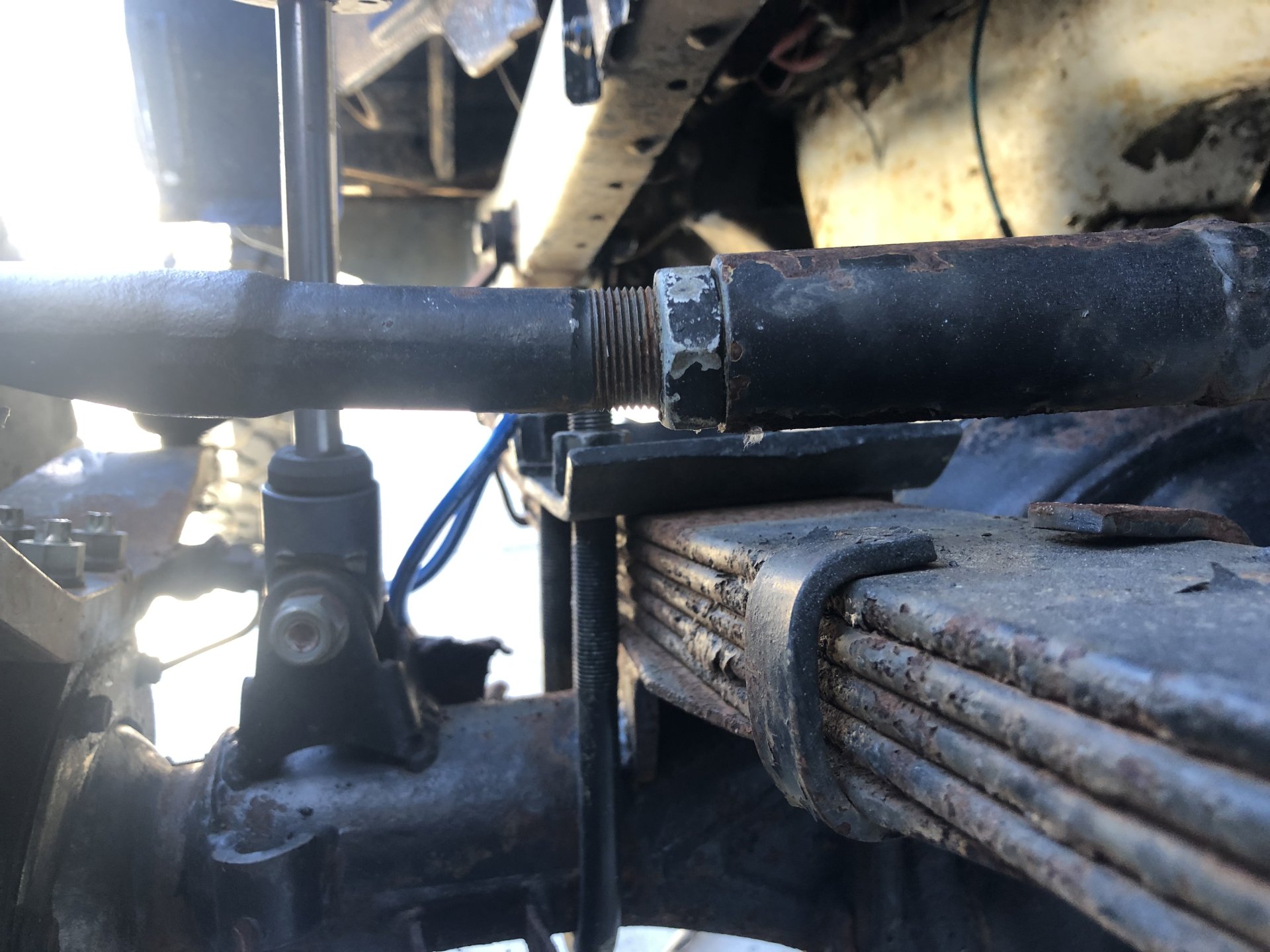

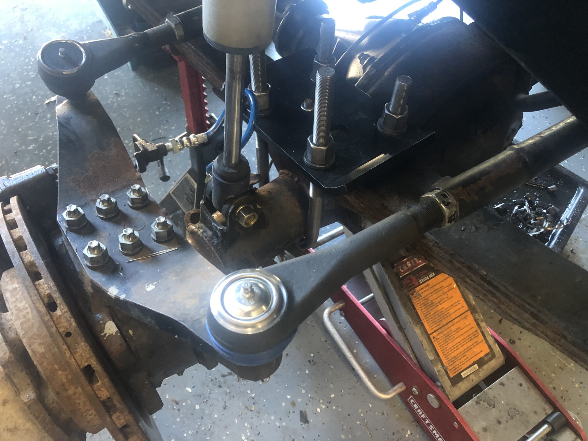

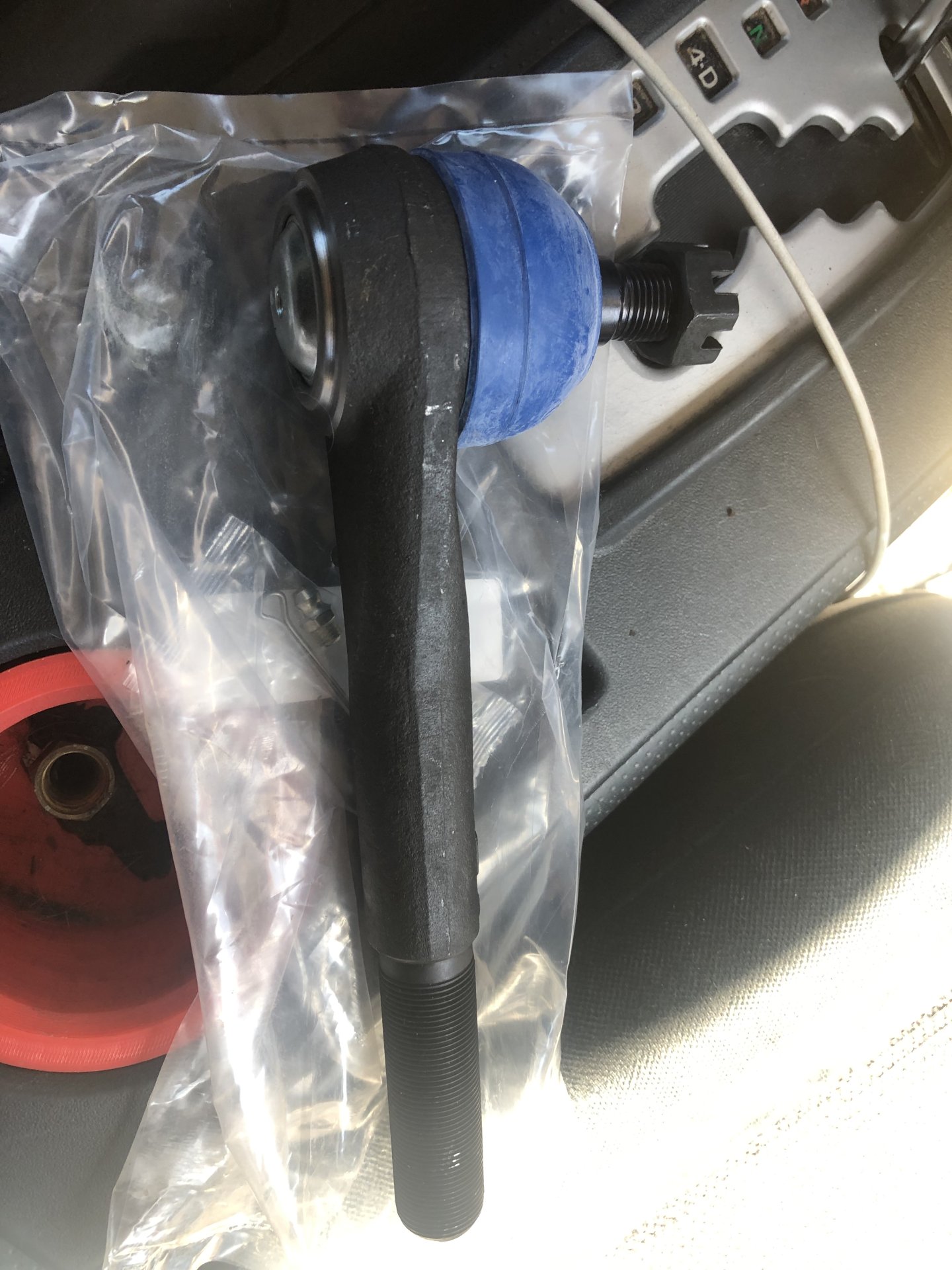

Aww neat the tie rod end is bent. Who bends GM 1 ton tie rods 🤷‍♂️

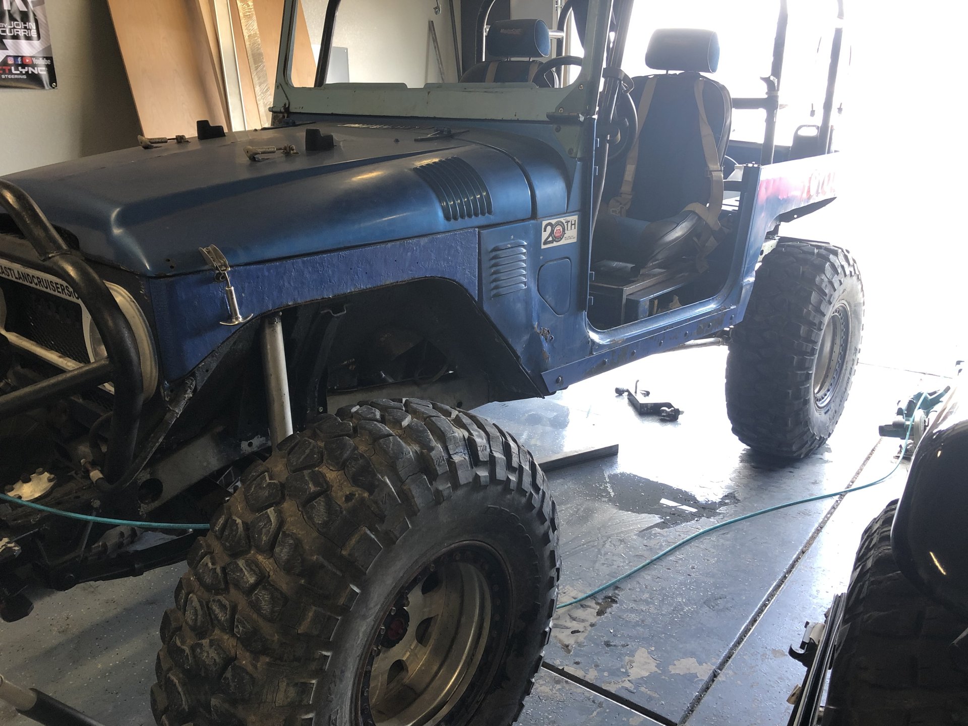

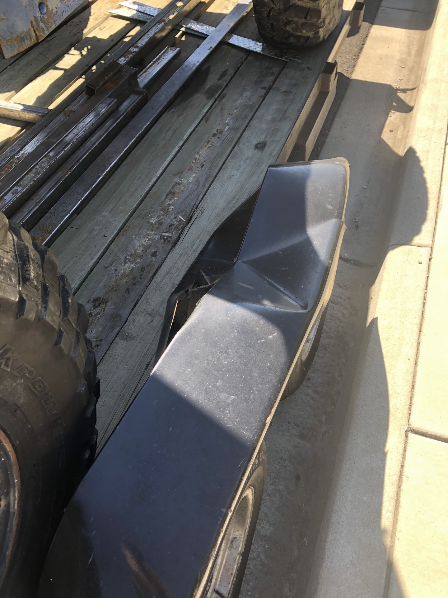

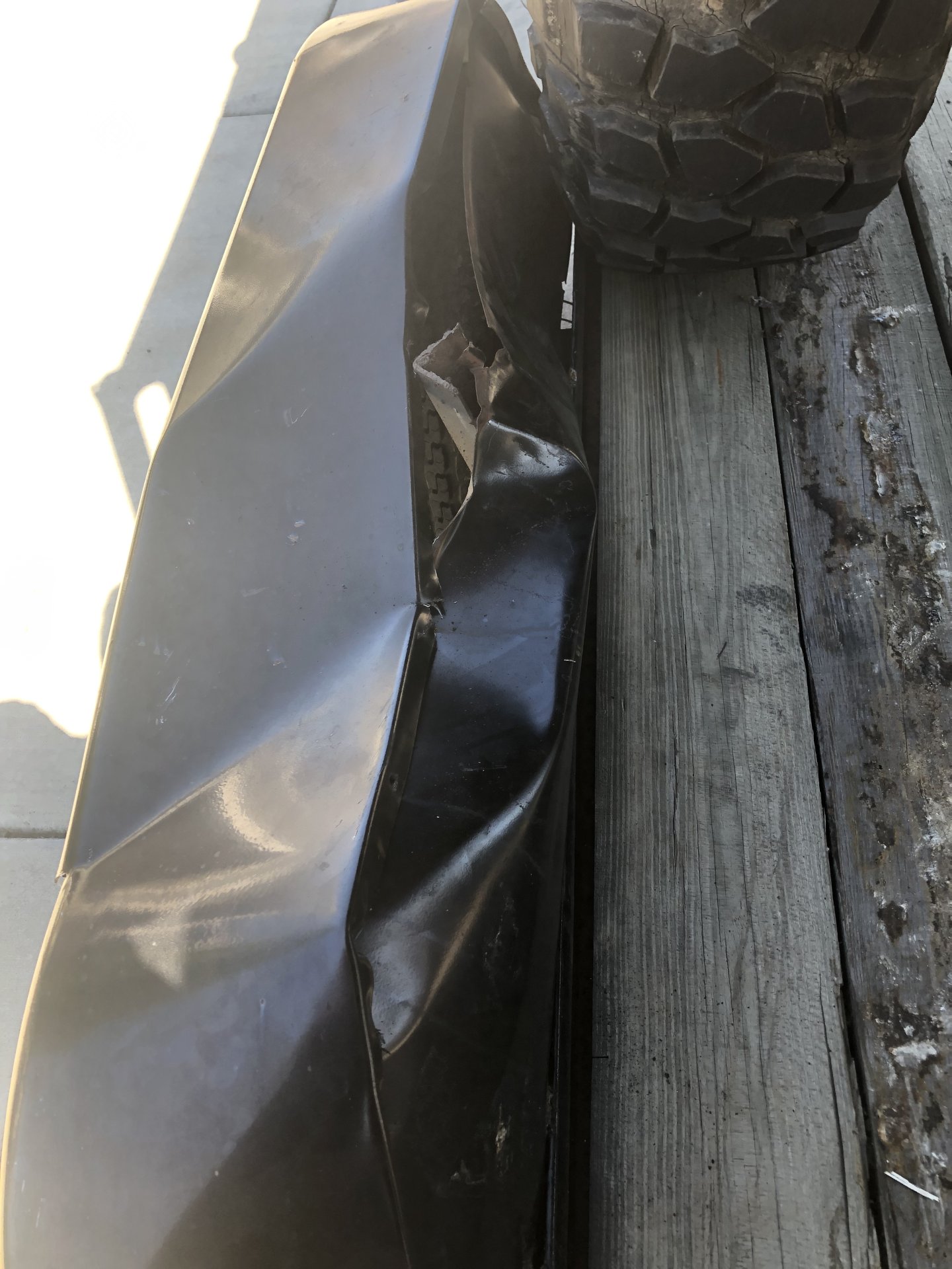

Well finally I think it’s getting somewhat close. I mean I have 2 weeks. So today I figured I better at least try and drive it. Before I take it straight to Fordyce . Was loading it on the trailer and happened to drive over the fender Neat. This is going to be a good day

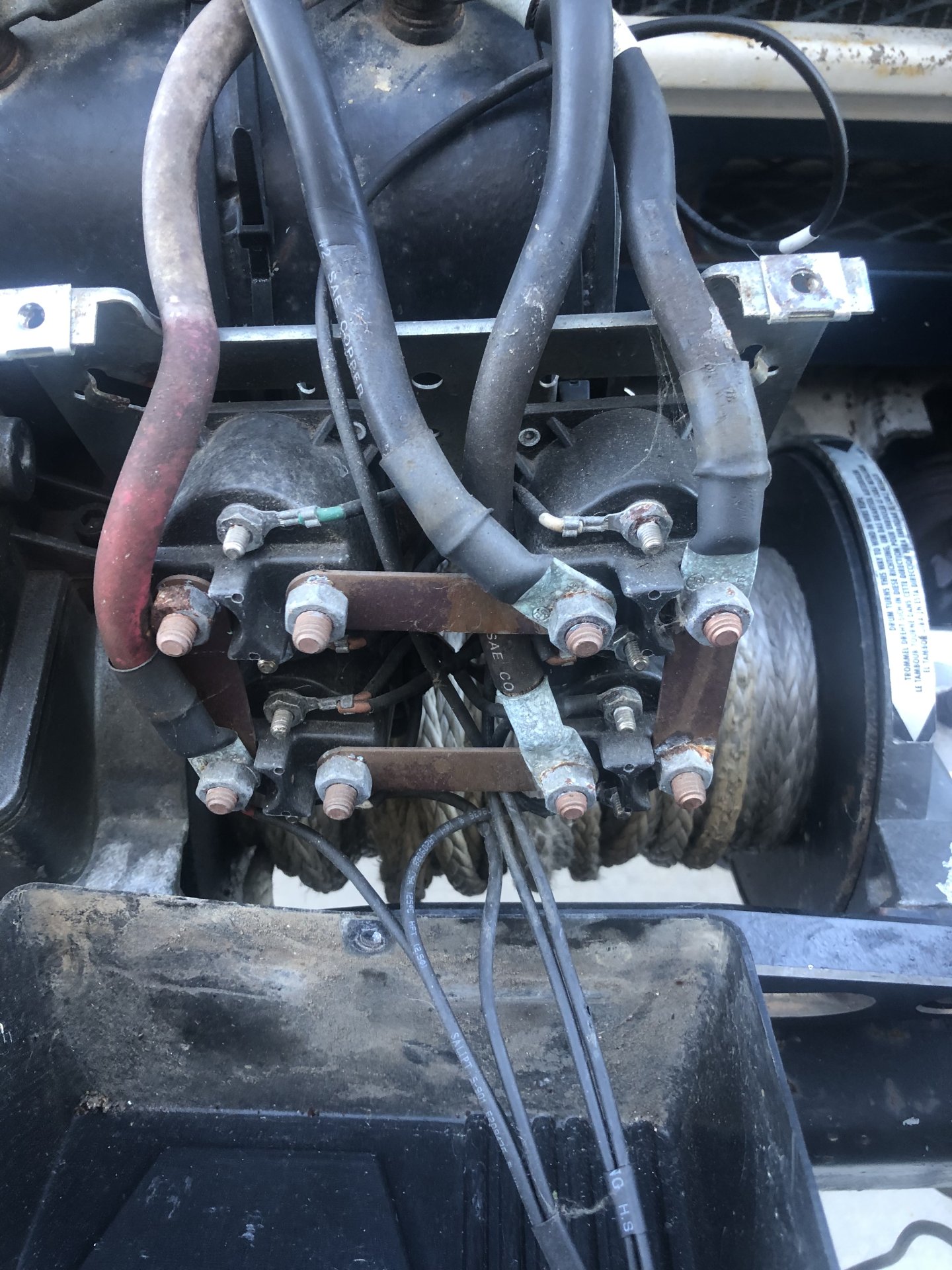

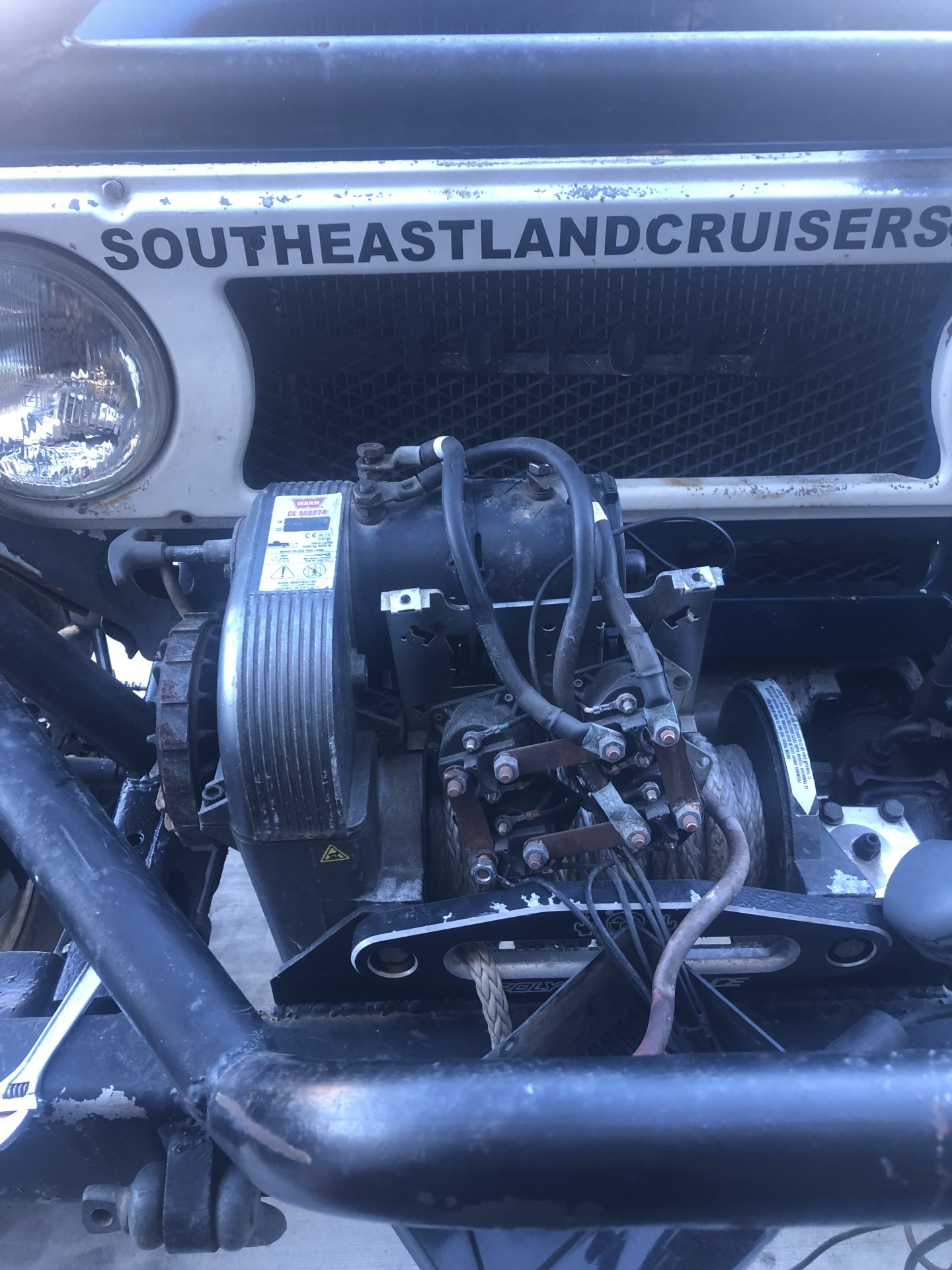

Figured I better put a new winch line on since it is pretty probable I will be using it at some point . And we have nothing.Wonderful. So we will circle back to that this week

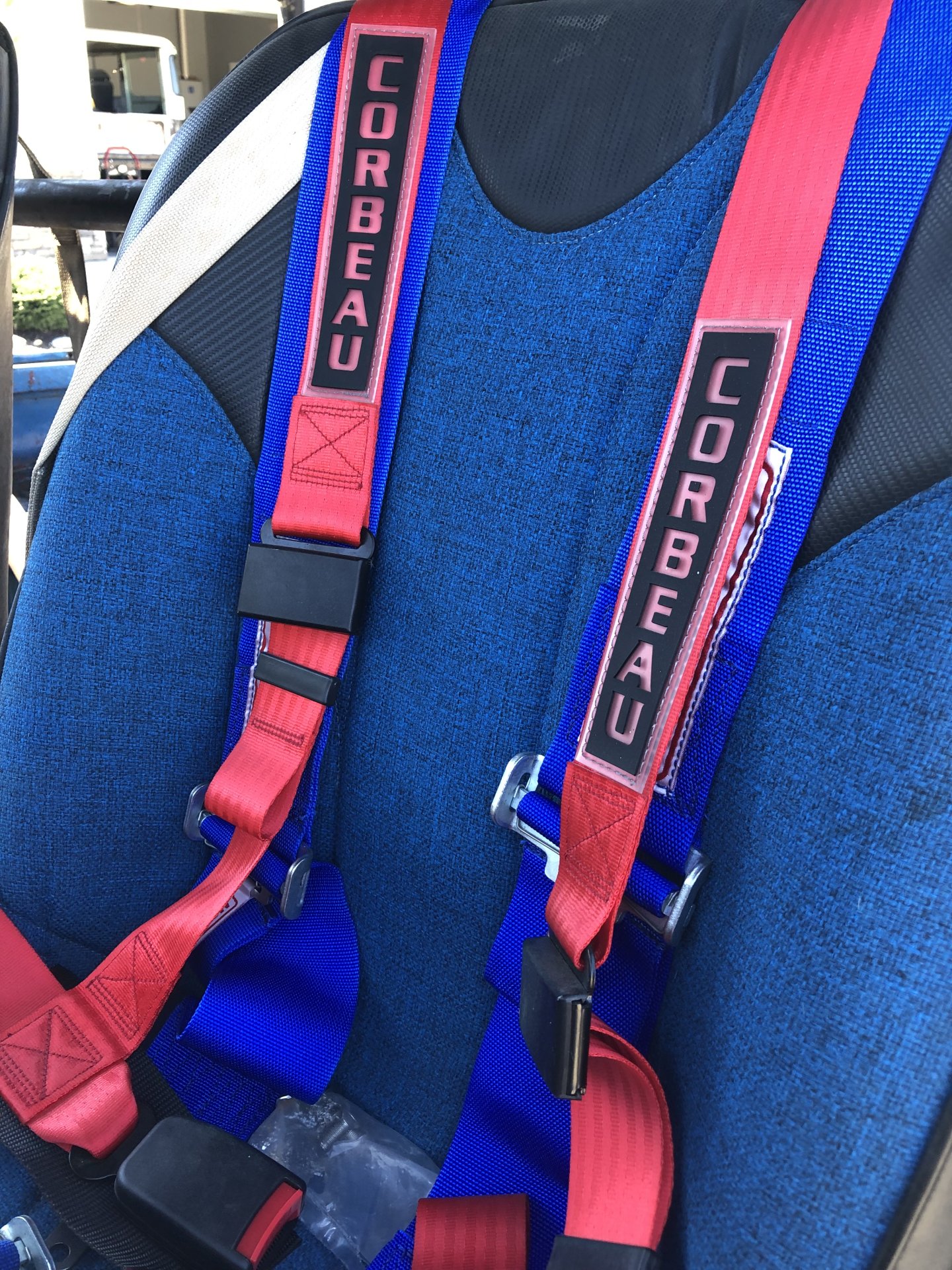

We have a new set of tires coming . Mike is sending new winch parts. And I think we are going to just upgrade the winch motor now . I tried to put the harness on but the buckle would not work. Lol. Why would I think it would 😃. I have some new ones so I started putting those in tonite

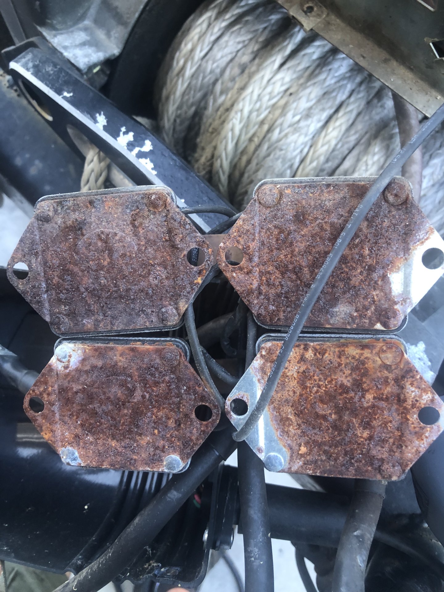

Get rid of those old solenoids and throw a contactor in there. Simpler wiring, and more reliable.
Yes Mike is sending one . I have a couple winches but they are normal style so i cant use them . If Come Up had one that would work i would put it on . But the 8274 is a good winch just needs a tune up
Maybe i was misunderstood. I have an 8274 on my truck. I got rid of those individual solenoids and put a winch contactor on. Either warn brand, or Albright, or whatever you can find. Cheap, simple to wire, sealed, etc. Big upgrade in my eyes.
Can refer you to a few threads if you'd like.
In any case, love the project and your recent progress.
I understood He is sending a Albright . Thank you.

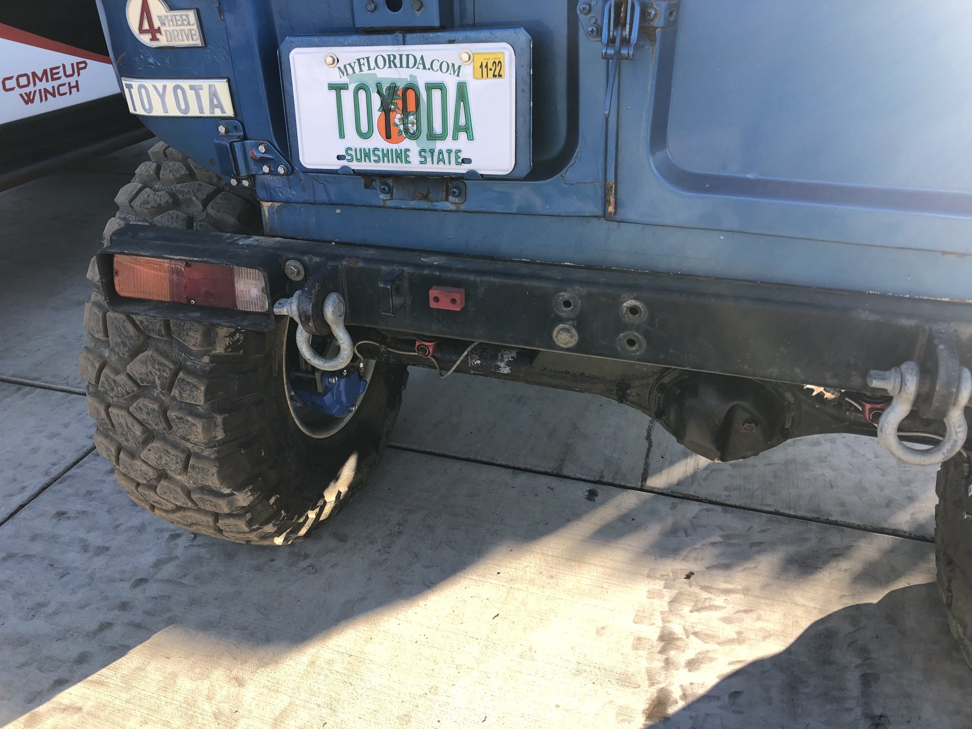

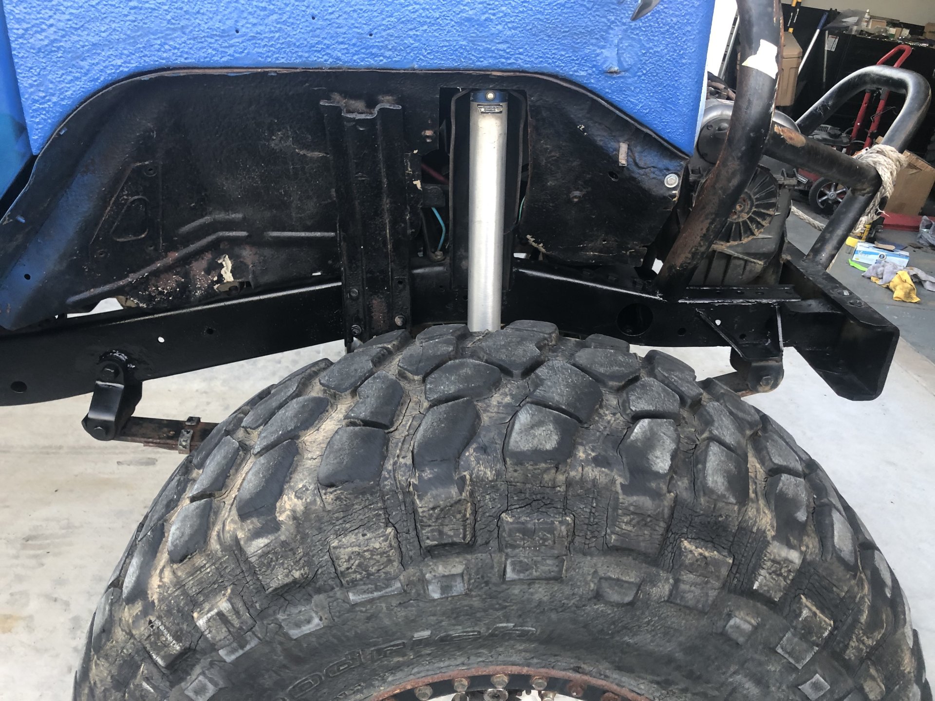

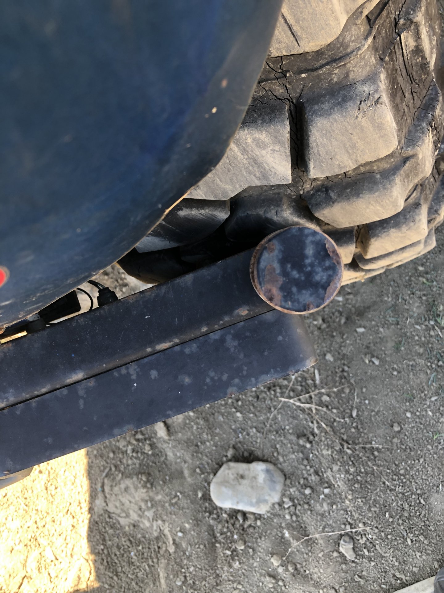

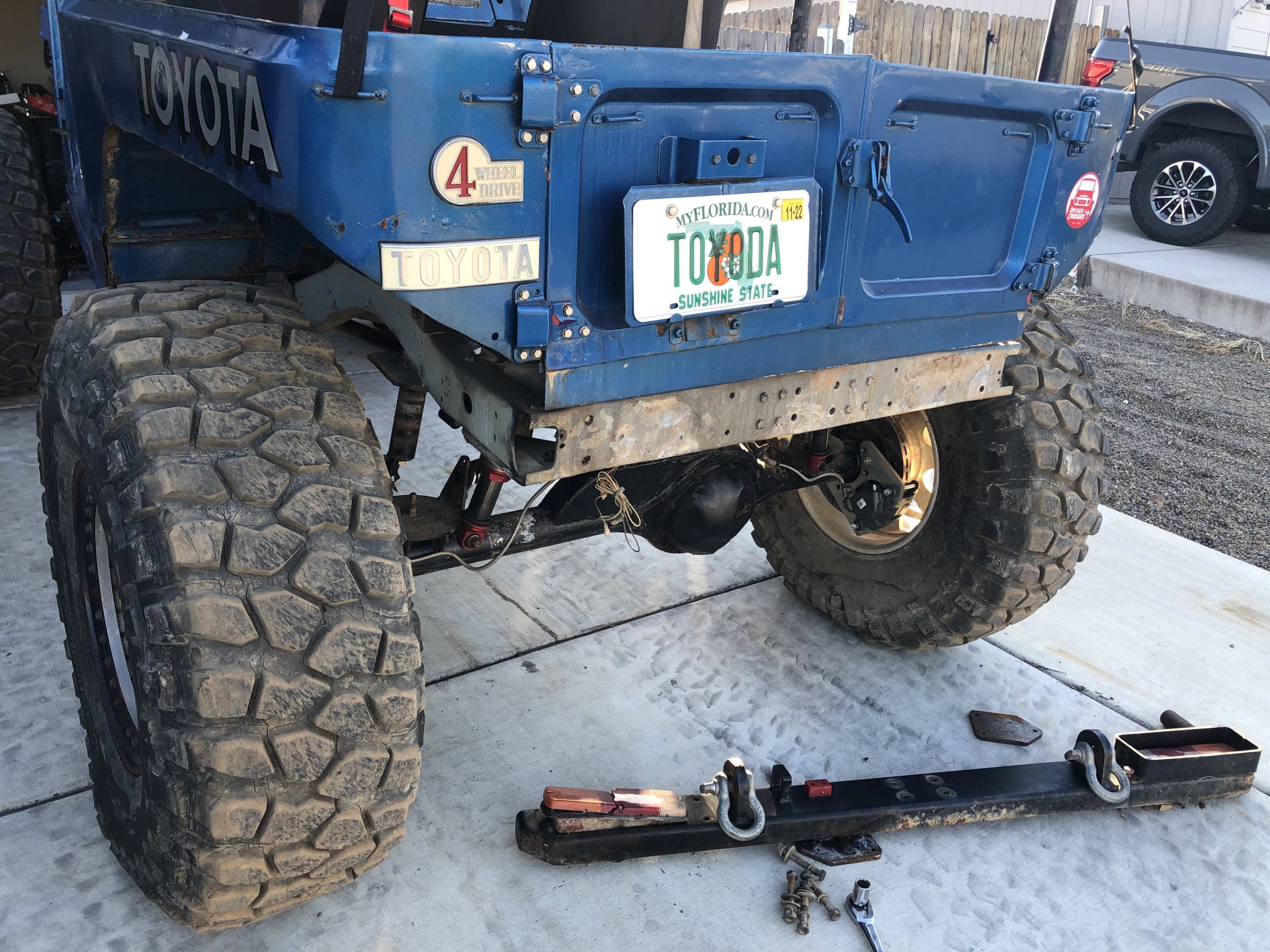

Pulled the rear bumper off tonite. When I would flex the rear the tire would get into it so it had to go . It’s a good bumper just not for this application. I will need to make something up .
