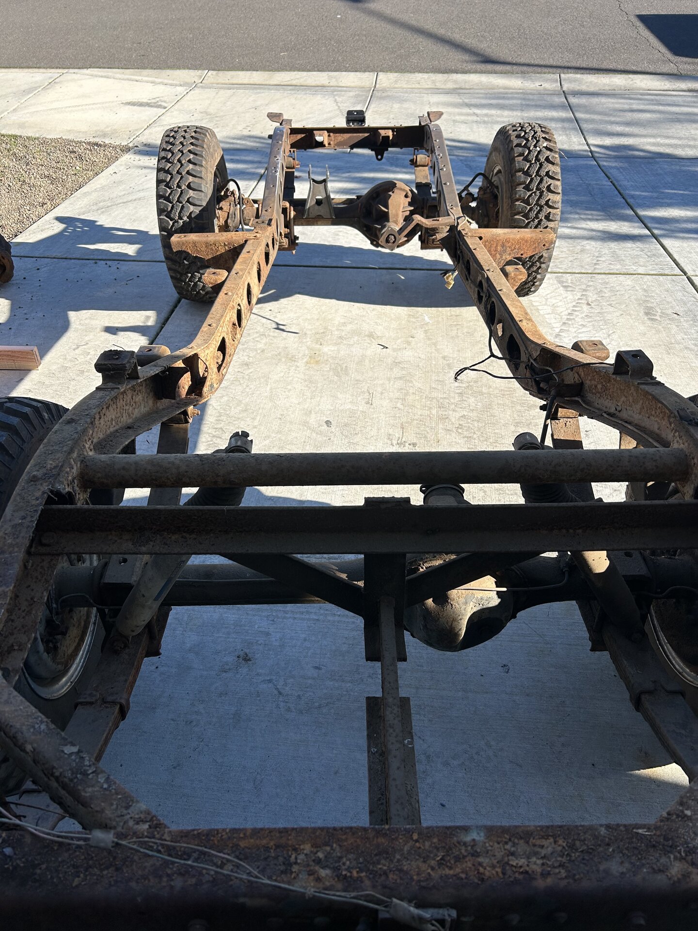

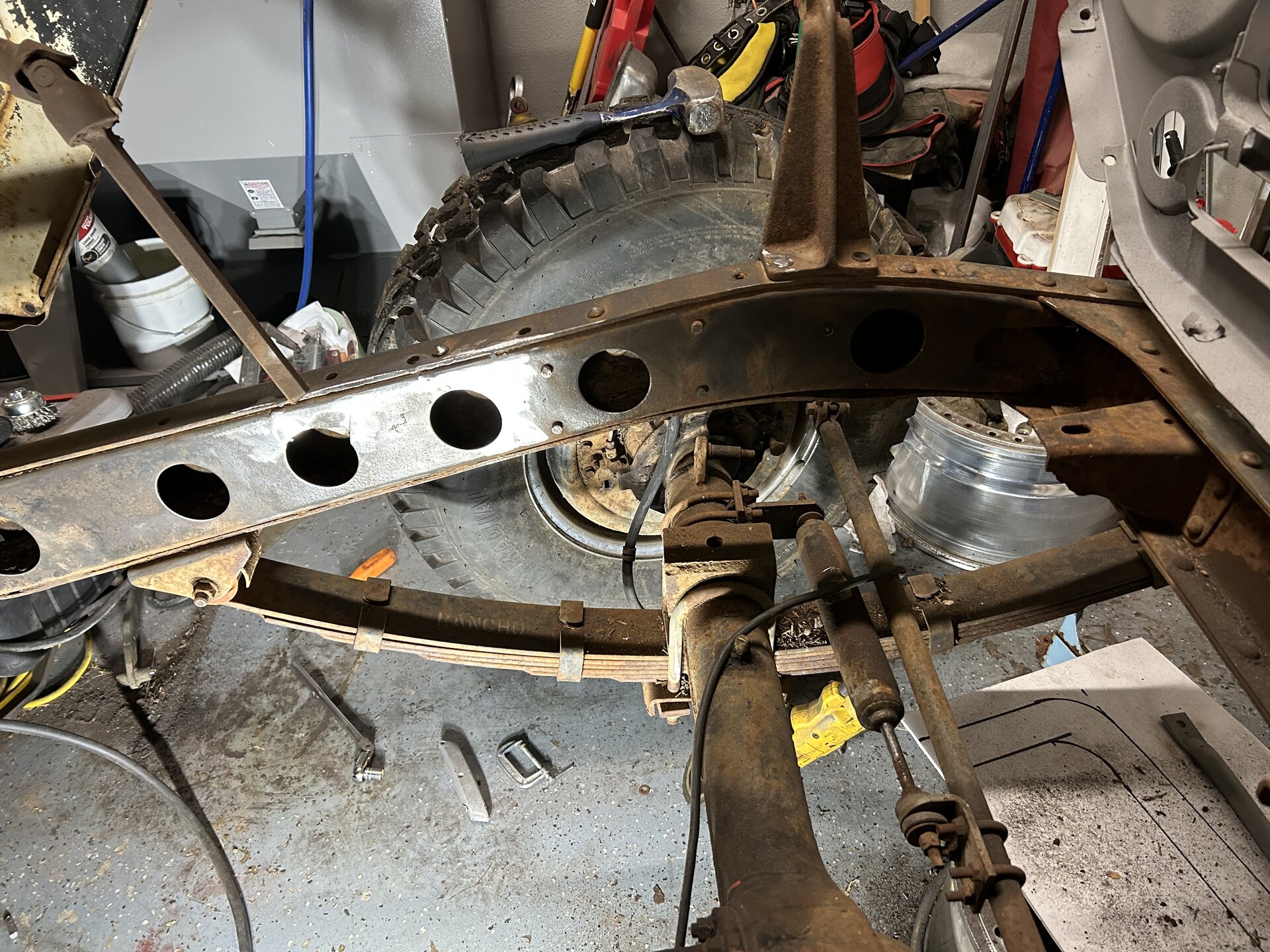

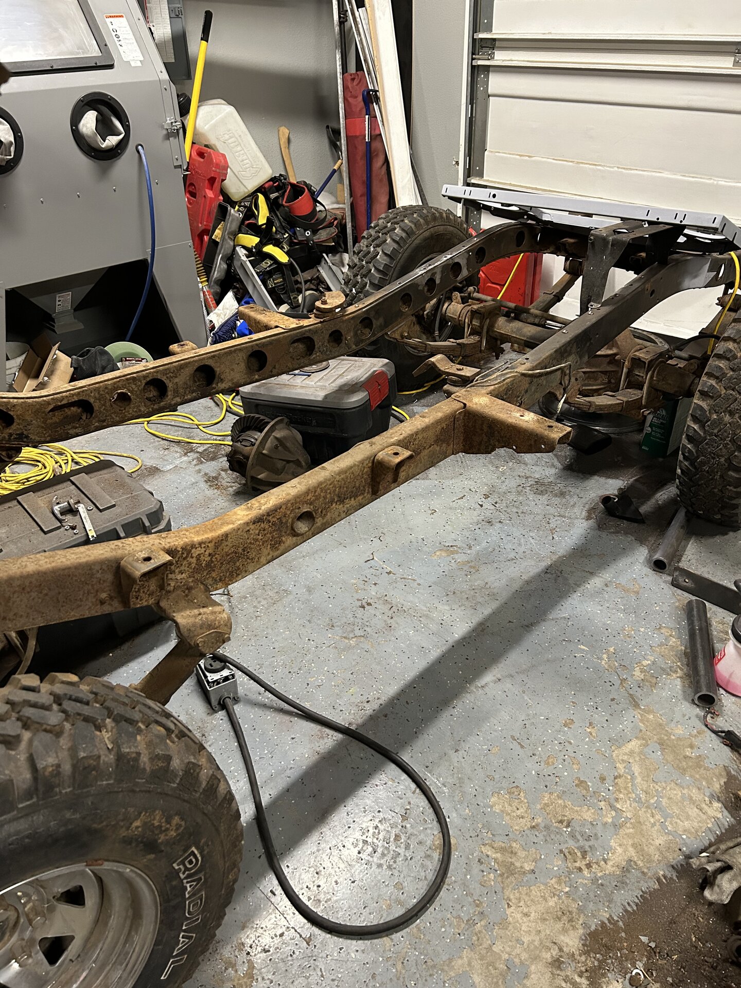

I put it out for some fresh air 😃. Today I will get it cleaned up and the trailer hitch cut out I ground the torque tubes flush and will get some disks cut to fill in Any holes not being used will get welded and ground smooth
