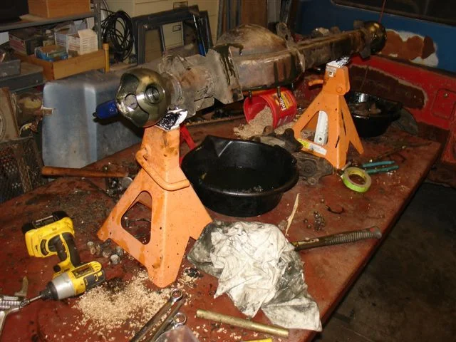

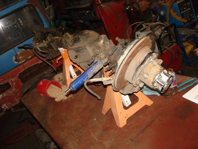

Ok, so here we go. Got the axle torn down from the Mini truck this morning. No big suprises. But some questions for the uninformed.....

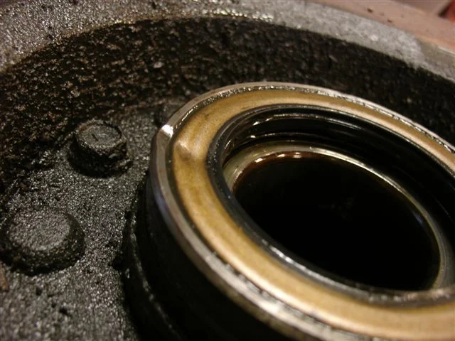

First, it looks like the rear seal here got beat on. There is a big dent. Likewise there was a lot of grease on the rotor as you can likely see.

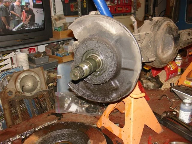

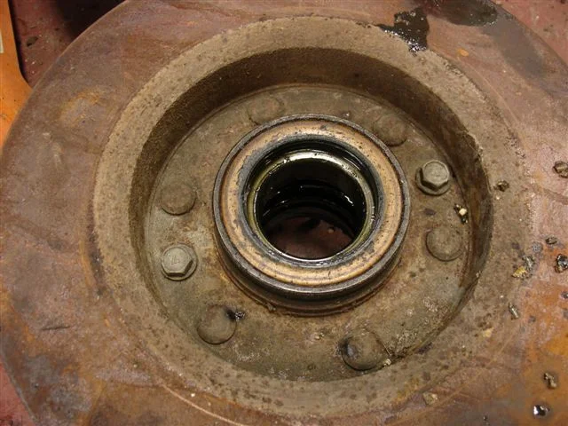

Second pic is the back of the other rotor. DO I have the right replacement rotors, they do not have pressed studs in them??

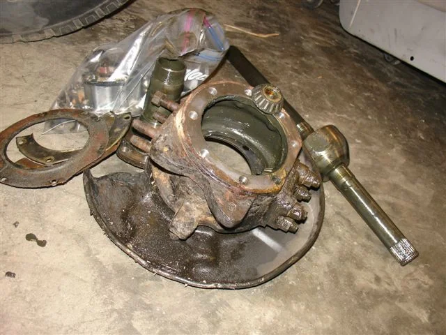

Third pic is the pile of parts.

The PN I gave you is correct for that rotor. that's why I asked for a picture of the front of the rotor itself earlier. and yes they do have pressed studs in them. the wheel studs press all the way thru. there is another type of rotor that mounts with 6 bolts and the studs are in the other part of the wheel bearing assembly.
Start getting that stuff cleaned up. Did you figure out arms yet or what to do on that?
The bent seal will be replaced when we rebuild. keep those wheelbearings with whatever side. They rarely go bad unless totally bashed. I have a set if we find them bad.
If you have a press. you can remove the old rotors and toss em. make sure you use an old wheel lug nut to save the wheel mounting stud. you can clean the assembly etc then press on the new rotor as well. If no press wait till your at my house and we'll use mine.
Zip tie the shims to where they were as well. it helps with reference.
Good start.. Did you take a day off yet? Workbench is moved into place for your build. Taking a break from my projects for a week till we get your axle done.. Plus gobbler opened today. Funny, they all must have a calender, the flocks I've been watching for weeks were not there this morning.
btw, that last pile is exactly what parts you are keeping. :) Makes it get much smaller doesn't it.
Toss the knucle bearings in the trash. You'll need at least 2 tubs of grease if using the smaller ones. I prefer grabbing a bigger tub and bring some good ziplocks to pack bearings.
