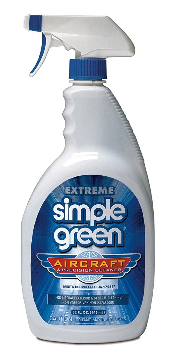

Green Simple green etches aluminium. Use Simple Green Extreme Aircraft & Precision Cleaner.
