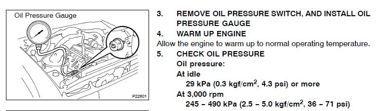

This is from the '96 FSM for the 1FZ engine

Even the FSM suggests Toyota isn't too worried about Oil Pressure either, given the rather generous range of acceptable pressures.

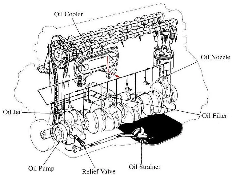

I've seen mine idle as low as 7 psi at idle, but typically is 12-15 psi (hot). That is using a digital gauge and good quality sensor. My engine (all original except for head gasket) has 330K miles on it. Oil pressure will vary with temperature and viscosity. Pressure and 'volume' are somewhat inter-related, but 'pressure' is easier to 'gauge' and understand by the consumer. Good/Sufficient Oil Pressure speaks to a free and constant flow of oil through the system BUT also to 'clearances' (I.E. Crank and Rod Bearings).
The general rule of thumb for 'sufficient' oil pressure (not espoused by Toyota, but for most engines in general) is 10 psi of pressure per 1,000 rpm.
Using that criteria... the 1FZ-FE at idle (650 rpm) is not far off at 5 psi. Mine is normally double that (at least). But Toyota's engineers (no doubt smarter than me) are satisfied with as little as 4 psi and provided they have also engineered the pump to be relatively high VOLUME, I would take no issue with that. The Oil 'routing' of an engine is also of prime importance along with additional features such as oil squirters.
